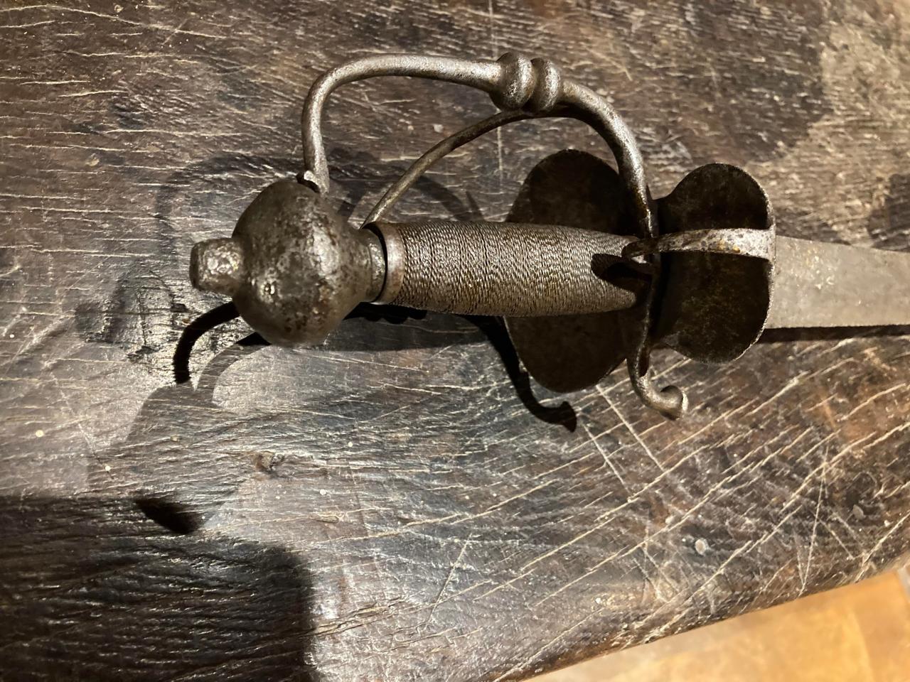

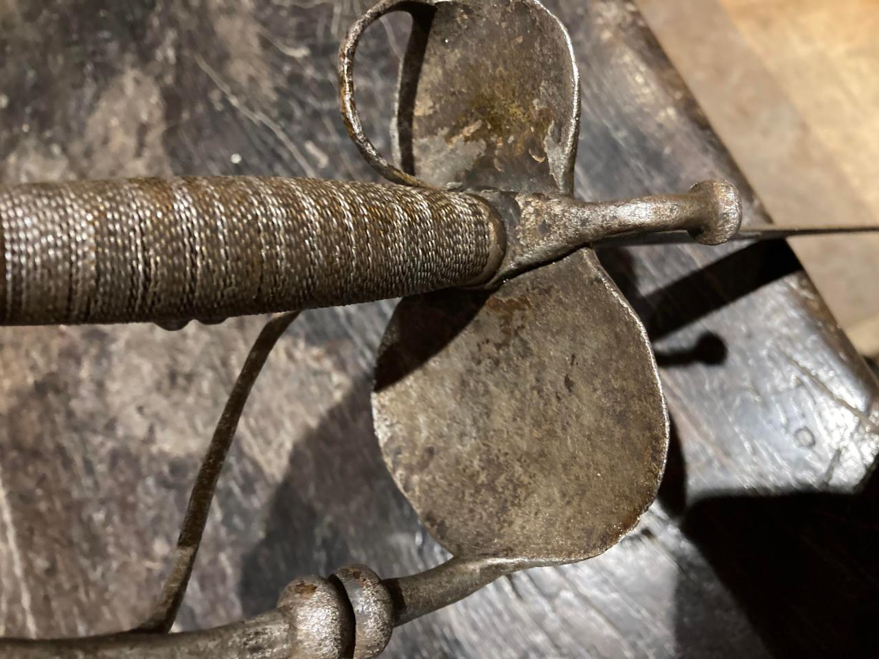

I recently acquired this rapier which i gather is 17th century. There is a head shaped stamp on both sides of the blade which i can not identify.
Blade length is 83cm and total is 97cm.
Any help would be most welcome

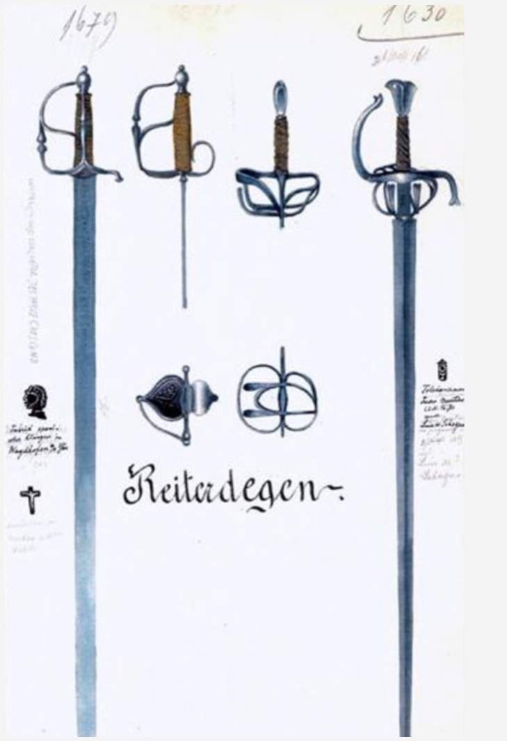

Great looking sword, but technically not a rapier. More of a broad sword with a mortuary or walloon style hilt/guard.

True. These type of swords have many names like Felddegen, Reiterdegen, Walloon sword, etc.
