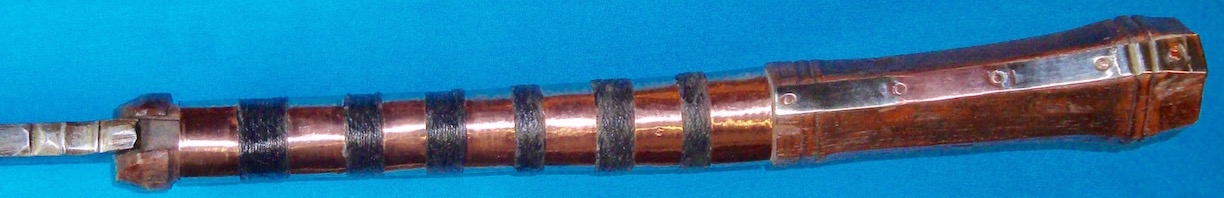

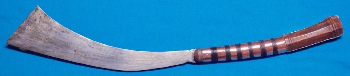

Greetings.
Here is a panabas that I got and restored from Baltimore. The bands are of hemp and copper bands.
What goes around the top and bottom of the exposed narra wooden part of the hilt is a strip made of silver and copper parts (I tested the silver). Copper nails keep this strip of silver and copper sections pinned to the hilt.

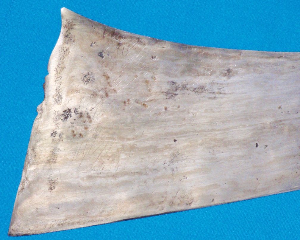

The blade is laminated and the top front of the blade is sculpted in semi-okir.
Recently I have been informed (by some very gracious contacts) that this type is called a bading panabas from the Maranao.
Enjoy!

I remember this one, Battara. Yet another nice restoration job!

Beautiful panabas Jose and great restoration work as always. Could you possibly post a photo of the copper and silver band that shows the construction of the panels better? My congratulation on a wonderful new addition to your collection.

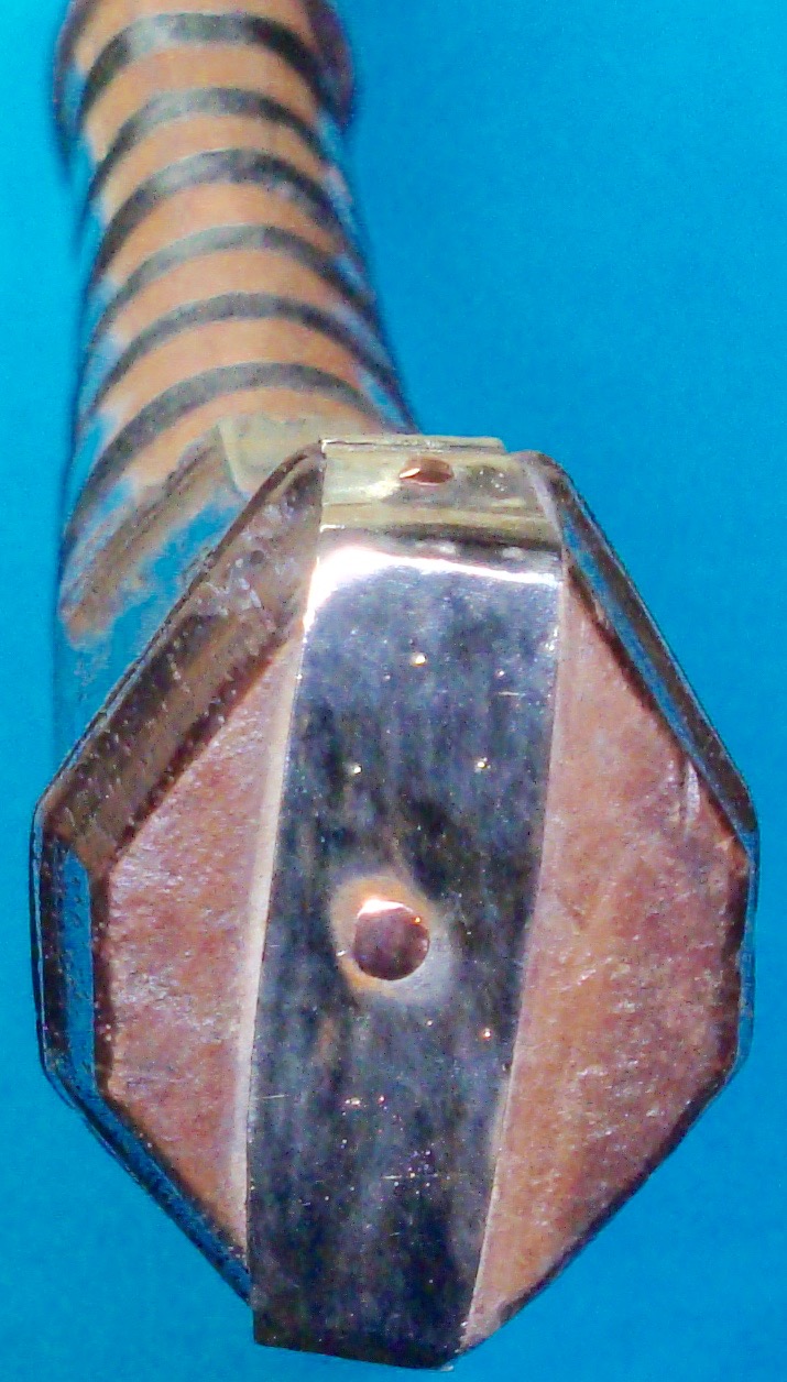

Sure Robert. Will this do or would you like me to post a different picture angle?
It appears to be a tongue and slot construction.

Jose, Thank you for the photo showing how the copper and silver banding was constructed as well as the before photo. Now another question, are the copper bands solid, seamed or overlapped and either folded or nailed? When looking how the wood is a much larger diameter on the end were the tang is inserted into the hilt, it makes me wonder how they would have been put into position if they are solid.

The bands are hard soldered but that section is smaller than the section without bands, so I imagine that the tang is long and the it was pressure fit into the banded section with pitch.
One exception - the first band next to the blade has a copper rivet through that band and the blade, keeping it tight.
I also made a lot of copper nails to replace missing ones.
