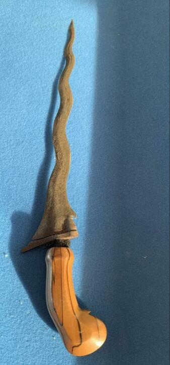

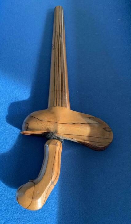

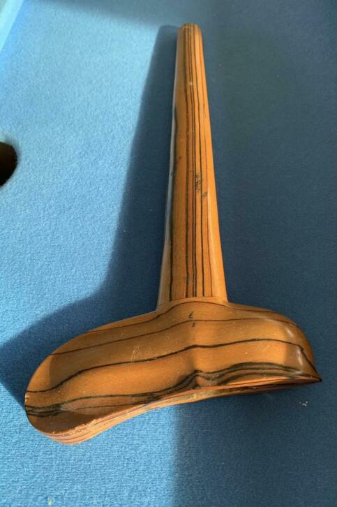

This is in all probability a rookie question and of course, please be gentle. I am here to learn.
I have bought a small kris lately mostly on account of its warangka, gandar and ukiran. They look very slik and smooth.
The blade has yet to reveal its secrets since it is rather rusty and otherwise the pamor which is just faintly showing under the layers caused by years of neglect seems to be one of few ( can’t say how many) wavy parallel lines , length-wise on a 9 luk fairly small kris.
Again this was said to have been brought back by a Dutch soldier after the independence war.
Another thing is that , and I only found out when I received it although I did have some idea that it may be so from the not so detailed pictures that were provided from the seller. this is my first kris (although I knew that they existed) where the hilt is secured in place by human hair.
My question is whether the pattern of the wood has equal symbolic significance and can be “ read” in this light ( pamor pattern) accordingly?
The pattern resembles what , if it was a blade may be “ Gajah Gelaar”.
I have added a mendak ( not shown these are the pics the seller put to me) and will have the blade cleaned and etched at a later time.

Seems a good question to me Milandro.
I think i would hesitate to say that such patterns in the wood are on a "equal" footing with pamor patterns in terms of significance and importance. The blade is always central to any keris regarding such things. But certain wood patterns are indeed highly prized and do hold a certain protective status.

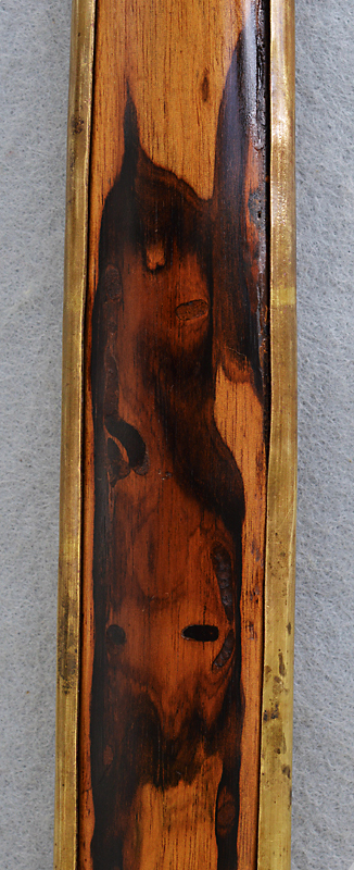

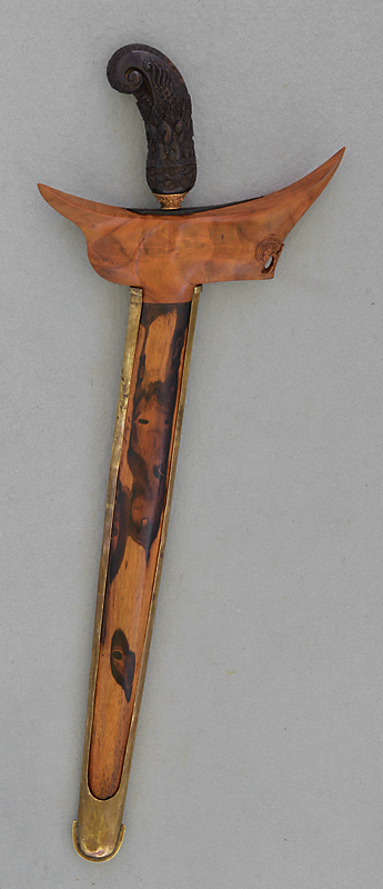

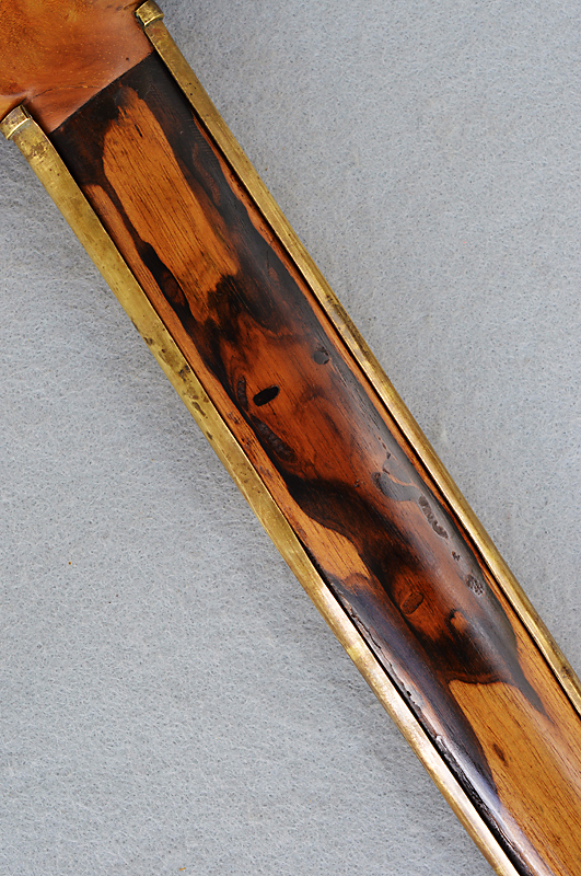

Here is an example from my collection that displays what is known as "Dwi Roh" motif on the gandar of the sheath. This means "Two Spirit" and refers to the two ghostly faces that can be interpreted in the timoho wood of the gandar. This is a rare motif that is considered to be a protective device. In this case this motif was considered important enough to preserve and was fitted to a newer top sheath (gambar) of kayu jati gembol (burl teak).
I am not sure how the vertical Adeg lines of your gandar should be interpreted, but probably not in the same way as when we see such a pattern as pamor in a keris. We tend to see the horizontal lines that appear on your gambar more often. But it is probably fair to assume that they are deemed as protect devices in some way or another.

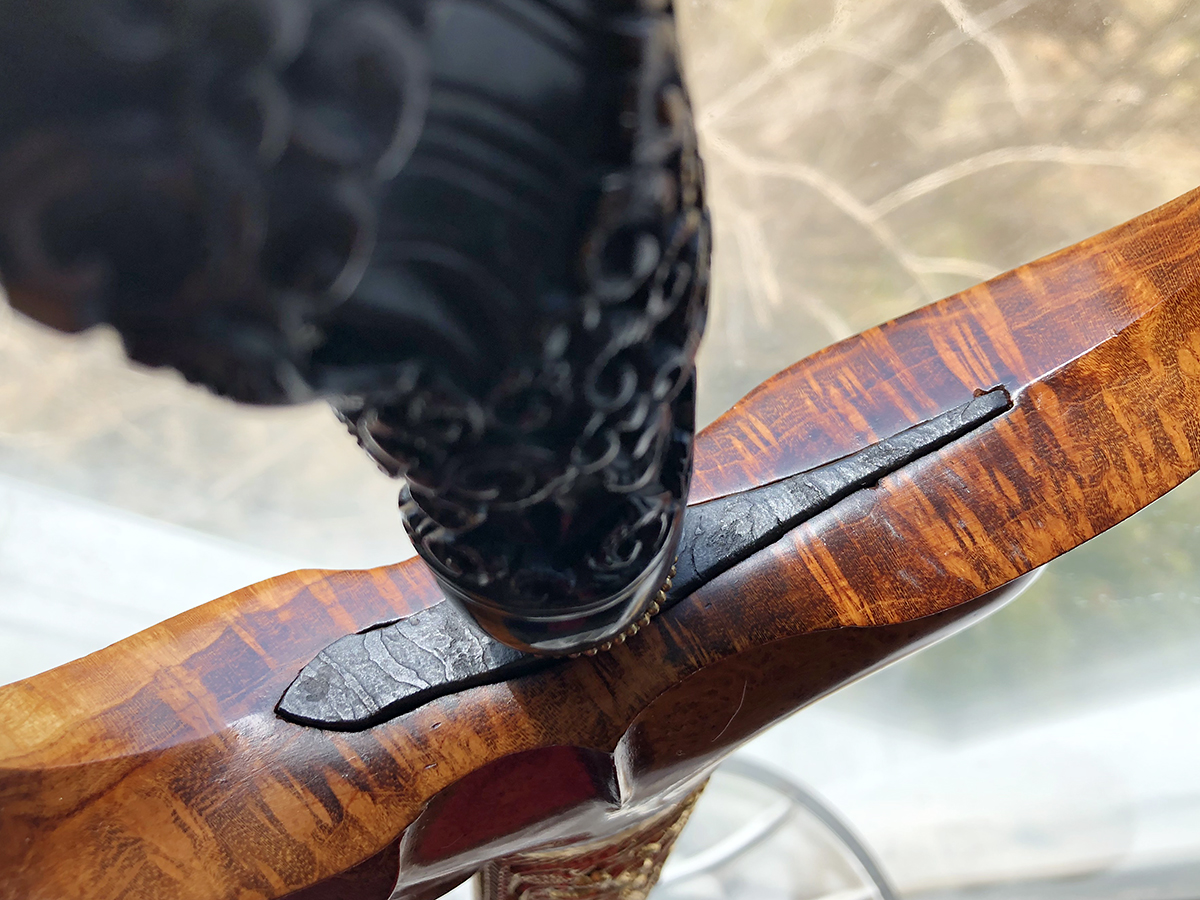

I will add that sometimes the choice of specific patterns in choice woods might be done simply for decorative purposes. Here is another example from my collection of wood grain that seems to be positioned to match the pamor pattern on the bottom of the gonjo. I don't believe this was done with any esoteric intention in mind, but rather to create a more complex ensemble feel.
It will be interesting to see what pamor pattern hides underneath the rust in your blade. If it turns out to be an adeg pamor there might be some connection to why the vertical lined wood was chosen for your gandar. Though more often than not i believe that people were more inclined not to want to reveal what pamor lies within their sheath, so maybe showing it publicly on the surface of the sheath would not be a popular idea.
