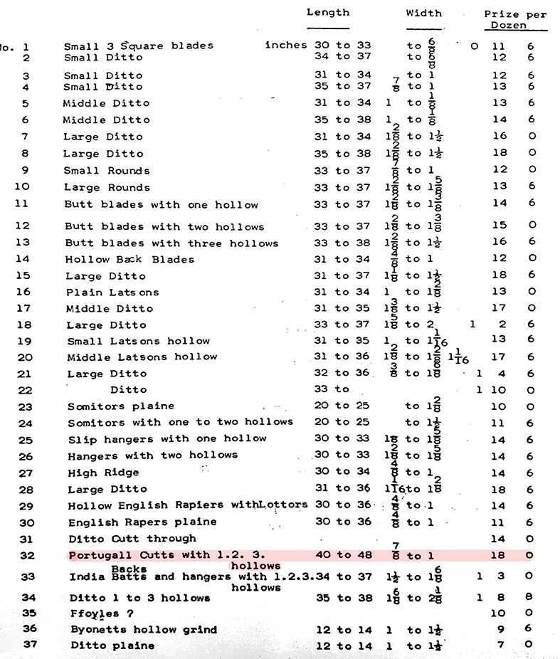

Attached, is a transcribed page from the 1703 contract that the German swordmakers in Shotley Bridge signed for the Company: it lists all the possible blades they must be prepared to supply and, in particular, 'at what cost'.
The names and details require much modern interpretation, and anyone so-inclined is encouraged to oblige... thank-you. 'Latsons' ? English Rapiers with 'Lottors' ?
However, down at the bottom of the list, and highlighted, are the specifications for what I must assume are rapier blades, as the name Cutts is also a mystery to me.
More to the point (oops!) are the dimensions: 40 to 48 inches!
I have read about excessive fashion peccadilloes producing in-feasibly long rapier blades and, in fact, royal pronouncements as to acceptable dimensions; can anyone expound on this issue?
All in all, I thought this list might appeal to some of you folks out there.

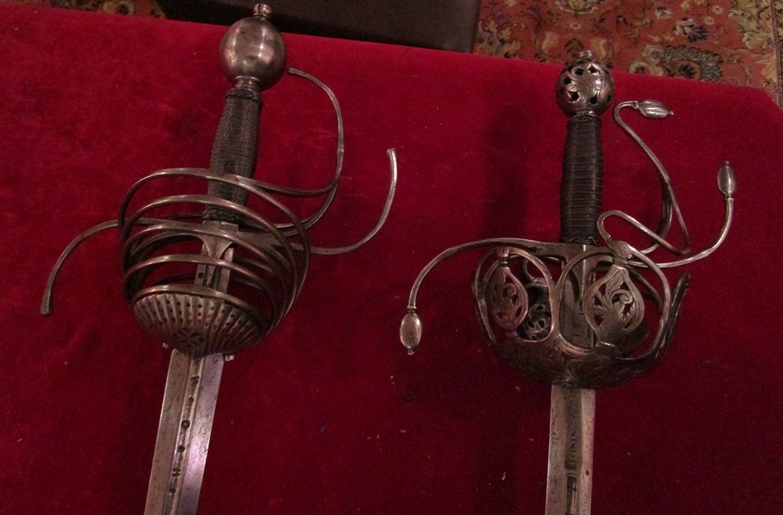

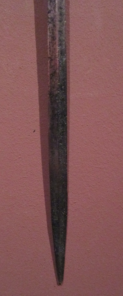

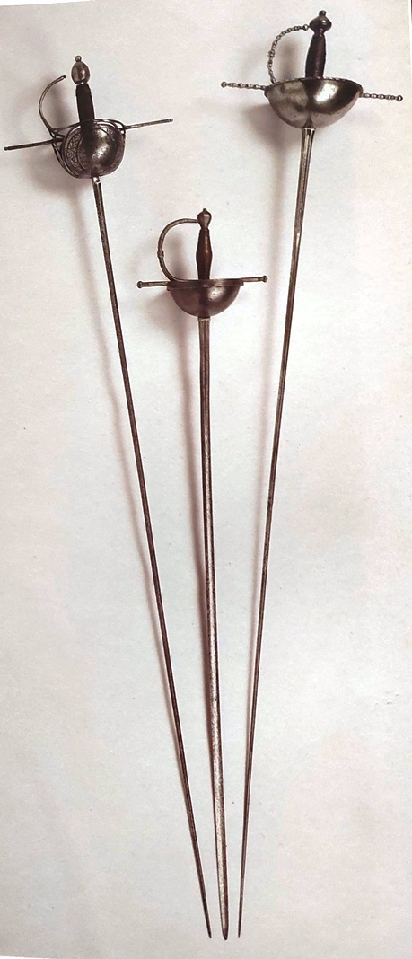

Default In Portugal ...

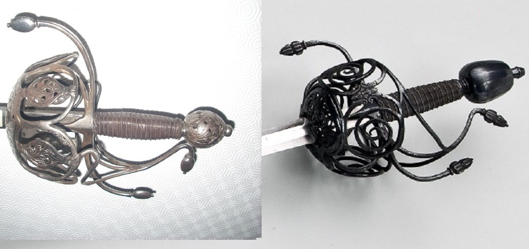

Swords "off mark" (fora de marca) were those with more than 5 spans (palmos) with 43" full length, as per law published by King Dom Joćo III in 1539. It is known that swords with a longer length abounded; some where up to 7 spans (over 60"), a length that became famous in those days.
If you deduct the guard+pommel to this, you get your four foot.
(3 Rapiers courtesy Algredo Nobre; Dom Joćo III law collection Rainer Daehnhardt).

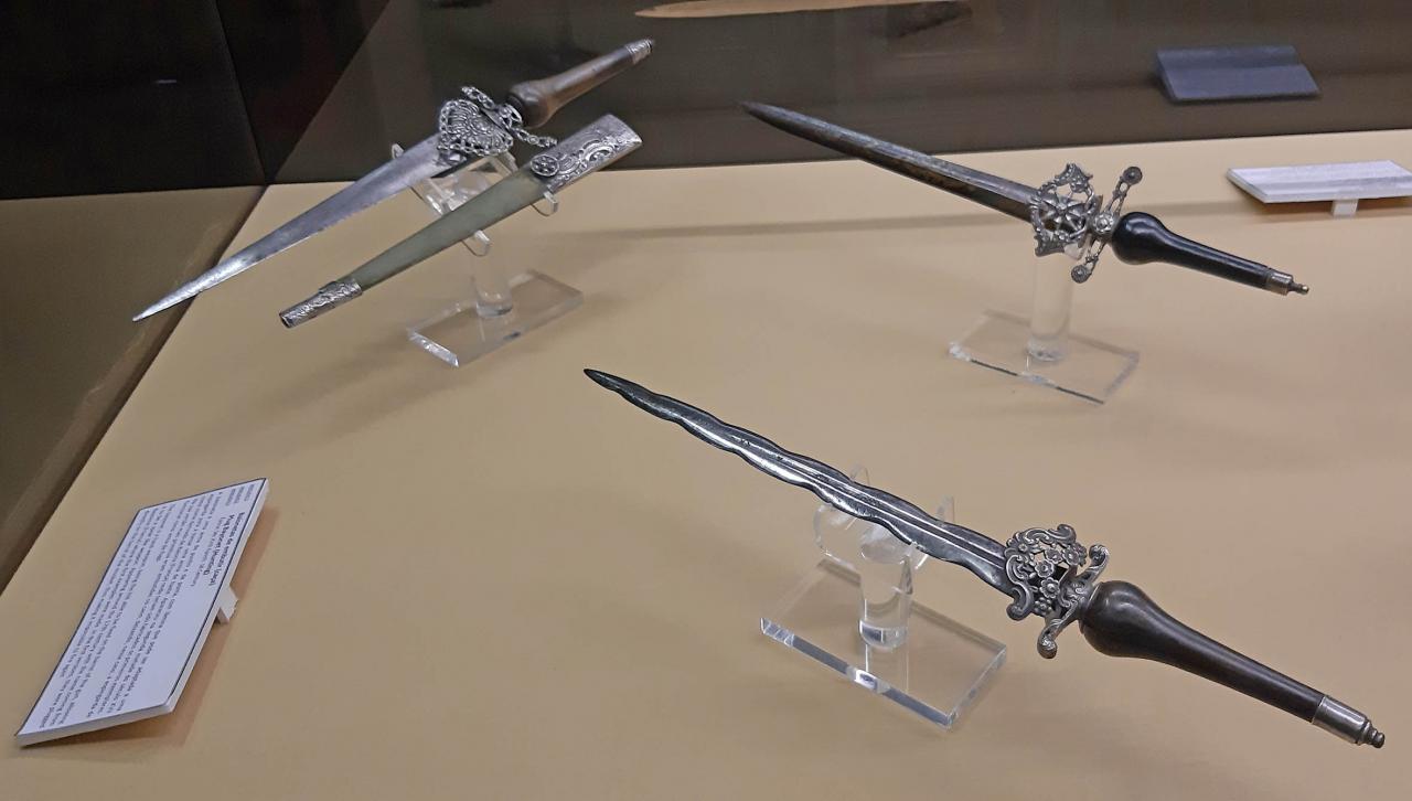

Old 21st November 2021, 03:55 PM   #4
Default Not talking forgers ...
Precisely ... the reach is the issue. The laws legislate on how far you can reach (your foe) with a whole sword and not how long is the blade. Blades may be short and hilts may be long; it is the whole thing that counts for the legislator.
Let me show ou a 'growing' rapier, one in that when in its 'normal' version does not challenge the law but, when you stretch it, it extends up to a seven span sword.
FYI, even Kings (secretly) had them, as you may read in the (left side) caption

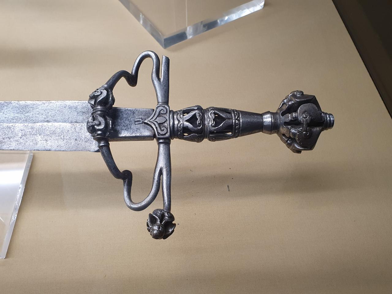

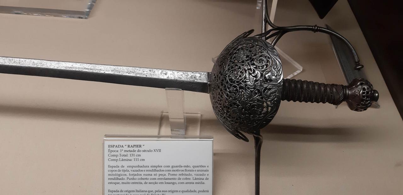

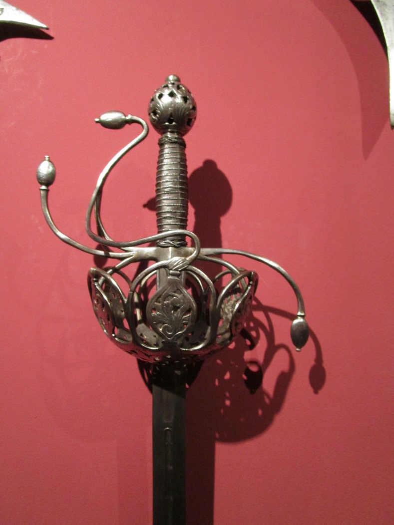

Old 23rd November 2021, 07:42 PM   #7
Triarii
Join Date: Oct 2021
Location: Bristol
Posts: 167

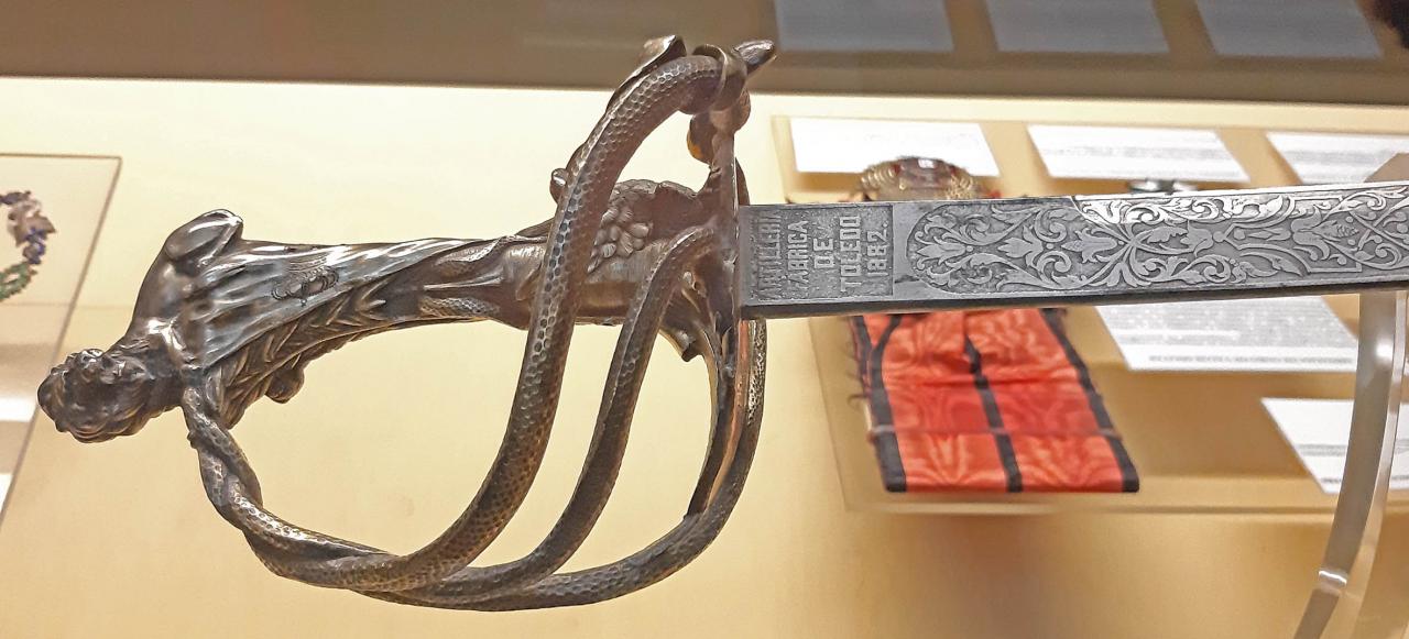

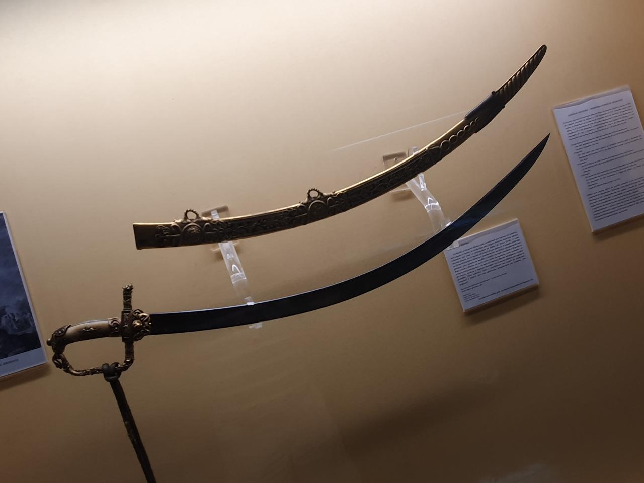

Originally Posted by urbanspaceman View Post
Thank-you Fernandez: fascinating.
I was in the armoury down on the riverside in Lisbon a couple of years back (3 actually, now I think about it) and was not overwhelmed by the number of swords on display. Some interesting items definitely but I expected far, far more. Did I visit the wrong place?

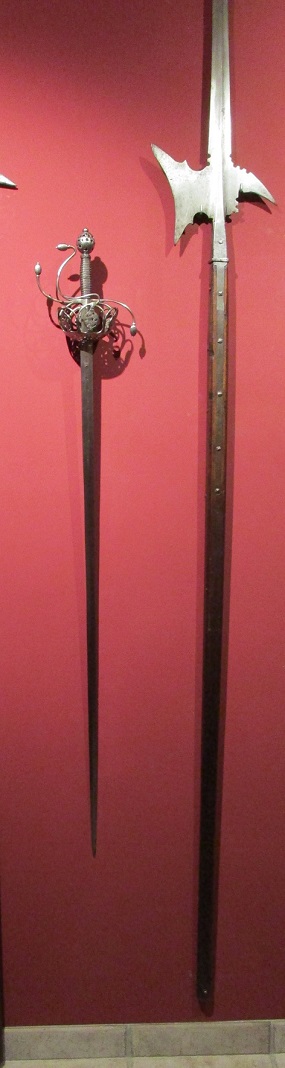

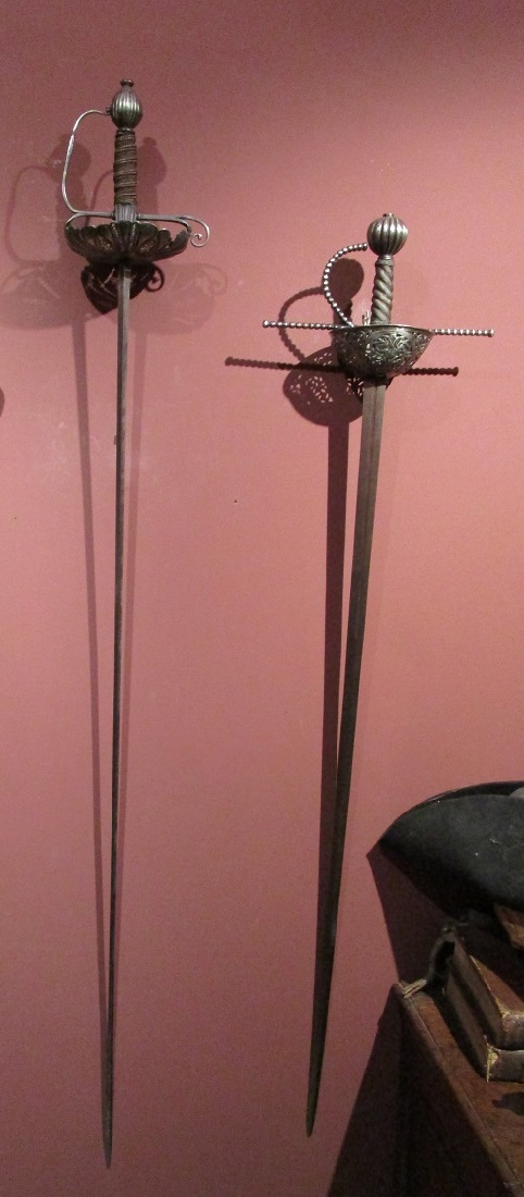

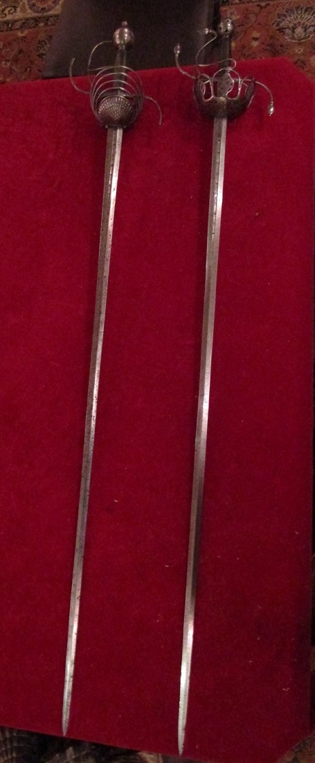

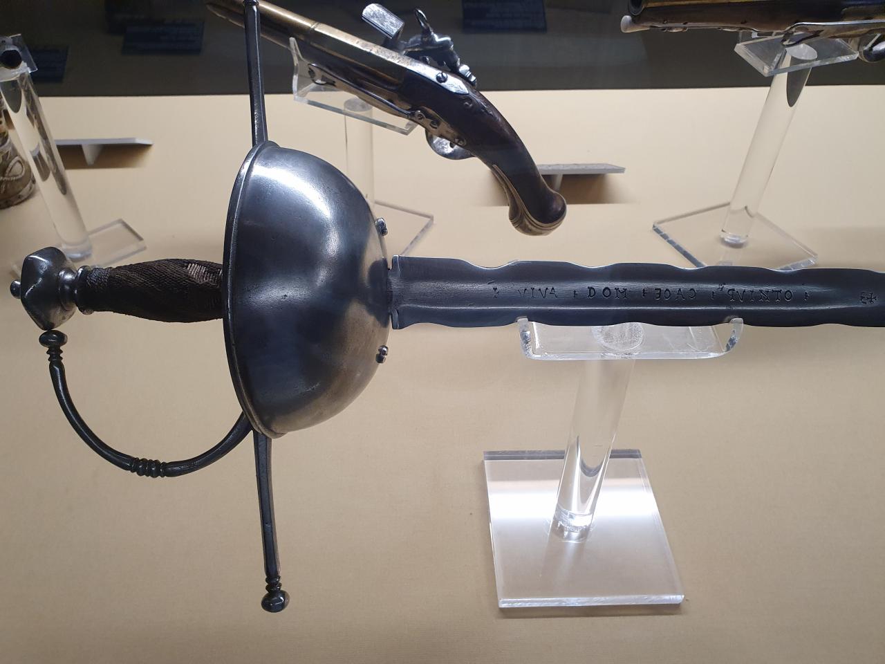

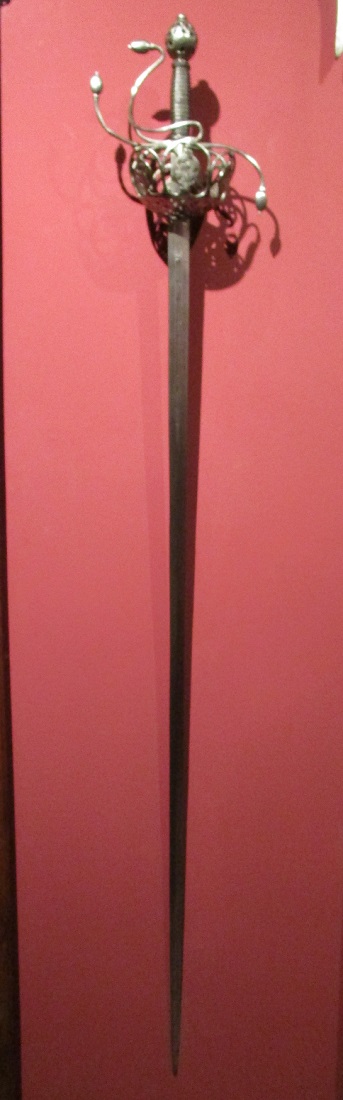

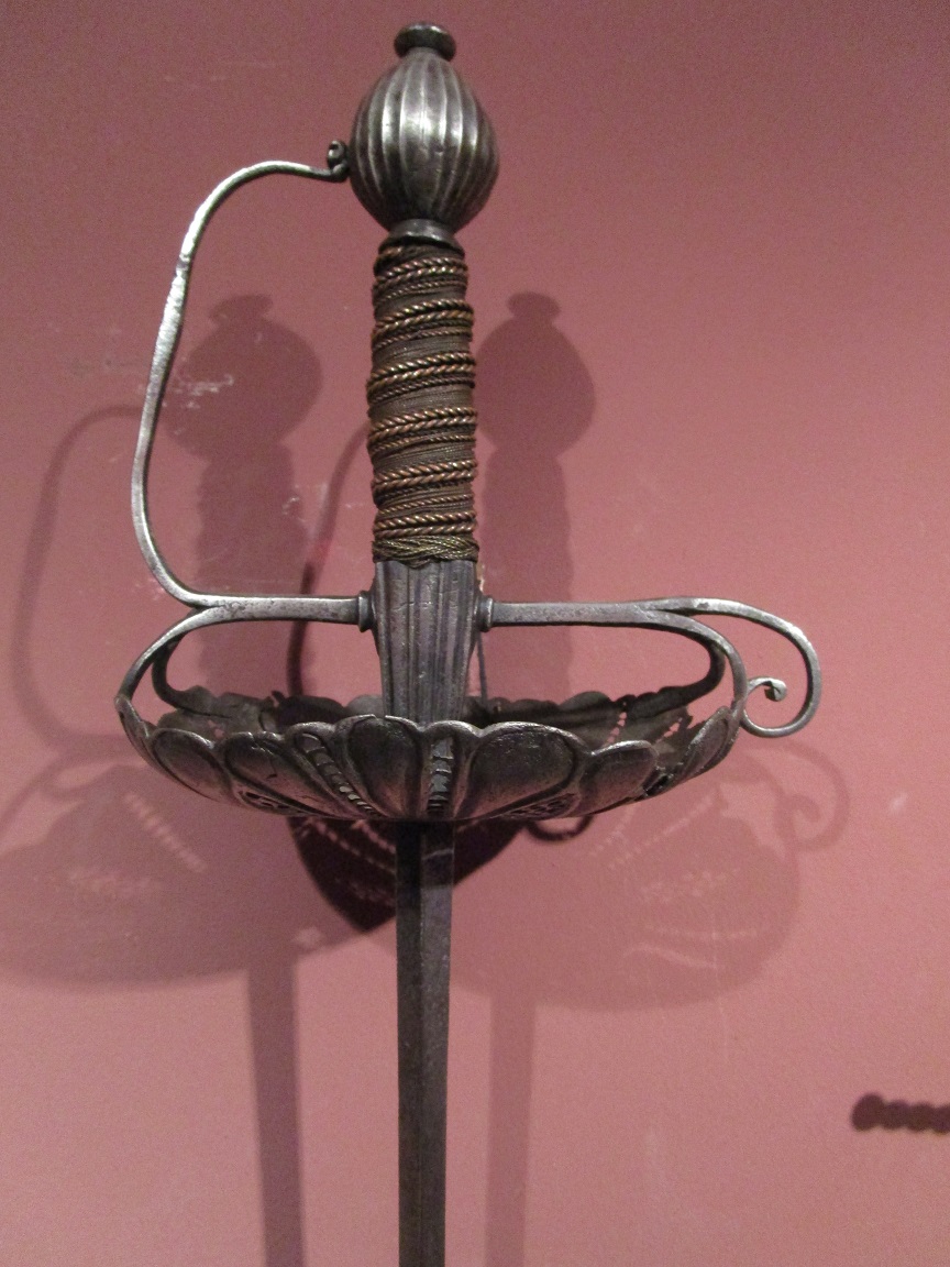

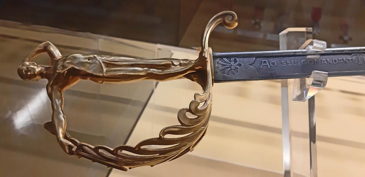

The Military Museum down past the cruise ships berths had a reasonable number of swords. Went there in October this year. A few examples attached.
... English Rapiers with 'Lottors' ? ...
Cryptic terms indeed; besides some mispellings also being visible in the page.
May i take a shot at this one; "English Rapiers with Letters" (inscriptions) ? .
