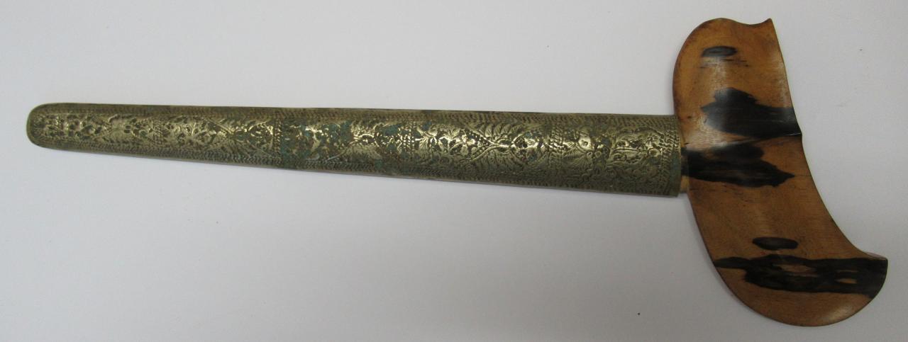

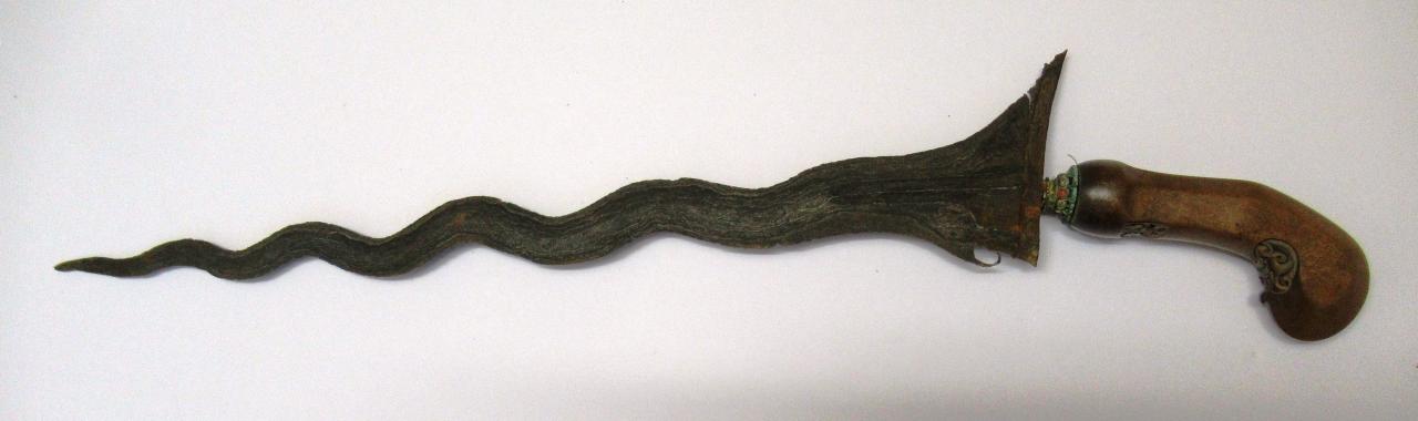

My father lived in Surakarta, Java, in the 1970s. He brought back this kris (along with two others). There was a written description of the kris: The type/shape is named eleven curves. Made during the reign of King Sultan Agung (1615-1645) in the kingdom of Mataram.
My father added: Blade made in last part of Mataram time. Sheath made at a later time, as, probably, also was the wooden parts.
My question is: Is it possible that the blade of this kris is really that old?

Anything is possible, but this is not a keris made in the time of Sultan Agung.
It is keris that has been made in a generic Mataram style, but not in Central Jawa, I believe close examination would indicate that it is East Javanese, probably Madura, I would not give it as 17th century, more likely pre-1850.
The kembang kacang & gandhik are typical of East Jawa/Madura, there is no odo-odo (central ridge), the sogokan are straight and in a waved blade there should be a small degree of curve, such as we would see in the beak of stork (specifically a burung bangau).
Not a bad old keris, but not Mataram Sultan Agung.
The difference between one & the other can be quantified as a very large variation in value.
The dress appears to be quite nice and is well worth restoration.
