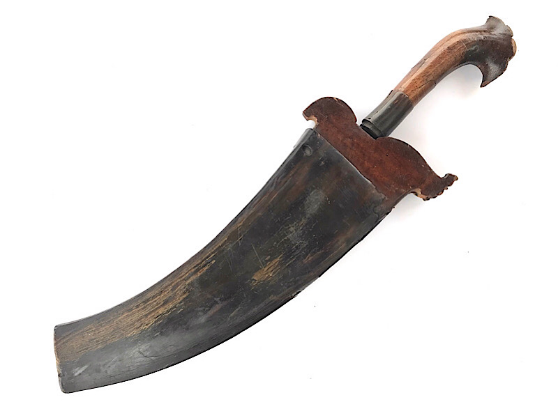

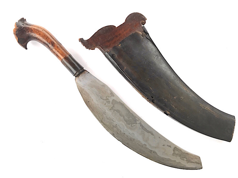

A sword that has an uncommon blade form. I don’t know what it’s called. It resembles a Barung in a few ways (handle, pommel, scabbard). The ferrule is horn. The tip could have broken off and re-shaped. If I were to hypothesize on its age…mid 19th to early 20th century. Blade length ~13 inches.
Thoughts?

Some time ago I posted a barong with a similarly modified tip; it was the only one that I had seen prior to yours. One is an oddity, two or more is interesting.

There was a Spanish law at one point that prohibited blades with points, those that had them, had their points snapped off to make them legal. Didn't do the Spanish any good.
Not sure when that was, in the 19c, but this, like others, may have been among the victims.

Beautiful sword Albert! Could it be Yakan? When it has a tip it doesn't have a barong blade form, so I guess it's the original blade shape.

That's a nice piece and I agree with Detlef that it isn't a modified barung blade. If just clipped under imposed law (much of Sulu never was under real colonial control during most of the Spanish period), no major re-profiling would be likely.

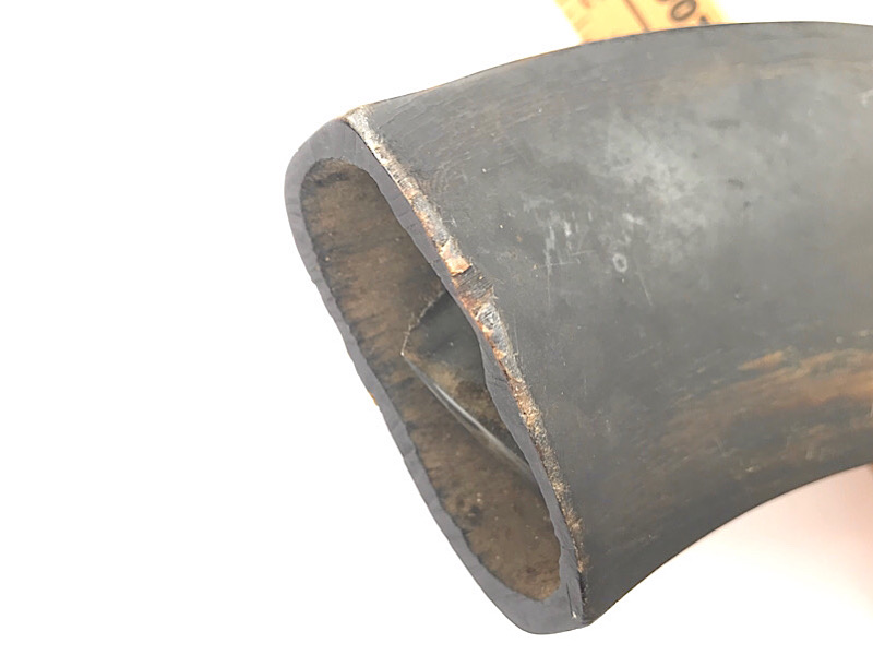

Moreover, the blade length fits almost perfectly in the scabbard as is and any hollowed-out endpieces/chapes are extremely rare. If any serious extension to allow for a pointed blade would have been present earlier, I'd expect the same sturdy mode of attachment with pins as seen with the crosspiece (no remnant holes present near the foot though).
Stylistically, the crosspiece seems to vibe well with Tausug or northern Borneo (not mutually exclusive, anyway). A horn ferrule seems rare with Tausug pieces while quite common with Borneo origins. Thus, I'd lean towards Sulu-influenced coastal areas on northern Borneo. An established US colonial context may hint at a Philippine origin though...

Albert, could you also post a pic of the "face" of the pommel, please?

Moreover, the blade length fits almost perfectly in the scabbard as is and any hollowed-out endpieces/chapes are extremely rare. ...

The horn part, of the fairly decent scabbard, tip end looks like it was sawn off (somewhat crudely) to match the blade, so any matching hollow made for the original unclipped blade tip would have been lost. scabbards were also frequently replaced over the life of a knife/sword and a new one may have been made for it that fitted the new tip.Speculation on ours parts is just that, speculation.
