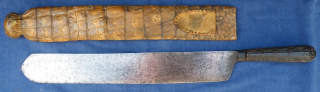

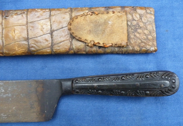

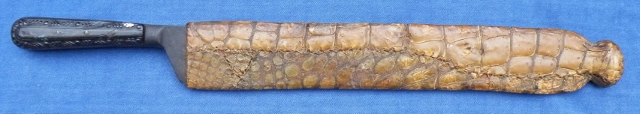

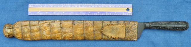

I am posting this recently acquired weapon in this section, as the blade is of European origin. I believe however the knife/short sword was used by tribal peoples in the Cameroon Grasslands area of Western Africa.
After posting in the Ethnographic section of the forum, suggestions are regarding the blade ... that it is/was a very large cake knife, with the hilt scales possibly made from "gutta-percha". The knife on its own is 50cm long and the point has been rounded off I think. I can see no markings to the blade. The maximum blade spine width close to the hilt is approx. 4mm and the blade is only slightly flexible.
Can anyone provide more information on the knife blade and its origin ?
Thanks in advance.

Hello Colin. Just wanted to say what a cool piece this is! Very strange that the knife wouldn't be maker-marked, as most 19th c. cutlery and such usually was...unless this was truly made for export to the continent?? Some chap had great ingenuity to come up with this 'chopper', I suppose? Is the skin crocodile? Savannah monitor? Neat piece!!

Thanks Mark, glad you like it. As you say, strange there is no maker's mark to the blade, unless after removing the rust something will be revealed.. Given the size of the reptile scales, I am reasonably sure the skin is from the belly of a crocodile.
Presumably, the knife was a trade item that found its way into the interior of the African continent. Coastal West Africa of course had continued contact with Europeans and their manufactured goods early in African history.

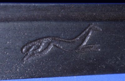

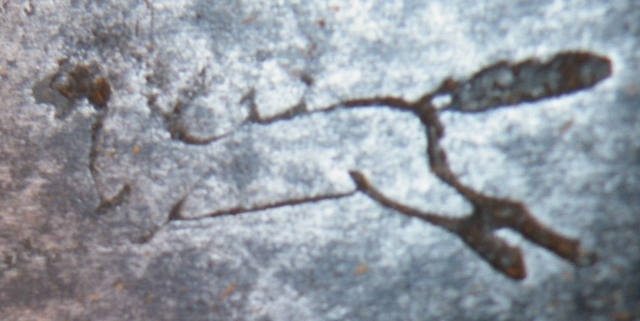

Finally got round to cleaning the blade on this piece and it has uncovered the remains of a mark to the blade... looks like a horse ? running wolf ? Does it ring a bell with anyone ?

This is most interesting! and I hope the solution might be found in discussion here before concerns over the subject matter defrays same.
It would seem that the assessment of a cake knife or similar domestic cutlery would be right, and that it has European origin ending up repurposed in African context.
While the 'running wolf' is of course well known on German blades, in the 17th century German bladesmiths were brought to England first at Hounslow in early years of the century, later opening a factory at Shotley Bridge in northern England.
It has been held that the German smiths in England used the running wolf defiantly toward their former overlords in Solingen. However, it is now believed that the running wolf marks were actually blades from Solingen but mounted with the German makers in England.
At some point, believed in Shotley Bridge, makers were developing their own mark, and eventually the 'bushy tailed fox' became a kind of English version of the German running wolf. However it became well known in Birmingham with Samuel Harvey nearly 50 years after the possible beginnings of it in Shotley.
What I'm getting to is that in one reference (which I must find but do not recall at the moment) there is a notation to the 'RUNNING HORSE' of Shotley Bridge. Whether this was a reference to an assumption of the identity of the 'bushy tail fox' I cannot say.
However, a running horse is mentioned in what I believe was reputable context, and Shotley with all the intrigue and troubles it encountered, like many blade making centers, also produced cutlery through the 18th c.and somewhat into 19th.
I would say that this might be a clue on this, and the English were of course well known in western Africa, in the early 18th century on, with the ports engaged in trade including slaving.....Whydah comes to mind.

I found an entry on in "History of Manufacture of British Swords" by Harvey Withers, where he states that the Shotley Bridge makers '..impressed a running horse mark" in imitation of the running wolf.
The attached image is from a Revolutionary war period infantry sword found online, which is contemporary for the 'bushy tail fox' swords by Samuel Harvey.
It is interesting to see that the horse mark is really not the same, and suggests that at some point Shotley may well have been making cutlery in the 18th c.
At the same time, this marking, which seems similar even if not the same, and may be misinterpreted as a horse rather than BTF.
It does appear that Shotley, actually Oley, was providing blades to Birmingham in the 18th c. about the time of Harvey, but Harvey was known for the BTF (= bushy tail fox) with his initials SH on the body (though some are blank, some have only H).
While makers in Birmingham were producing munitions grade blades, it would seem that Shotley had become more diversified by then, and perhaps these serving knives were among their products.

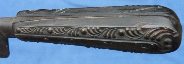

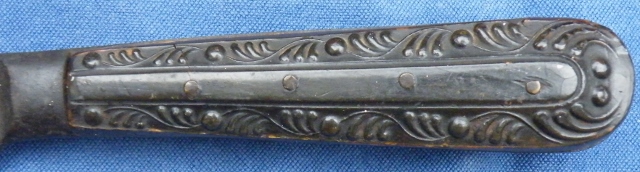

Thanks to Jim for his helpful and informative posts, above. So, its quite likely the mark represents a "Bushy Tail Fox" or "Running Horse", and probably of English manufacture...

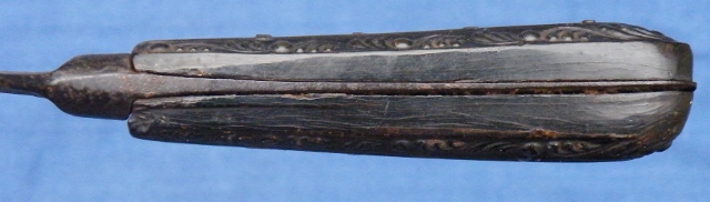

Regarding dating, as the hilt scales are made of gutta-percha, this precludes a date of manufacture prior to the mid 19th century. I should also mention that looking closely at the blade, there seems a fair chance that the profile has been rounded off to form a spatulate end, rather than coming to a point, at some later period ?

With the running animal mark, obviously the most common case for such a mark is the famed running wolf of Passau (later Solingen).
The fame of this mark for quality brought imitation of course, and when German makers were in England the 'bushy tail fox' evolved as sort of an English version.
In looking at the mark on the example here, there seemed to be some resemblance of a 'horse', and over the years of study on the mysterious Shotley Bridge sword making enterprise of the late 17th century, it is believed the bushy tail fox mark evolved.
This later transmitted to Birmingham, where Samuel Harvey used it, but placing his initials SH in it.
There seems to be some apocryphal notion that Shotley Bridge used a 'running horse' mark in imitation of the Passau wolf as placed by one author, but as there is no evidence to this, it seems to be a 'Rorschach' issue.
I checked with Staffan Kinman ("European Makers of Edged Weapons, Their Marks"(2015) and he is not aware of any 'running horse' mark, but noted this seems to be a 'fox'.
As previously noted, in many cases in England, much as in Germany, blade makers and cutlers often also made tableware and serving items.

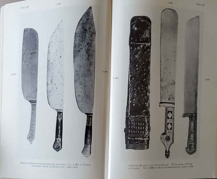

I found some examples of serving knives in "The Wallis Collection" (Mann, 1962) but will note that these are profoundly OLD! These are apparently 15th-16th century vintage, but it would seem the traditional form would have extended much further, given the simplicity of the form and the convention of continuing such styles fashionably for centuries.
As I have mentioned, Shotley Bridge had expanded its 'repertoire' into other cutlery and flatware (tableware) after the demand for sword blades had declined. Nearby Sheffield had also become a key producer of edged wares, and though they focused greatly on silver plate, other items were included.

As noted in previous posts, it is the hilt scales (not the scabbard), that are probably made from gutta-percha. The scabbard is made from crocodile skin.

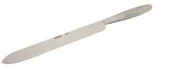

Trying to find an exact match is difficult. Look at antique icing knives and spreaders. Also antique cake decorating knives. Google farrar and tanner wedding knives to see modern examples.

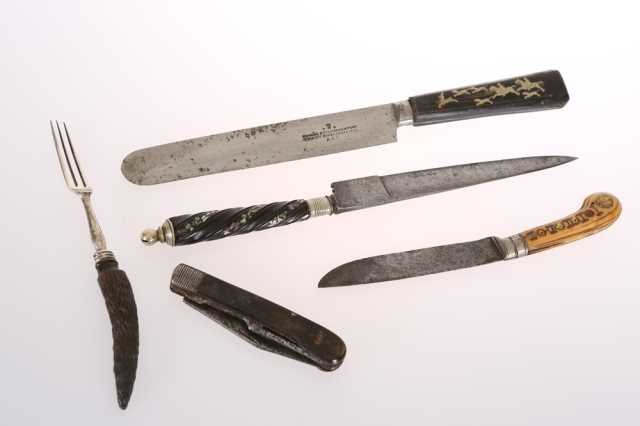

Old 7th June 2021, 07:05 PM   #14
Posts: 6,031
A picture from a long ago auction site. The hunting scene handle is nice.

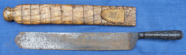

well it definitely is an african sheath made of crocodile skin. but the knife i suspect is in its original form. it may not be a serving knife as im pretty sure that style was well out of favour for other narrower styles. based on those grips its 19th century.. but could it be a vetinarians knife instead, one for disction of larger animals.

Great point, Ausjulius! When i first commented on this piece, I had assumed a more utilitarian use for the blade, but you bring up the point that it could have been a specialized tool (medical dissection, hunting-trouse type, etc). I'm even reminded of bolo-type machetes and specified 'gardening tools', like Japanese nata. Perhaps this was an agricultural tool??? Fascine knife??

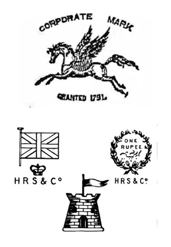

It could be a worn depiction of Pegasus, which was the trademark of Henry Rogers and Sons Ltd, Wolverhampton and Sheffield.
Apparently it was also a mark used by Unwin and Rodgers who made the infamous knife\pistol combination.
Richard
Richard
This might well be right, as there seems to be the remains of "wings" on the back of the horse ? on my blade. The suggestion of a dissection instrument also seems correct, a large autopsy or "organ" instrument possibly. This would go with the funereal black hilt and the raised decoration to the gutta-percha providing a firm grip...

Try looking at this link. There are several similar running fox stamps pictured attributed to Carl Tillmann Sohne KG, Solingen-Remscheid. Hope this helps....https://www.germandaggers.com/Gallery/Makers.php

Thanks very much for adding this compendium of modern markings. It is interesting to see how these long venerated markings have been used in a traditional sense in these firms.
