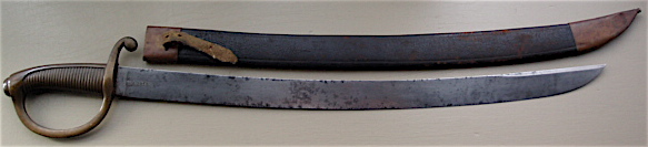

I recently relocated a sword that was one of the very first I ever bought, I believe around 1966 at a swap meet in a drive in theater in California.
Young and very wide eyed, this simple 'cutlass' looking sword, heavy and solid to me just must have been a 'pirate' sword.
As years went on, and my obsession increased, I learned that this was actually a well known type of hanger used in the British army in the artillery in the late 18th c. into the 19th. However, it seems to have been a common munitions grade form that was represented in virtually all European armies and all virtually the same with the characteristic cast brass ribbed hilt with short hanger blades of varying length.
Apparently these 'briquets' were in use with the French in mid 18th century in infantry (the term 'briquet appears to be French meaning 'light' earlier describing 'light saber').They were well known in Napoleons army as the ANIX, ANXI, and ANXIII for model years from 1800+
British suppliers apparently saw these as useful for artillery gunners and began producing copies probably in 1790s. While not necessarily good as a combat weapon, they were handy in a utility sense for chopping wood (emplacement construction etc.) though could of course serve as weapon if overrrun.
The thing with these weapons is that they are so common and alike, unless there are distinct markings, it is difficult to identify them by country.

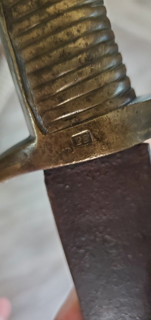

On mine, there were only the initials PS in a cartouche on the hilt.
I tried unsuccessfully to find matching initials in British sword makers etc, but in those days, aside from a few references, there were no clues as to who PS might be.
I assumed many possibilities, including possibly Spanish colonial, but no really convincing solutions. At one point however, I saw some detail on silversmiths and thought, this PS sort of does look like a hallmark. I tried reaching antique dealers handing silver items but most seemed appalled that Paul Storr, one of the most celebrated British precious metals artists, could have produced this 'common' weapon.
This left it 'case closed, unresolved', for decades.
Enter the late Richard Bezdek, with his "Swords and Sword Makers of England and Scotland" (2003) on p. 158........there it was,
PAUL STORR.
Apparently he was not only a goldsmith and silversmith, but a hilt maker and sword cutler, as was indeed often the case in these days as I have learned.
It is noted he apprenticed in 1784-91 under William Rock in London.
In 1792, he entered his first mark: PS !!!
He apparently retained this mark throughout his career, and became famed for his neo classical style in the Regency period. He produced items for King George III, and George IV of England.
It does compellingly appear that this 'lowly' hanger, bought for just a few dollars decades ago in a most unseemly place, has notably historic origins, and while 'just an old artillery hanger' was produced in the workshop of a soon to be famous artisan.
Such is the adventure and joy of being an arms historian, and listening to the stories told by these 'old warriors' as the weapons tell us who they really are.

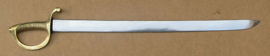

If i may Jim, some notes on the briquet, both on the "generic" thing as also on your example.
Generic as, this having been produced, and reproduced, in massive numbers among many countries, and also to its affordable price in the market, make it a 'must' in collection beginners.
Concerning your example, i wonder whether PAUL STORR decided to implement his personal touch in the hilt design, by omitting its quillon 'button', or was it that this was cut off during this specific example's life.
Also in addition some notes on this sabre history, some repetitive, in the eyes of the Frenchies, in principle the originators of the so famous briquet ... with the duly translation flaws.
" The grenadier sabers of the old regime were considered more and more cumbersome, it is to remedy this that in 1765 a new model of regulatory saber was introduced, with a shorter blade, reduced to 59.5 cm, the saber d infantry model 1767.
He was immediately given the nickname of "saber lighter" by the cavalry. The word "lighter" in the 17th century first meant "knife" or "penknife", mainly and also: "a small break in iron". To this origin is added "gear": a small kind of sword, a type of dagger, which has also become in dialects: "shoe nail". Its name therefore takes on a somewhat mocking, even haughty, connotation; or even gently affectionate: her small size and the shape of her guard are indeed reminiscent of the lighters used by soldiers in the field to light fires. Then, in 1806, this designation became official.
From 1767, the saber lighter equipped grenadiers, but also non-commissioned officers, corporals, soldiers of elite troops, drummers and musicians, fourriers, and later the Consular Guard then Imperial. The artillerymen also carry the saber lighter, which they most often use to prune the vegetation when they put their pieces in battery. Although it is mainly used for practical and utilitarian purposes rather than warfare, it is an effective weapon, whose point blows are dangerous and whose size blows can cause serious injuries. However, its mass and its size, in view of its usefulness on the battlefield made its tactical justification questionable, to such an extent that in 1806, the Emperor Napoleon 1st promulgated a decree eliminating the wearing of the lighter (which will never be applied), before going back on his decision in 1811.
The lighter saber was used until 1831 by the infantry, when the new model 18311 sword was adopted.
The saber is still (2018) under the name M / 1854 used by the Danish Royal Guard, which has 544 of these sabers in total. They are all German spoils from Waterloo, and later Danish spoils after the 1848-50 war between Denmark and Germany. The saber is worn by grenadiers and non-commissioned officers guarding the Queen and the royal palaces, notably Amalienborg and Fredensborg".

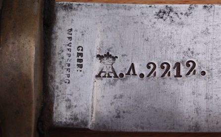

Hi Jim,

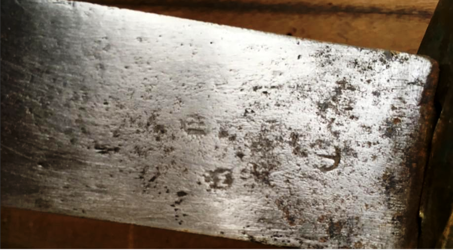

My contribution to your story. A Briquet of mine made by Gebruder Weyersberg and stamped with arsenal marks for Berne, Switzerland. I contacted a museum in Berne and was told that it was an N.C.O.'s sword from C1830. It has a false back edge running for approx 6 inches which you can just make out in the photograph. I haven't actually handled many of these Briquets but I don't remember seeing another with a false back edge.
My Regards,
Norman.

Thank you Norman, excellent entry!! and seeing these still being produced and used in 1830s, especially in Switzerland. It seems that beyond the 'Landsknechts' there is little discussed on the military of this country.

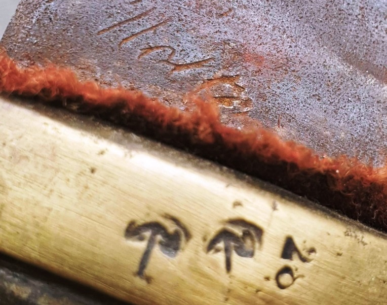

Dear Jim, could you manage for a more accurate picture of the PS mark ?
I have turned the Internet upside down and didn't spot a minimum sign that Paul Storr was other than a magnificent silversmith; who has actually suplied some of his high end works to Portuguese aristrocatic families.
The only connection with his contribution to the arms (sword) area would have been silver hilts; which we manage to imagine in a splendid sketch designed by Thomas Stothard, whose works were put into practice by Storr; although the one depicted here was never brought to life.
So, despite Richard Bezdek book mentioning Paul Storr was a 'hilt maker and sword cutler' (per your words) i request your understanding that, this does not mean that such silver smith wizard would come down to integraly imitate a non British (sort of) sword, in cast brass, just for the fun of it. What for ?
So, do you see a a chance that the PS mark on yor briquet was someone elses's ... or even some low profile brass caster using his initials ...

Old 29th September 2020, 11:27 PM   #12
Posts: 10,867
Hi guys,
The first reference I recall showing this was a British form used by the artillery was in one of my first books, "European and American Arms" Claude Blair, 1962. Mr. Blair was a brilliant arms historian who provided some of the most reliable and intriguing material on arms that have become part of the literature well used over decades. He was always generous, helpful and insightful with assistance with many questions from novices, like me back in those early days.
These appear as British in numbers of other references such as Wilkinson's books (before Robson) and I would have to go through notes to find the other references. I cannot imagine why these inexpensive munitions arms would not be used by British other ranks just as they were in virtually most European armies.
I'll work on getting all the references together.
With Storr being a silversmith, he is also listed as a 'hilt maker' in Bezdek, which was not at all unusual as craftsmen and artisans in those days often doubled with more 'mundane' functions. Since rather than 'sword makers', mostly there were 'cutlers' which means that these guys 'assembled' swords and sold them to government buyers or the colonels of regiments who were supplying thier troops.
In his early days of course he would have cast metal hilts as brass was finally being permitted by the cutlers officials. I doubt if he was just 'playing' with brass, as hilt making was much needed to mount the blades for other ranks in the army units. Not sure what more pictures of the PS cartouche would achieve.
Naturally, there is always a chance the initials could have been for another hilt maker, and I have searched through many years of references, Annis & May; Wilkinson; Robson; Southwick etc. but have yet to find anyone else with initials PS.
These rebuttals are however inspiring, so as always, I'll keep looking.
The entry in the very thorough work by Bezdek is as noted, compelling.
I have not seen this kind of cartouche with initials on other briquets, and most markings seem to be units or issuance.

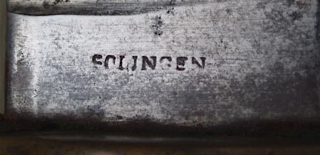

Hi Jim,
I can't think of a British sidearm that equates to the Continental briquet sabre. The only three I can think of that are remotely similar are the so called Spanish pattern sidearm the Dundas sidearm and the Pioneer sidearm.
My Regards,
Norman.

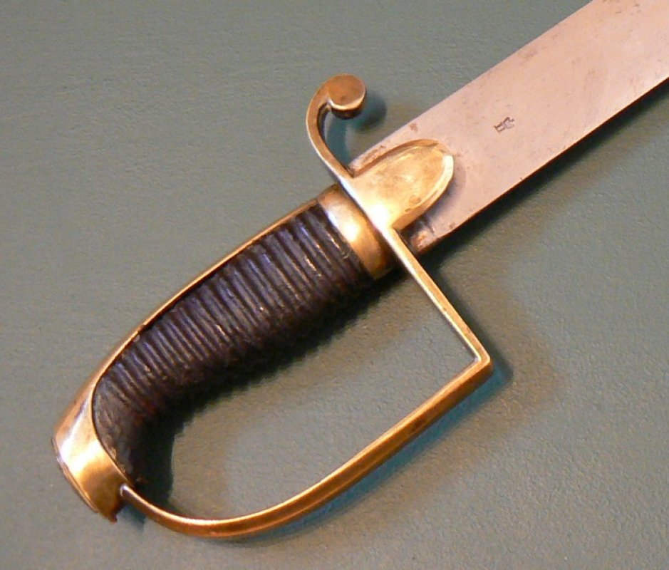

As I presented this briquet hanger in my original post, I only cited my sources, which were of course effectively my words. I have taken to get illustrations of the pages of these references to show how I formed my opinion.
While it is suggested that there is apparently an absence of awareness of this type sword in British context......these sources might at least show my reason for my hypothesis.
These pages, top to bottom:
1,2,3: "European & American Arms", Claude Blair. N.Y. 1962 pp.96-97
4: "Swords for Sea Service" (2 Vol.) W.E.May & P.G.W. Annis, HMSO, 1970,
p.333
5,6,7: "Swords and Sword Makers of England and Scotland" Richard Bezdek
2003
8: "British Military Swords 1800-to Present Day", 1966, #66
In the volume by Blair, example (e) is shown as a FOOT ARTILLERY GUNNER sword, in the plates of British swords.
In photo 4, the page from May and Annis (p.333) describes makers of hilts, using the convention of marking their hilts with their initials (c.f. as per example FT= Francis Thurkle)....even if NOT silver.
In photos 5 and 6 are the Bezdek entries concerning Storr, and various partners including his apprenticeship in 1790s with silver workers as well as hilt makers.
Most compelling was this photo of one of these 'foot artillery gunner' swords taken from John Wilkinson-Latham (1966, example 66) which is noted as c. 1814 (shown here as photo 8). In the text he notes a mark on the blade which he believes is TROTTER (though indecipherable).
Photo 7 shows the page from Bezdek with Thomas Trotter, sword cutler 1814-1820.
So in a reference from 1966, by John Wilkinson-Latham identifies one of these briquets as British foot artillery gunners sword c. 1814-20, and that a mark on the blade even indecipherable he considers Trotter, an established English sword cutler.
Since Blair (1962) has identified this same hilt as foot artillery gunner sword, it would seem that Wilkonson-Latham was in accord.
As Paul Storr was working as a silversmith 1790s onward and took over manufacturing factory in 1807 with Rundell, and was in that setting until 1819, is it possible he may have absorbed the convention of the two initial marking of hilt even of cast brass?
The Wilkinson-Latham example (#66) is identified c. 1814.
Thomas Trotter (if indeed this was the mark) worked 1814-20 as a sword cutler. Which means he was procuring blades in that period, the same time that Storr was running the factory for Rundell.
In these early days of establishing contracts between Board of Ordnance, the varied cutlers and blade makers as well as hilt makers, when the idea of regulation patterns was just in early stages. ...the idea that a pattern of this type does not exist in British context just does not seem likely. We know the 'Spanish' pattern was widely known and used, it is strange that the pattern or type I have known and supported by these authors is deemed non existent.

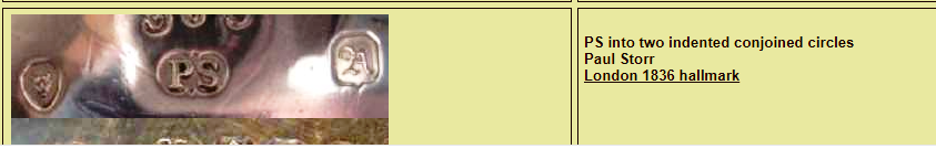

Looks like it will be hard to determine that Paul Storr, on his own senses, went on producing Briquets, unless factual evidence is found out there; not just by association of ideas.
Whether Thurkle made silver (and other metal) hilts, these seems (to me) that were 'one of a kind' examples, not a production in numbers. Then thinking of Storr, a silversmith Guru; to make a (one) sword you need an atelier (workshop); to cast a number of brass hilts for an army contract you need a factory... and a different attitude, i guess.
On the other hand, while joining two (or more) letters in a cartouche of a certain shape may give an idea of a determined silver smith mark, this is a recurrent procedure; their "trick" to distinguish one from the other, is basically the detail within the cartouche form. Even rectangles may be seen "by the dozen"; Storr himself registered a few different ones.

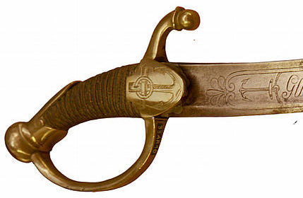

Hi Jim,

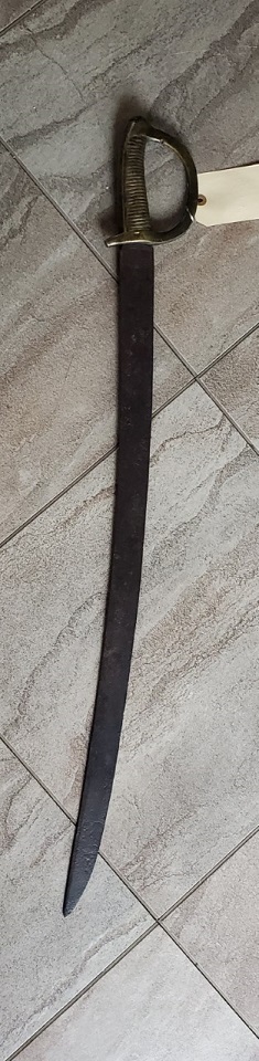

I just noticed your Briquet has had the quillion terminal removed. I have a French ANXI sabre with the same modification. Made in Klingenthal, poincons J.A. Kranz inspector 1812, F.L.Lobstein reviser 1804/21, J.G.Bick controller 1812/15. Might be something.
My Regards,
Norman.

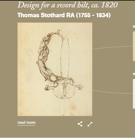

https://collections.royalarmouries.o...armouries.html Volume 2 page 295 no images but blade markings noted.
