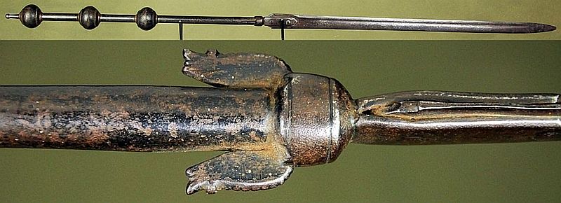

Wayne, thank you for the illustrations! As always, especally in this case, a picture is indeed worth a thousand words!!!

Wayne, thank you for the excellent illustrations! As said, a picture is worth a thousand words, especially in these kinds of situations!!

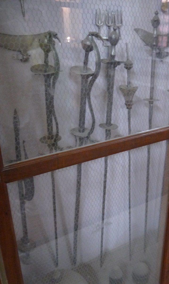

You are welcome, Jim. I note in Mercenary's photo a pair of these two handed weapons that have a snakelike double finger guard, each 'wiggle' protecting a section of grip below the corresponding disk guard, I'm assuming for parrying. (And an elephant proboscis 'hook' on the pommels)
