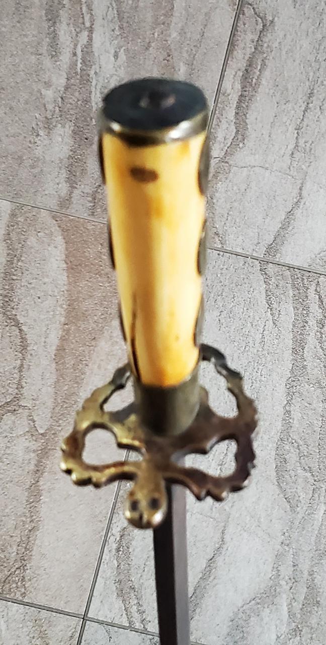

A sturdy blade, double edged, sharp, length 51 cms.
The grip in ivory, with a nice patina; the hilt in brass; the peen untouched.
Could you Gentlemen help finding its age and country of origin ?

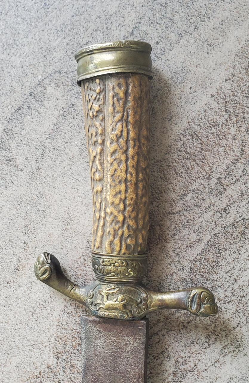

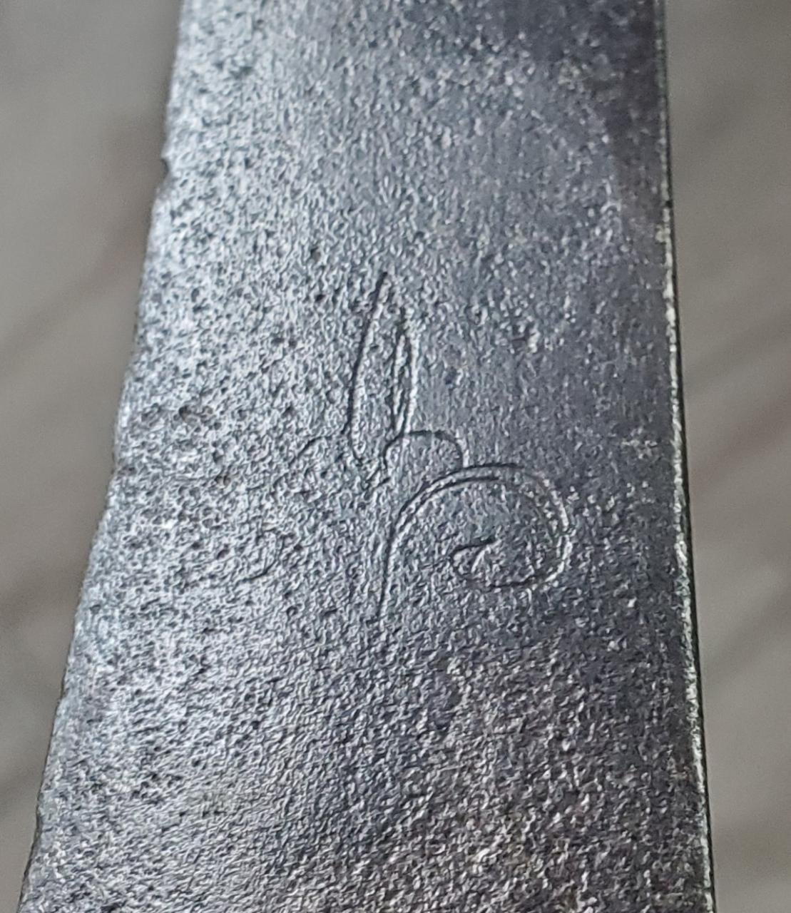

Based on an example I have (attached), I would say this is English, first quarter to mid 18th c. The blade on mine seems a cut down hanger blade, the fluer de lis, while suggesting French, also is found on blades traded to cutlers in England. There was a street, do not recall details, actually named 'fluer de lis street;'where lots of blades were sold to cutlers, who then mounted them accordingly.
It seems the German hirschfangers had shell guards downturned in many cases, but not sure of frequency.
These swords I would note, often found maritime use as well.

I'd place it mid to late 18th due to the 'cap' type guard that would fit over the scabbard throat to prevent rain water drainage into the sheath (and thus a risk for rusting). I've never seen this affectation on (later) 19th century pieces and it was sort of an 18th c. thing. Beautiful example, 'Nando and I like the honey patina of the grips!

As the Capn has astutely noted, that 'cap' over the ricasso at the bottom of the guard does suggest 18th century. While these features may of course have extended into 19th in degree, it does lean to the earlier date.
On the example I posted, that feature is missing, and perhaps might have been there with the notable gap suggesting a remounted blade. Note the ends of the quillon terminals with hunting dogs.

Here is what I believe to be a Continental version, probably 18th,and it seems to me the 'buttons' and open guard lean toward some French and German examples.
