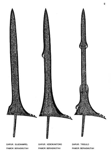

Oh, i have no doubt this keris was modified, and not with any particular skill either. I am sorry to say that this was most probably done to make a low grade keris more interesting for sale in the marketplace. You can find this as a legitimate dhapur which i believe might be called dhapur trisulo, but this would not be a good example of that.

Originally this was a pretty reasonable village level keris, then somebody took to it with an axe --- well, maybe not an axe, but a file or hacksaw or something. Pity.
Ive seen this alteration done to better quality keris, and done skillfully, and they don't look too bad, but this alteration has been roughly done.
I do not know this form, nor anything like it as a legitimate dhapur, but Dhapur Sategal sort of comes close.
David, I've never heard of Dhapur Trisulo for a keris, where did you pick up the name?
I hate to say that i am uncertain which book these dhapur drawing come from. I believe they may have come from Empu Djeno. I don't own the book they are from so i can't confirm that. Anyway, i downloaded a bunch of them off the web a while back. The one called Trisulo is a little different, with two kembang kacang near the tip of the blade.

Yeah, that looks like it comes from Pak Djeno's dhapur sheet:-
http://www.kerisattosanaji.com/DHAPU...NGTODJENO.html
I regret I cannot make a favourable remark here, so I'll say nothing.

No worries Alan. I was simply trying to establish that at least some people see this dhapur as a legitimate one. I don't know that i have ever seen this dhapur on a keris that was originally forged this way though. I've personally never been fond of this type of alteration.
Old 6th March 2021, 08:13 PM   #17
Posts: 7,263
David, from what I have seen of this form of keris it is something that started to appear during the 1960's in Jogja.
"1960's" is a guess, I've never seen one that I could definitely place pre-WWII.
Jogja is not a guess.
