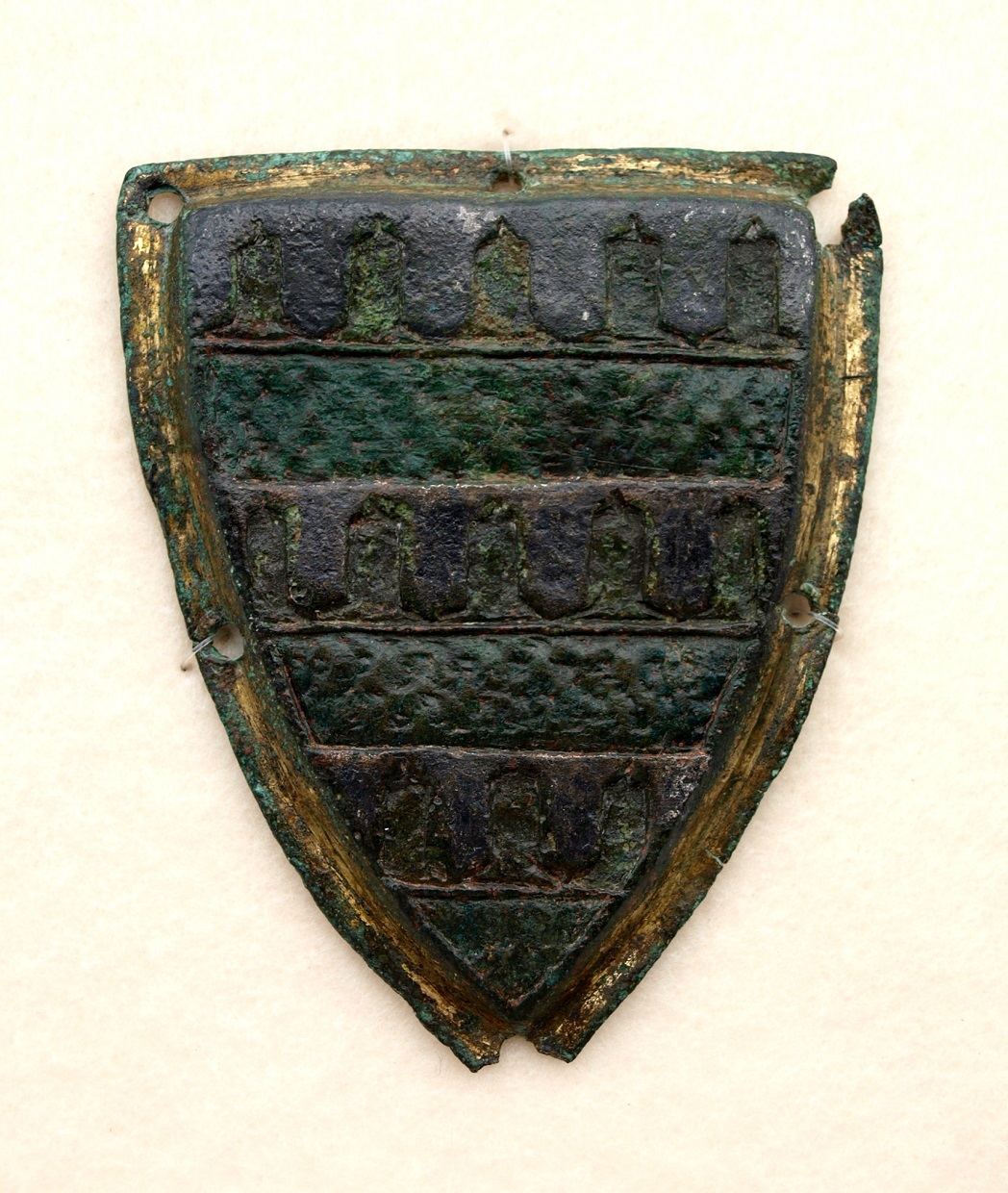

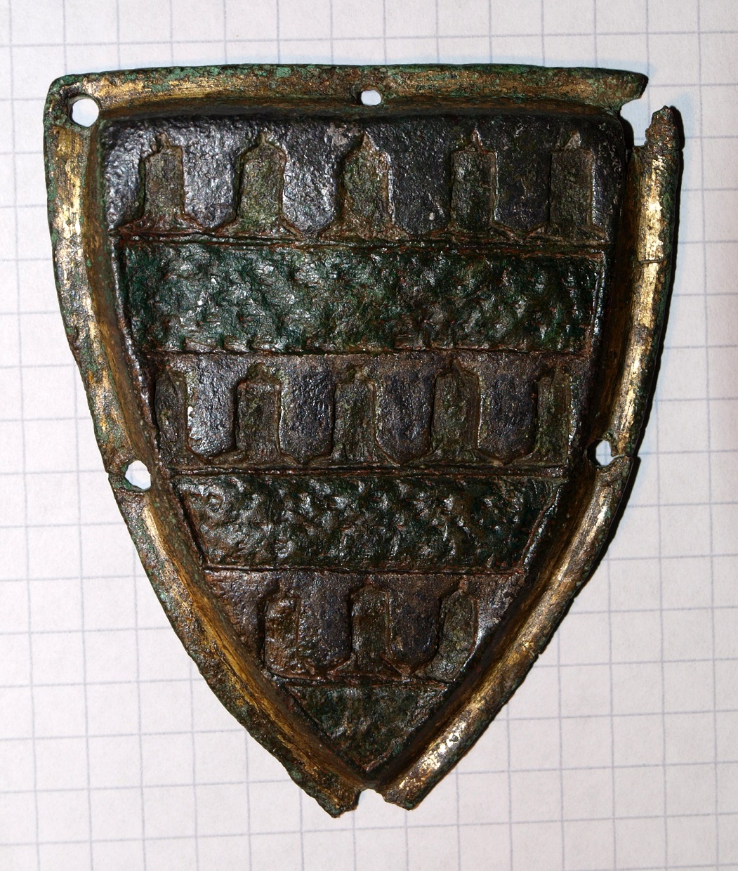

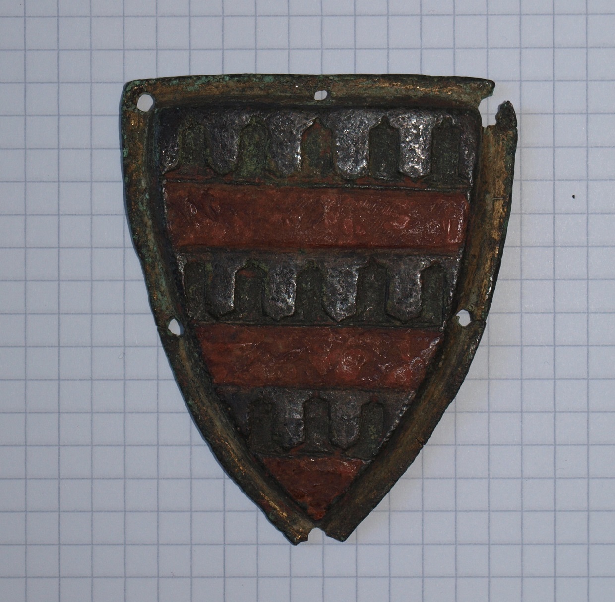

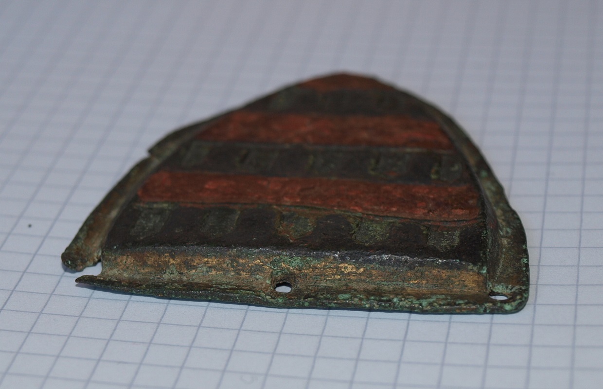

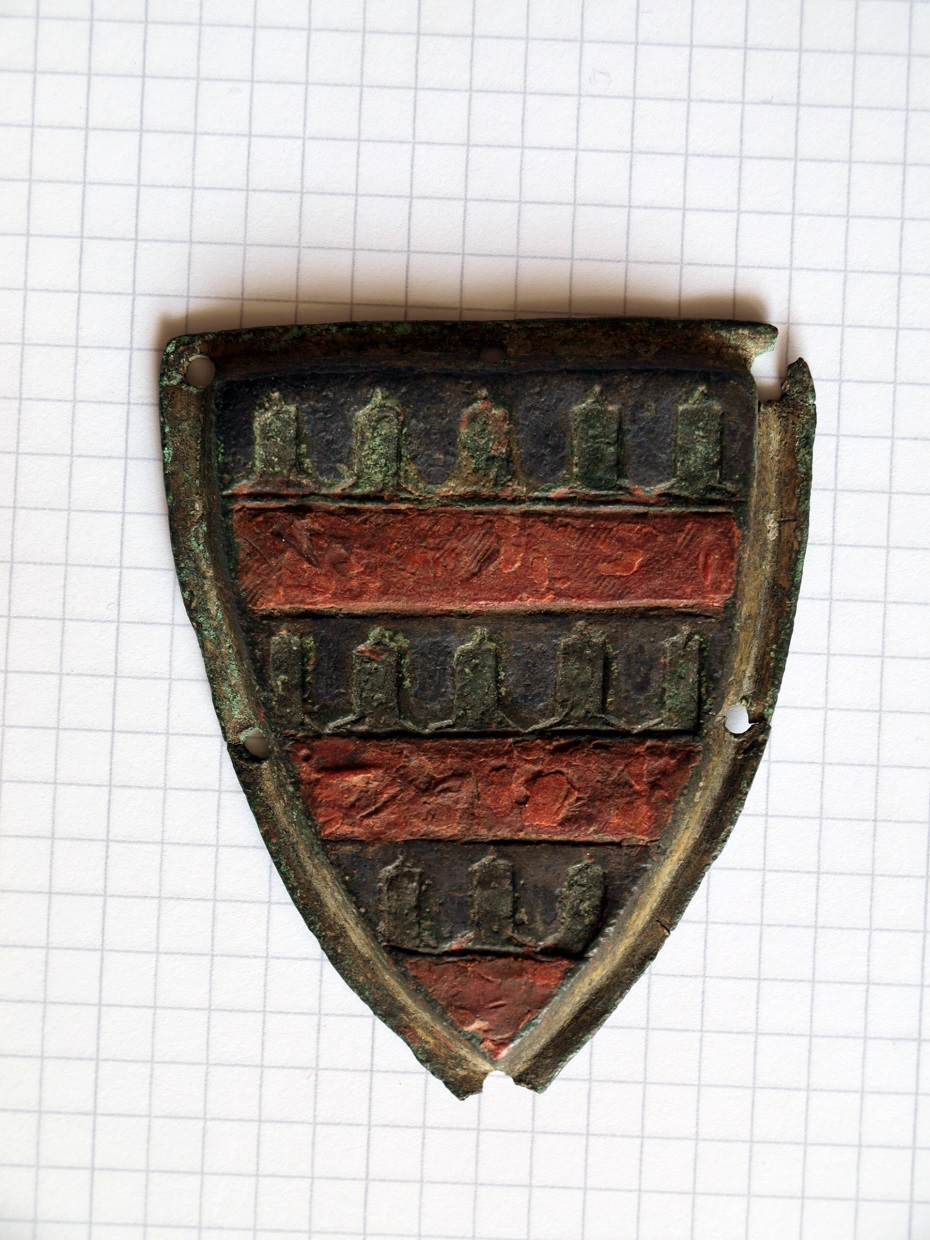

Hi there,
although it is not an arm or armour but a coat of arms, I hope someone can help here. I recently got this coat of arms. It measures 7.5 x 6cm and weights 35 g. The shield itselfs seems to be made from bronze or copper with an attached layer of silver or another "white" metal (see also 3rd image). According the paper note on the backside it was found in the river of Seine.
The CoA is the one of the Maison de Coucy: https://fr.wikipedia.org/wiki/Maison_de_Coucy
It seems that the potentially blue parts are already gone. I canīt tell from what material the red areas are made. The white metal represents the white areas of the blason.
Is it possible that this shield is a messengers badge?
I found some examples here (which of course are larger and from much better quality):
https://www.metmuseum.org/search-results#!/search?q=messenger%20badge
What do you think about its possible age?
Looking forward to your comments!

No ideas?
The shape of the shield indicates 13th century. At this time the Coucies have been one of the most powerful families in france. I wonder if this blazon could really be from that period.
AHorsa is offline   Reply With Quote

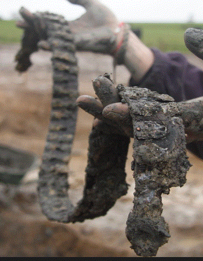

Old 22nd September 2020, 03:28 PM   #8
Posts: 6,432
Default A Belt Applique
Makes sense.
http://www.la-detection.com/dp/message-2902.htm
Old 22nd September 2020, 06:58 PM   #9
Perhaps a bit too large for a vervelle.

Old 23rd September 2020, 11:27 AM   #11
Originally Posted by AHorsa
Or maybe a horse trapping
What do you mean by that, Andreas ?
Old 23rd September 2020, 11:42 AM   #12
Going back into the period, a vervelle could either be an (heraldic) adornment to attach to a belt or to a horse harness. The ones i have spotted so far are slightly smaller than Adreas example.
I guess many reasons could originate its falling off. If in fact it was an implement adorning any part of a knight's personal ot horse's gear, it could have been ripped out while in combat.
On the other hand, we can't exclude the possibility that, wherever it was riveted, belt, harness, box, armor, uniform, someone took it off ... and temporarily keep it as a trophy.

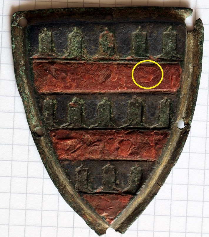

Are theses letters ... or is it only my imagination ? .

What you interpret as letters, Fernando, is just irregularities in the material. Actually I think that this red material is maybe a later replacement to lost enamel and maybe seal lacquer or so

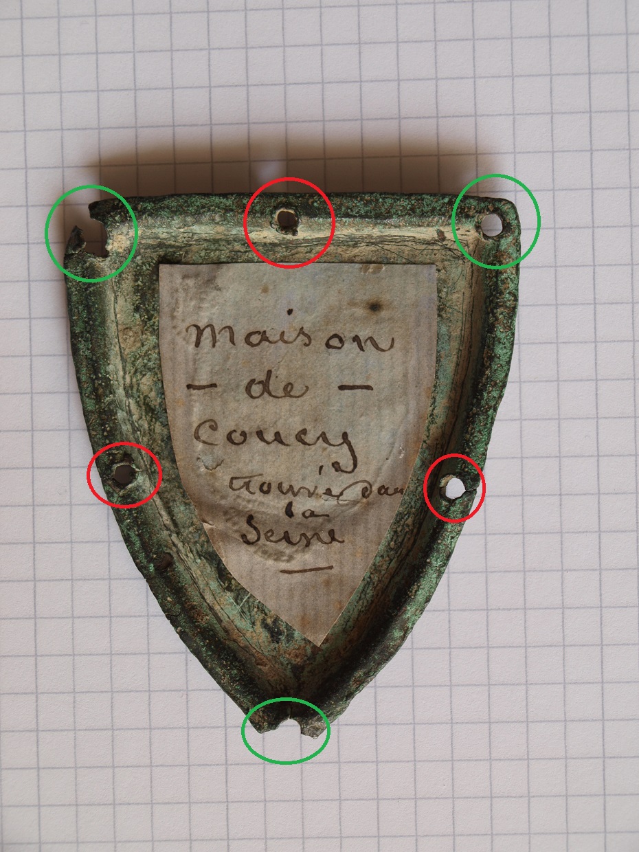

One observation I want to add for the pieceīs history:
Looking at the six holes, it seems that three of them has a bulge (not sure if this is the right phrase) from beeing drilled less professional than those three on the edges which also has those outbursts. This makes me assume that the piece was once took off forcefully, than three new wholes where drilled and it was attached again.
Old 27th September 2020, 10:08 AM   #25
Default Guessing ...
Ye, some holes would have been made with rudimentary (medieval) drills and the others perforated with a spike... by a less skilled author, so to say.
But what have been the use for the second episode; stick it back in the same place or give it a new home, having nothing to do withs its primary purpose ?

Hello together,
while the precise usage is still unclear, I figured out that the red material was wax (I think seal wax) and a later supplement as it layed over the green corrosion layer. So I removed it and gave the piece a slight cleaning. Here is what it does look like now.
Best regards
