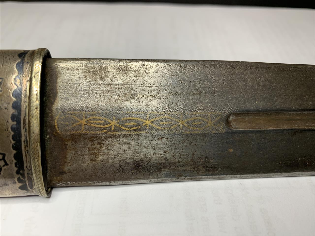

This belonged my late grandfather who was posted in the Middle East during WWII. Any information you can provide would be greatly appreciated. I can provide additional photos if needed. Many thanks!

A very nice kindjal! I think that his blade was made at the end of the 19th century by the Ottoman Turks, and the silver fittings were made by a master from among the Caucasian immigrants - muhajirs.

Looks like a typical example.
The mountings could be from Kubachi or
another place in Dagestan. The blade is maybe
chechen or dagestani, too.
Like Ren Ren I estimate it was made in
the late 19th century.

The two dates on the scabbard are the same
1208 or 1258
This kindjal is not from the 18th c so I vote for 1258, eg. 1842 AD.

In the picture of the back of the hilt, is that a twist core in the fuller?

This is Circassian work. The Circassian diaspora brought ~ 700,000 to the Ottoman Empire. Many served in the military, they were often stationed in the Ottoman provinces of Syria, Iraq and Egypt. So, very good old Circassian weapons often show up there.

It would be interesting to know why Kubur says this kindjal is not from the 18th century.

Date is clearly 1208 hjiri which is Gregorian 1794.

Yes, me too, I would be interested to know why!
In fact, I will happily change my mind if you have some 18th c similar examples
