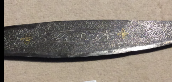

Just picked this up tonight and I think it is special.
blade 500mm long and handle another 120 mm.
Lovely Koftgari with what looks to me as Arabic writing on the blade (according to lady in Indian corner shop in our town)
in 4 panels there is writing and different in all 4 I think
Not sure if I have it correct way around so please excuse.
Very solid piece and in good overall condition blade 10mm at widest
some corrosion in spots but nothing terrible, just shows its age better.
Scabbard is plain enough and open at the back so knife can be removed
Just a few snaps to see if I can kick off a conversation, if more pics needed just let me know.
Cleaning obviously is a question but I think it looks great as is
So can anyone read what is written on the blade and what sort of age do you think it may be?

It's a Sosun Patta and a nice one. You did well there!

This is a couplet in Urdu from a Marsiya (a Shi’ite elegiac poem on the martyrs of Karbala) by the famous Urdu poet Mirza Salaamat Ali Dabir
شمشیر بکف دیکھ کے حیدر کے پسر کو
جبریل لرزتے ہیں سمیٹے ہوئے پر کو
“When he saw the son of Hyder armored with sword.
Gabriel shivered pulling together his wings”
Here is a bit about his life
https://en.wikipedia.org/wiki/Mirza_Salaamat_Ali_Dabeer
This would mean that it is no earlier than 19th-century and might suggest it is from Lucknow or the Awadh region

Cool Sosun Patta. (And NOT a Khukuri - it doesn't have a Cho/Kaudi notch in the edge near the grip.)

Kwiatek thank you so so much for the translation and the link, I will read properly in while.
I am indebted to you.
I will try and get the title of the thread changed to reflect on what the item was, Kronckew it looks like I had the wrong end of India in my initial identification.
The scabbard is v plain but the blade reveals all.
I don't think I should clean it and leave the old warrior as is
