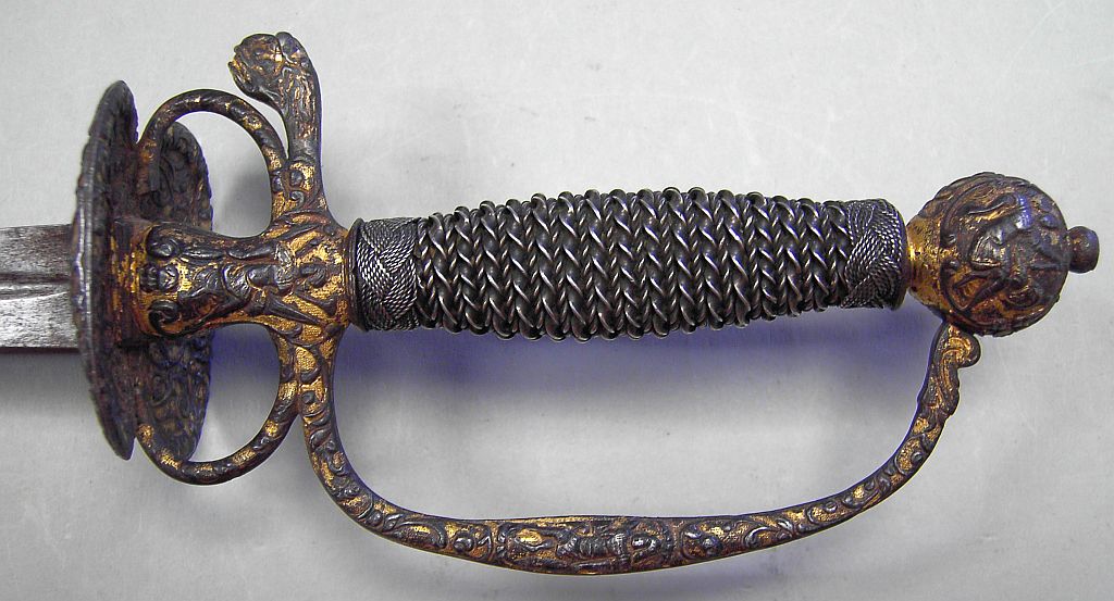

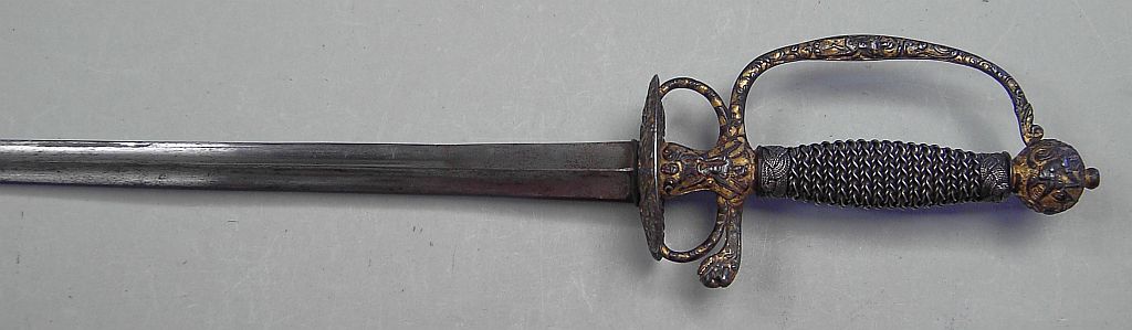

This gilt on iron smallsword hilt (see below) was posted by Corrado24 on the 24th instant and I posted the following responses which I include here as a new thread to prevent further hi-jacking of his thread:
You will see that the fuller of the wide face of the blade (or the lower face as it is sometimes described) is actually a constant width groove, not a hollow with a decreasing radius.
This is a product of the rolling machine invented by the Huguenots in Solingen in the early 1600s and used to produce colichemarde blades.
There are a few regular (non colichemarde) smallswords that feature this style of blade but generally they feature less expensive hilts as they were much cheaper to make than the traditional 'three similar faced ' blades.
I am not, however, saying that inexpensive hilts always featured this style of blade, rather the reverse, that these blades have, to my knowledge so far, always been seen on base metal hilts.
The gilding on this hilt is particularly attractive though, despite being a base metal product.
If anyone has, or has seen, a colichemarde blade that doesn't feature this constant width groove, I would really appreciate a look.

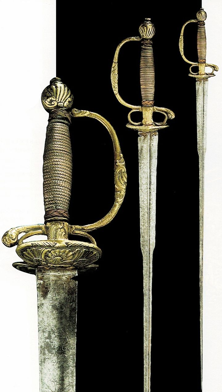

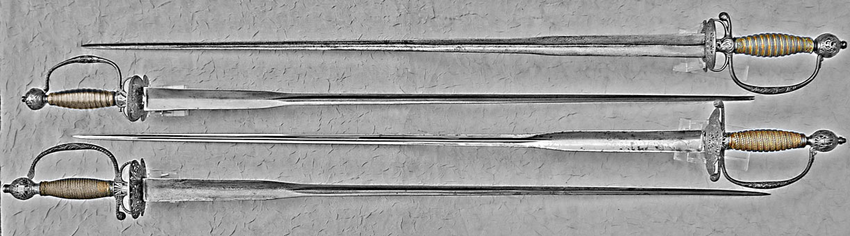

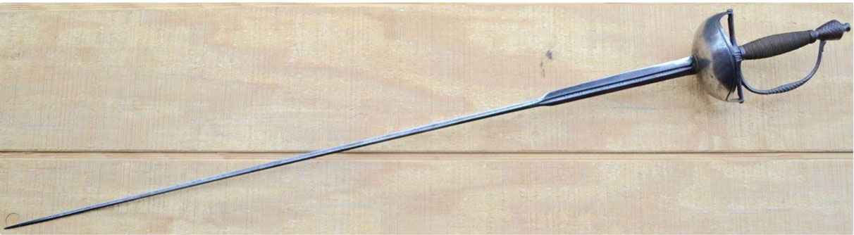

attached an example of a colichemard blade without a fuller 1740, and a precursor of the colichemard blade with a reinforced forte 1650.
Maybe by colichemarde you mean something else? Can you post an example of a colichemarde with a parallel groove/fuller?
To me a colichemarde blade/smallsword is a blade where the strongest part, il forte, of the blade is wider than the rest.( il terso and I debole)
A development that probably started in France between 1670-1690. (seitz blankwaffenII) the name colichemarde probably comes from the inventor, but this cannot be proven, General Otto Wilhelm von Koenigsmarck. (Aylward, 1946).

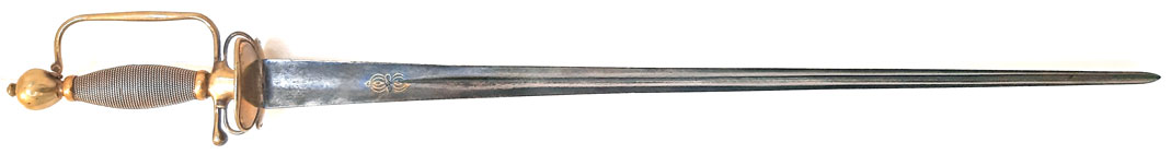

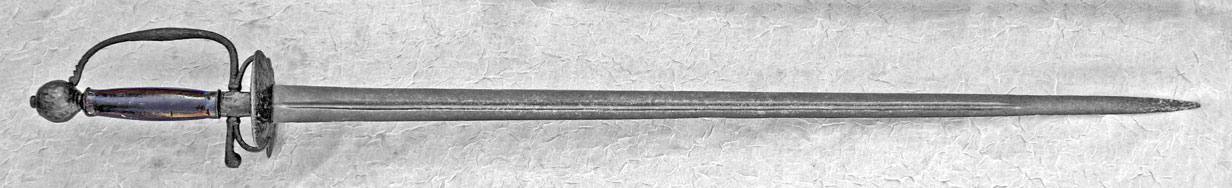

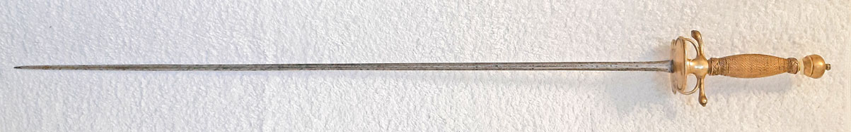

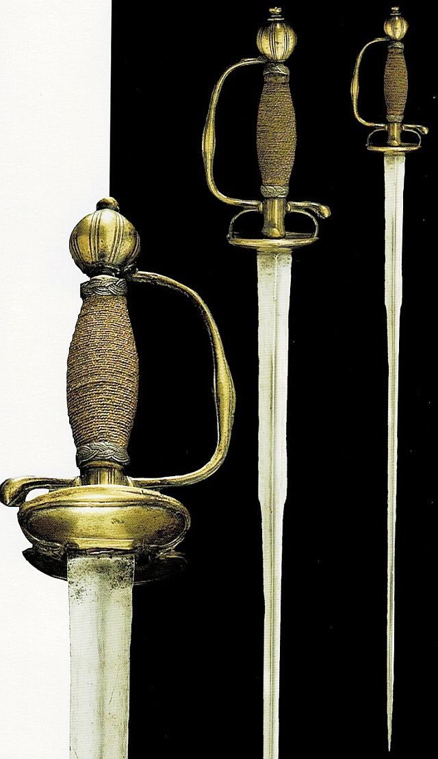

I found two further small swords without fullers at the wide side

I am sorry, I appear to be confusing the issue rather than illuminating it.
In brief:
all colichemardes observed to date - by myself and the numerous dealers and collectors I have consulted - have a rolled, constant-width groove, on the wide face, below the forte; rather than a hollow with a decreasing radius, as seen on the two upper faces and the majority of non-colichemarde smallswords.
There are also a few (very few) colichemardes with a groove that extends to the top of the forte, rather than the majority which end at the lower shoulder of the forte. Attached is an example and a picture of this sword compared to regular colichemardes: pics courtesy of my friend Mel.
If there are ascribed monikers for these positions on the forte then perhaps the cognoscenti would appraise me please.
The machine used to roll the groove in a colichemarde has also been used to produce inexpensive battlefield-issue smallswords: they are not common but equally not rare; the example posted by Corrado is just such a sword. I have attached another typical grooved battlefield smallsword which could almost have sharpened edges if desired.
What I am searching for are colichemardes with a varying radius hollow on the entire length of the wide face: if anyone has seen such a thing please let me share in your good fortune as I haven't found a one to date, and no-one I have spoken to has either.
Failing that, this means that all colichemardes (name meaning and purpose unknown) have been made using the secret machine that was built by Huguenots in Solingen around 1630.
Colichemardes pre-date Konigsmarcke and the exact purpose of the extra width forte has never been absolutely determined, although the obvious purpose is as a blocking defence against heavier blades.
There are also examples of a colichemarde shaped blade with alternative fullers in the forte and no hollows in the rest of the blade, but I have only seen one (attached: but I can't remember where it was found which is a pity as it is a fascinating sword).

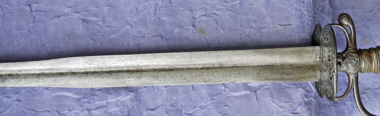

Originally Posted by urbanspaceman
Cornelistromp, I nearly forgot:
the sword on the right dated 1640 is an equally fascinating blade: is it yours?
It looks Dutch.

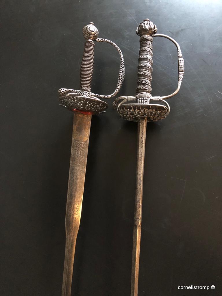

ah I now see what you mean by the narrow fuller in colichemarde blades, This type of fuller occurs indeed on smallswords from the mid-18th century, usually of triangular section with hollow ground.
yes the equestrian hilt from my collection is attributed to the Dutch, however the high quality carving of some of the hilts also points in the direction of the medal makers in Paris.
For some other examples of "fortified" blades attributed to the netherlands, see eg.
