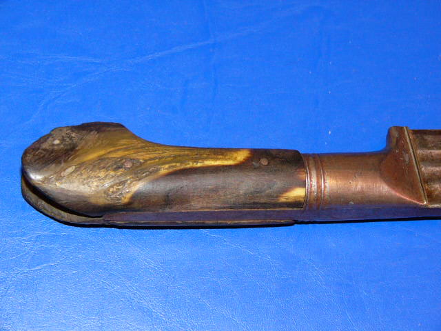

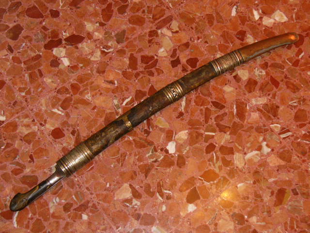

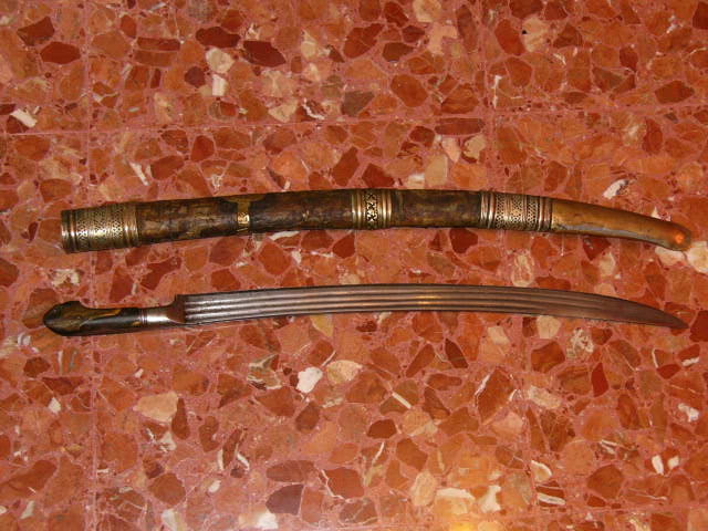

HI!!
I HAVE THIS SWORD 2 YEARS AGO, I ONLY KNOW IS FROM AFGHANISTAN, SURE. THE HANDLE IS WOOD AND THE SCABBARD IS WOOD WITH SOMETHIG SIMILAR TO SKIN, BUT IS VERY DAMAGED.
WHAT KIND OF WEAPON IS?
THANKS
Old 5th February 2005, 01:07 PM   #2
tom hyle
Location: Houston, TX, USA
Posts: 1,254
Yep, nice. Again, essentially a sha'sh'ka. One wonders of there isn't another local name for these than yatagan; at least yatagan with some sort of modifier. Note the regionality; that's a salwar yatagan bolster.

My opinion is that this is a central asian shashka. Afghanistan, Uzbekistan etc. I have seen some but this is the most well done of all.

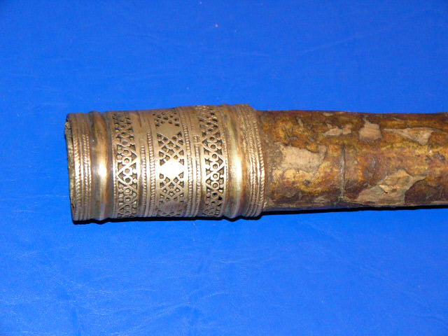

The scabbard is fine, exept the worn leather that it is normal for the 100 years of its age.
Carlos, are fittings made of silver as I suppose?

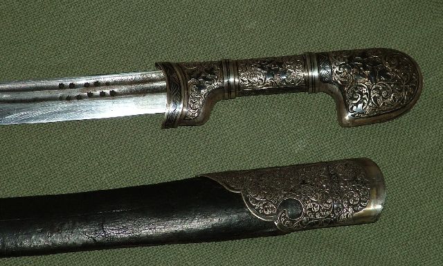

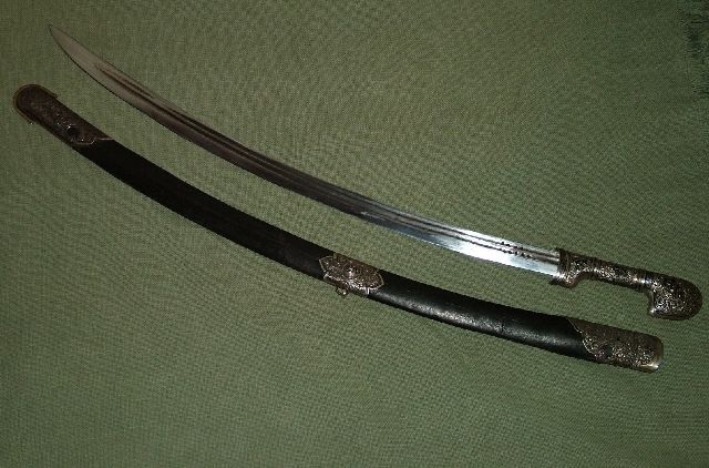

Tom, as usual, you hit a point. Personally I dont care about the length of the sword as far as I feel it ok in my hand.
Talking of shaskhas my favorite sword this period is an asian type shaskha . This beauty is the one that I could choose to hold if I had to fight with swords
It has great balance and a strong blade (german I think). But before this, my favourite arm was a medium size kilij. There is a difference of 20cm (!) between them, but both have great “feeling”. I cant say the same for all my swords.

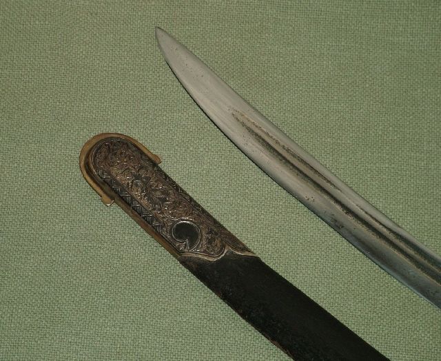

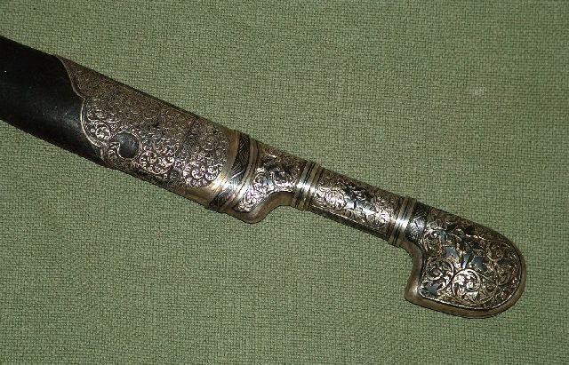

I thought it was quite the opposite. The most shaskhas have the kind of scabbard you describe but some of the so called “asian” have the hilt bigger than the scabbard, so they overlap it. Like the shaskha I show here.
Also my opinion is that it is better to call this type “Islamic” than “asian”, because it comes from the muslim tribes of Caucasus. So we can have a difference from Carlos shaskha that is “central asian”.

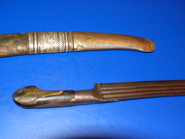

Having unloaded my 5 cents worth of knowledge on Shashkas, I'd like to ask Carlos: how long is the blade? Looks unusually short to me. Is it a child's sword? Any markings on the blade? Very pretty weapon, congratulations!
Old 7th February 2005, 07:14 PM   #13
carlos
Posts: 755
HI ARIEL!!

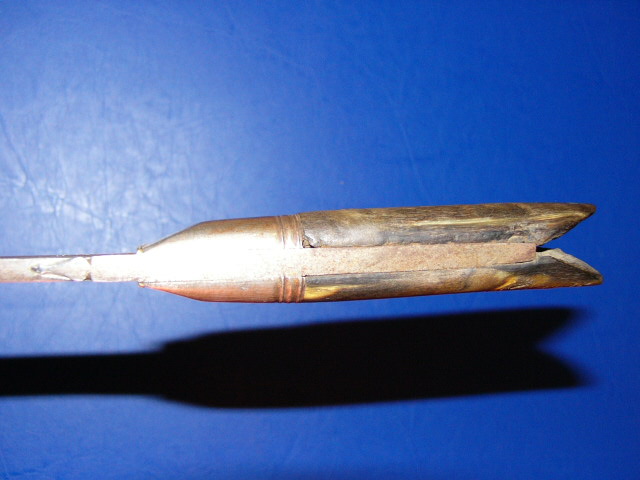

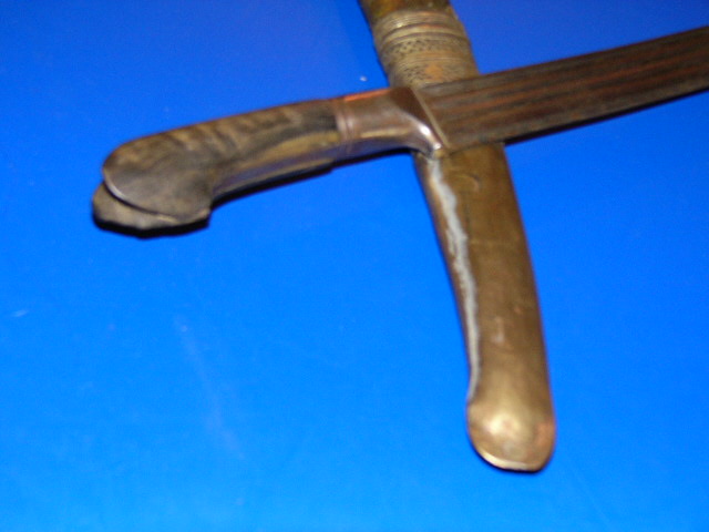

THE BLADE DON´T HAVE ANY MARKS , THE TOTAL LENGHT IS 61,5 CM AND THE BLADE IS 48,5 CM.I,M SORRY BY MY SHORTS MESSAGES BUT MY ENGLISH ISN´T GOOD!!. I ADD ANOTHER PICTURE.

This is a great example of Afghan/Uzbek sabre, which are fascinating if nothing else for thier scarcity here in the west. As has been noted, the blade does seem to be of characteristic trade form, whether German or possibly Styrian is unclear, however European in any case.
The use of the term shaska seems ineffective applied to these, and its use seems compelled by the obvious similarity in hilt form, especially the cleft pommel.While I cannot speak with any authority linguistically, it seems the term shashka is actually Russian, and refers to the Caucasian sabres that were later adopted into military pattern in Cossack regiments.
