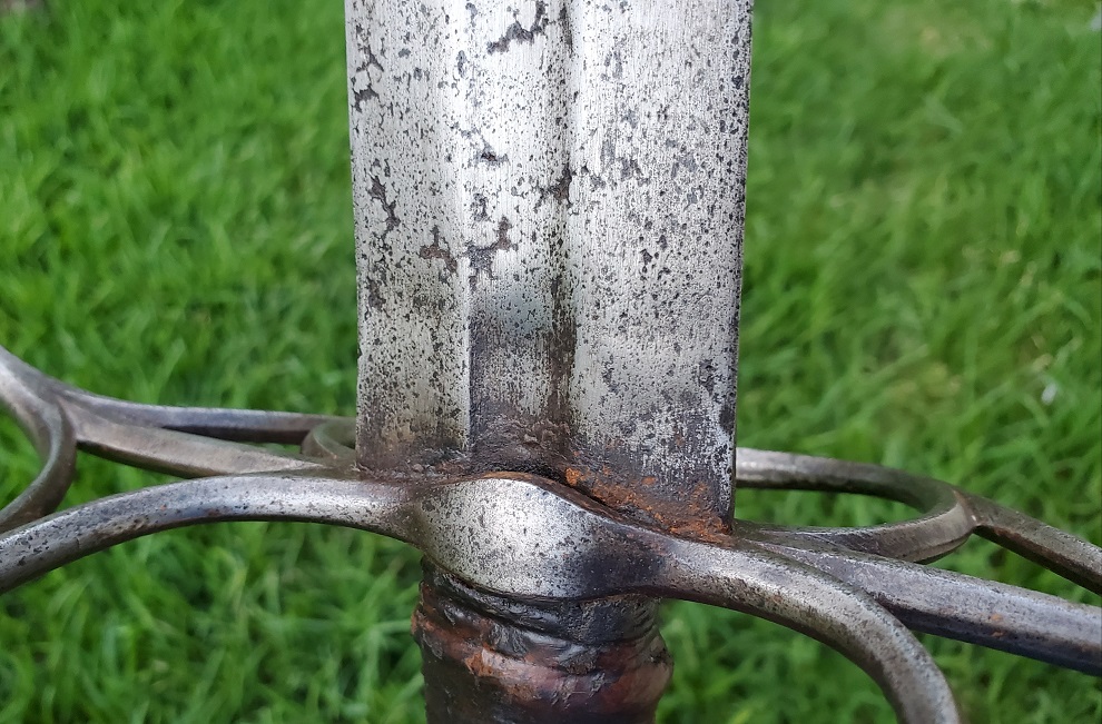

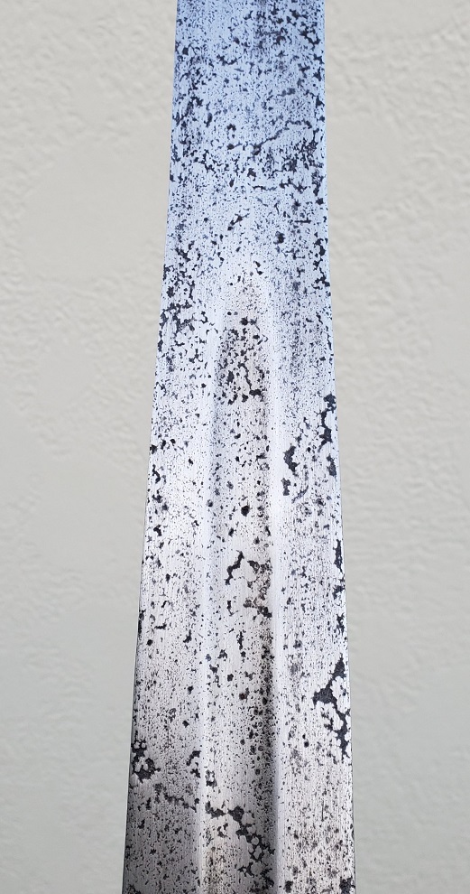

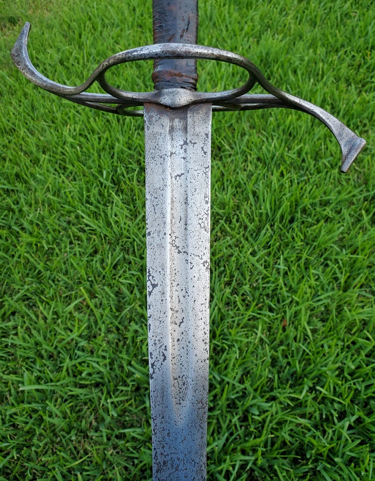

Recently added to my collection. Its extremely light and nimble in the hand. The blade is wide but flexible. The usual questions; age, origin, other known examples?
The straight line mark at the base of the fuller, would that have been from blade tongs during forging?
As always, all comments and questions are welcome!
Thanks!

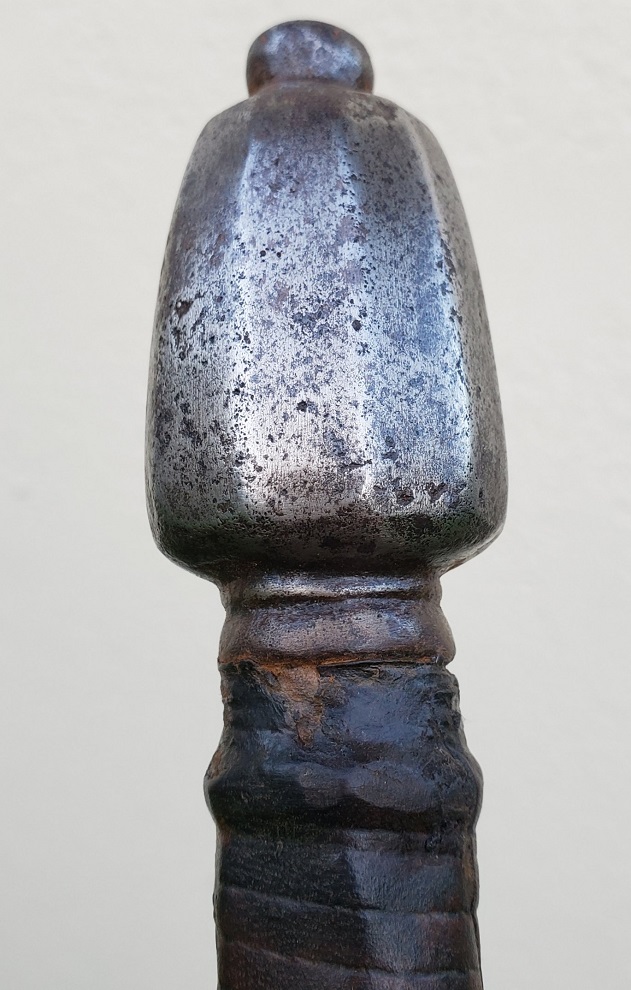

Thanks for posting this, looks nice! Could you please give us some measurements, and the position of the balance point? Also,a pic of the tang button?
The "straight line" that you mention -- I trust that you're talking about the slight transverse indentation. Does it appear on both sides, exactly opposite?

diagonally recurved quillons flattened and expanding evenly towards their ends where they are scrolled sometimes also the scroll is splitted, is "common" on Italian rapiers about 1520-1620.
this type of pommel, converging towards the top was populair about 1570-1625.
so if the sword is authentic, which I cannot judge from the pictures probably italian, and late around 1600.

Hi Casey , congratulations with a beautiful hand and half sword !
There is a similar one in the Wallace collection , however that one could be with a associated pommel it is a bit out of style with the guard , while your pommel is in style with the guard both are faceted and have the same type of design.
Here is the one in the Wallace collection and its description : Longsword Solingen, Germany and Switzerland Date: c. 1610 - c. 1630 (pommel) early 17th century (guards (Swiss))probably first half 16th century (blade (German))
Date:c. 1610 - c. 1630 (pommel)early 17th century (guards (Swiss))
Longsword, the blued hilt made up of a pommel in the form of an elongated oval, divided by a central ridge, and notched in the middle on each side; grip, swelling in the middle, corded and bound with leather; diagonally curved guard with scrolled tips, and accommodating two large pierced shell-guards; the double-edged blade of hexagonal section with hollow groove, bears the running wolf mark inlaid in copper alloy.

I don't have much to add, as Ulfberth already said everything, but I can however tell that, having personally handled an original XVIth longsword, this one looks good and authentic ! (With the usual caveat of judging such things from pictures only.)
I'm not sure what that dent or "line" is, but it is sure it is not a tong mark (you can't really mark a blade that deep just with your tongs during forging, and even if it was the case, it would have been polished out later). It could be a later blade damage, but could you tell us if that line is present on each face, and if the blade gets significantly thicker between the guard and the mark?
