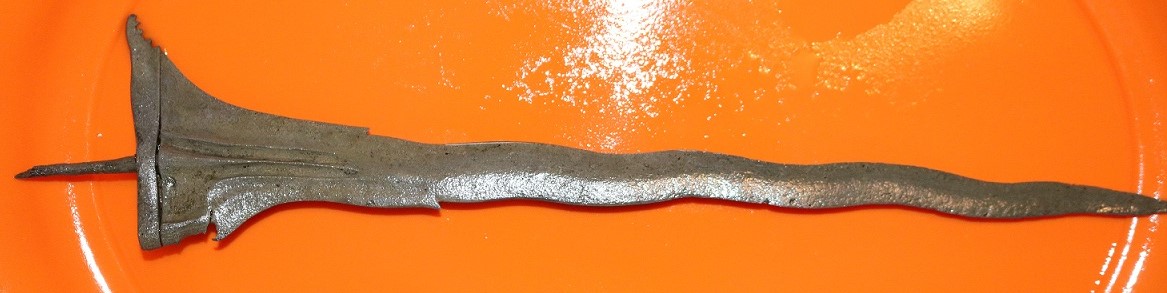

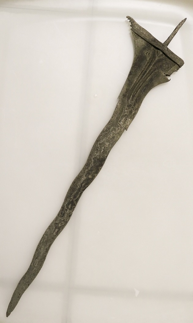

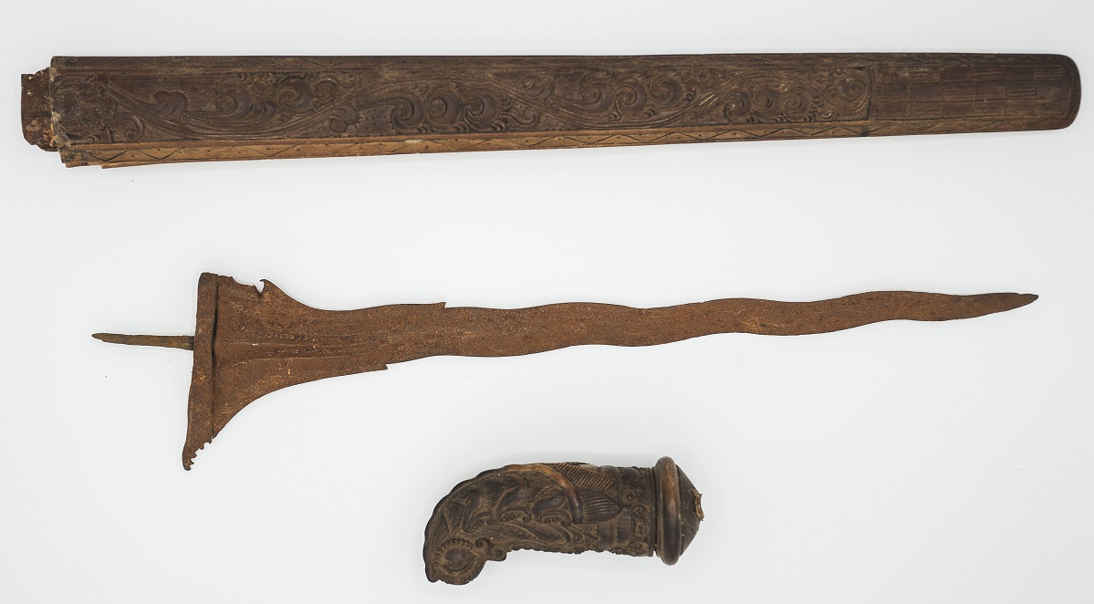

Hi
Looking for some opinions on these 3 keris. Are they old timers who've seen better days? Also, curious to learn some basic rust cleaning & general cleaning techniques if anyone would care to share or link to already shared tutorials.
Thanks!

There is a heap of stuff in this Forum on cleaning and restoration, I don't know where it is, but maybe David can point you in the right direction, or tell you how to find it.
Apart from that, as Jaga has commented, just a decent cleanup with detergent and a toothbrush can work wonders on a blade if it is not too dirty. I think I'd be trying this on the top keris with the Bugis-style hilt. This actually looks like a pretty decent blade.
The middle blade that is thick with red rust needs a vinegar soak, when you find the cleaning stuff I've mentioned it will explain how to do this. This blade is what we call a "robahan" = a changeling. It has been altered to create the pudak setegal spurs on its side.
The bottom blade is an old very ordinary Javanese blade, this might respond OK to just a dishwash cleanup too.
The top blade does not belong with that Bugis pistol grip type hilt, but it would go pretty nicely with heavily carved hilt that is under the very rusty blade.
The bottom blade has a correct hilt already fitted.
The top scabbard can probably be glued together, but really, none of these blades belong in it.
The other wrongko parts look too far gone to do anything with. Put them into the spare parts box until something comes along that you can use them with.

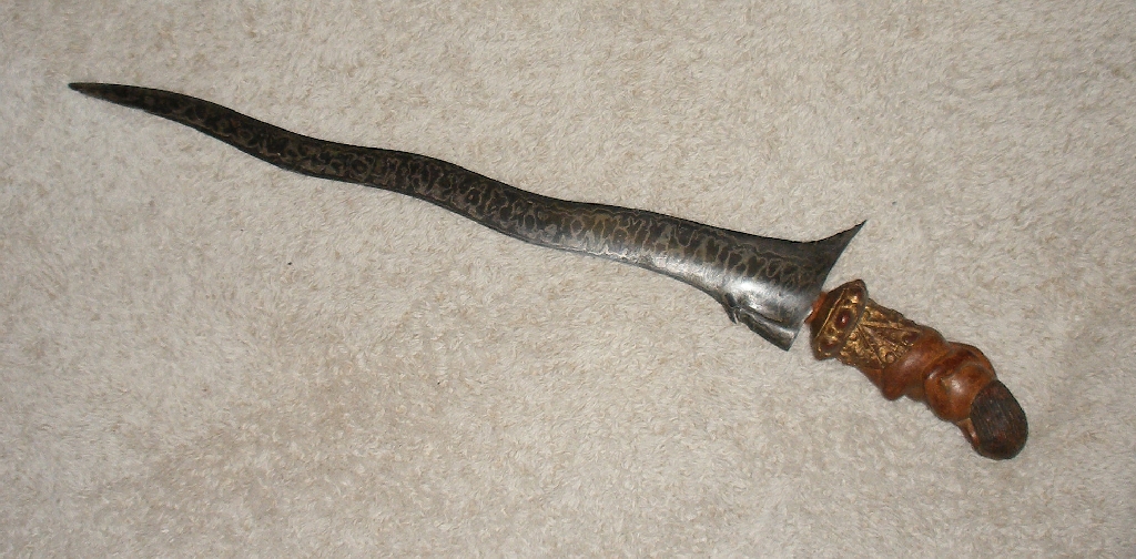

Apolaki, your blade in bugis dress seems very similar in technique to this example that I got some years ago.

Mine?
Gonjo iras; I don't know this pamor.
Apolaki's keris looks to be an iras also

The vinegar solution is doing wonders to the keris! Thank you so much. The rust is almost completely gone.
I wanted to know after I have finished its last bath and applied baking soda slurry to remove the remnants of vinegar, what is the next step? Essentially, I wanted to know:
1) Is the process of etching different, what are some solvents readily available to common consumer?
2) If I choose not to etch it, should I just rub it well with oil, and if so what type of oil is recommended WD40?

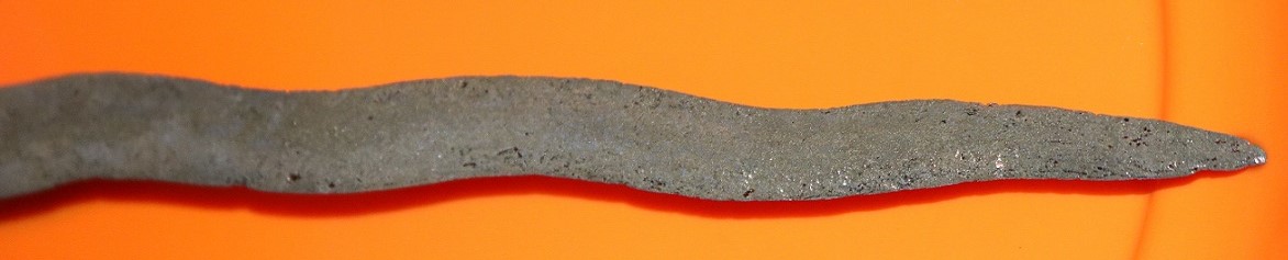

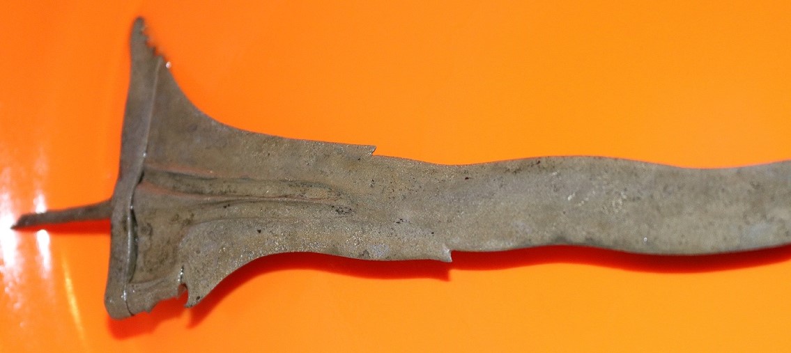

I dried it throughly with hair dryer, and I am at the WD40 stage for the heavily rusted keris. It looks like there is pamor; Once I dry various applications of WD40, I plan to apply a final layer of pure mineral oil as a last step.
Is this turning out okay? There are trace amounts of yellowing. When oiled I can no longer make out the pamor as the first photo.
I also could not remove the ganja, but I could see some rust remaining in a small interior crevasse.

That's coming up OK, but you see all those little black dots, well, they need to be cleaned out.
I use two tools for this, a dentists pick, and a saddlers awl with a fine blade in it, I also use a machinists loupe, about 2.5X or 3X. You need to dig the rubbish out of those pits, if you do not, over time rust will usually spread from them.
Ordinary mineral oil after the WD40 is fine. Medicinal paraffin or Singer sewing machine oil is what I use, but I add a fragrant oil to that. The fragrance does nothing in the way of protection, but it is traditional.
When it has been oiled, it is best to store it in a plastic sleeve.
The gunk in the joint between blade & gonjo is nearly always full of rubbish in old keris, a full restoration would involve removal, cleaning and a tight refix, for the last 50 years most m'ranggis have used a two part epoxy cement on the joining surfaces, not to hold the blade and gonjo together, but to protect against further erosion. Since this is your first, I would suggest that you do not attempt the demount of the gonjo, just clean out what gunk you can with a pick and let the oil soak in.
