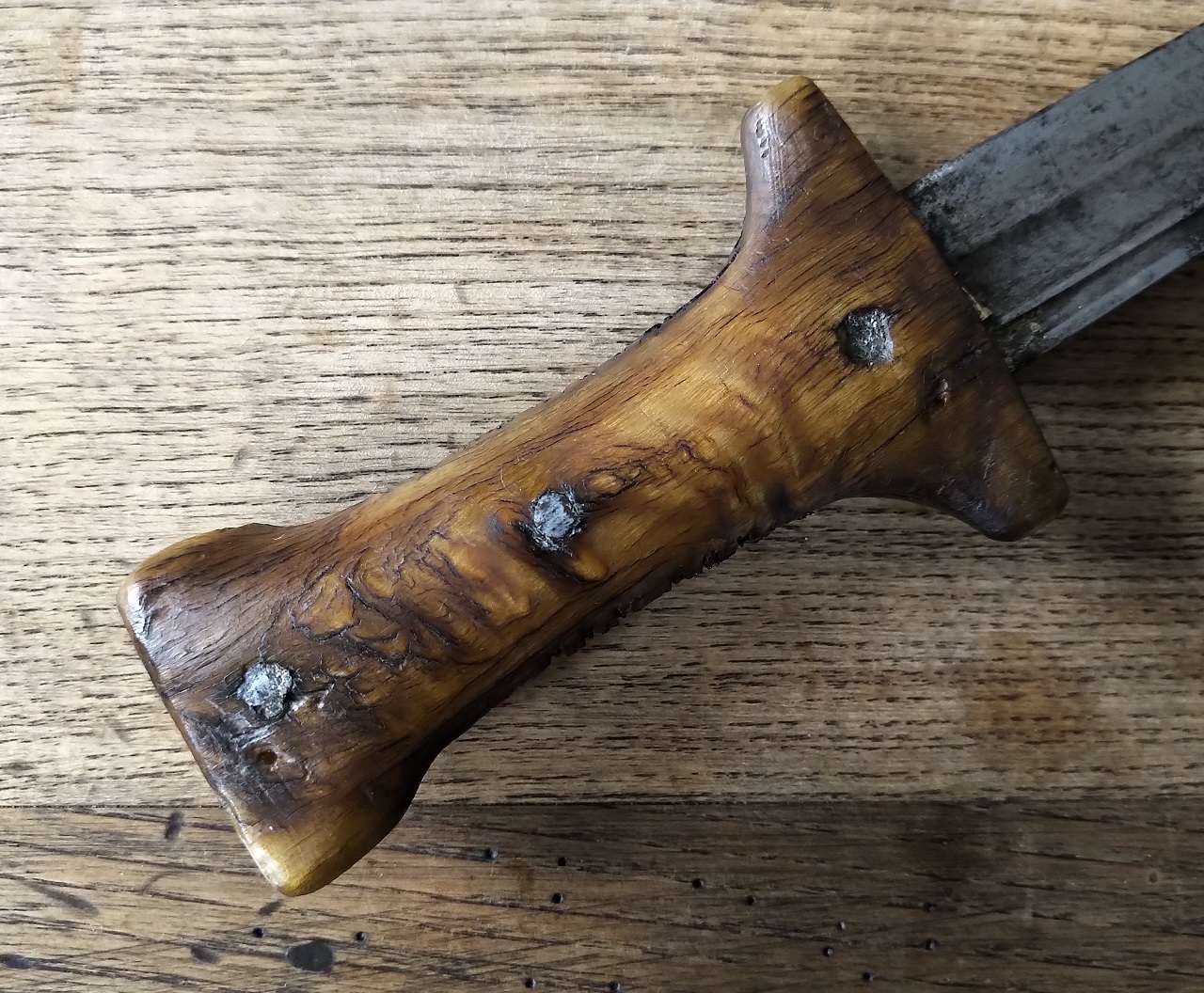

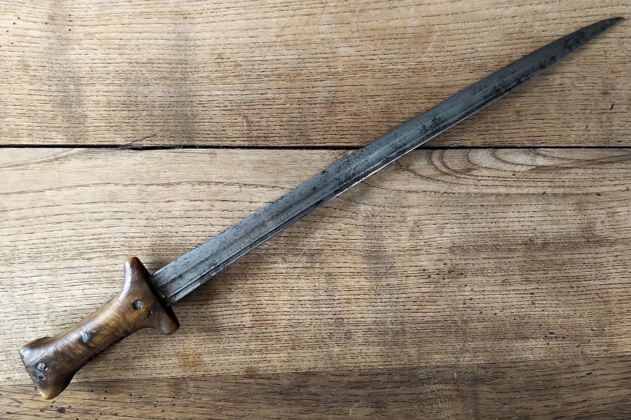

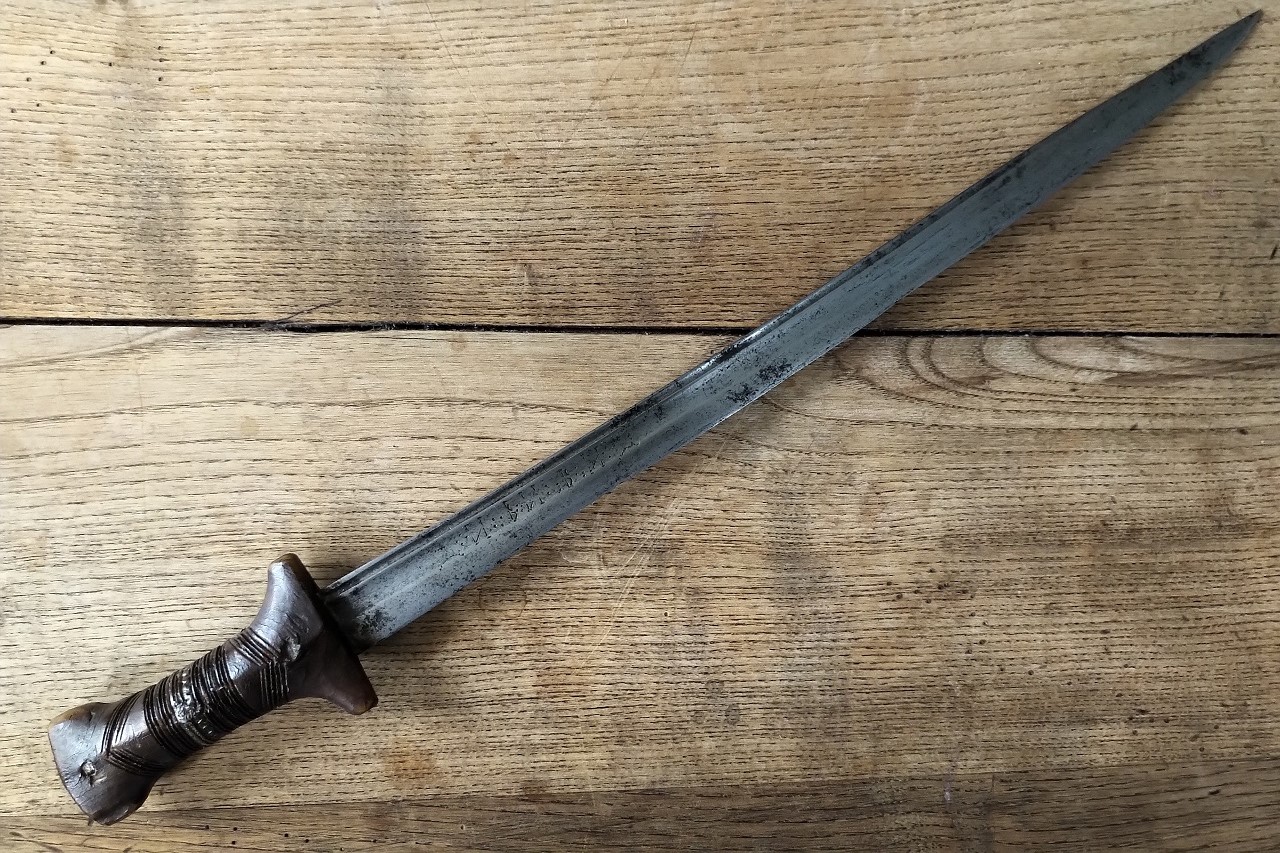

For your consideration, here is a classic morrocan sboula that I finally took the time to properly clean.

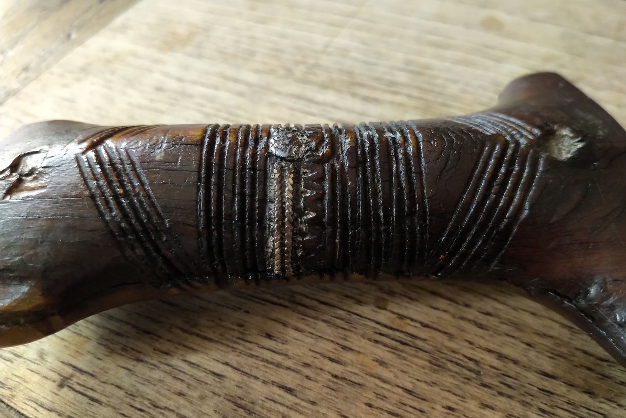

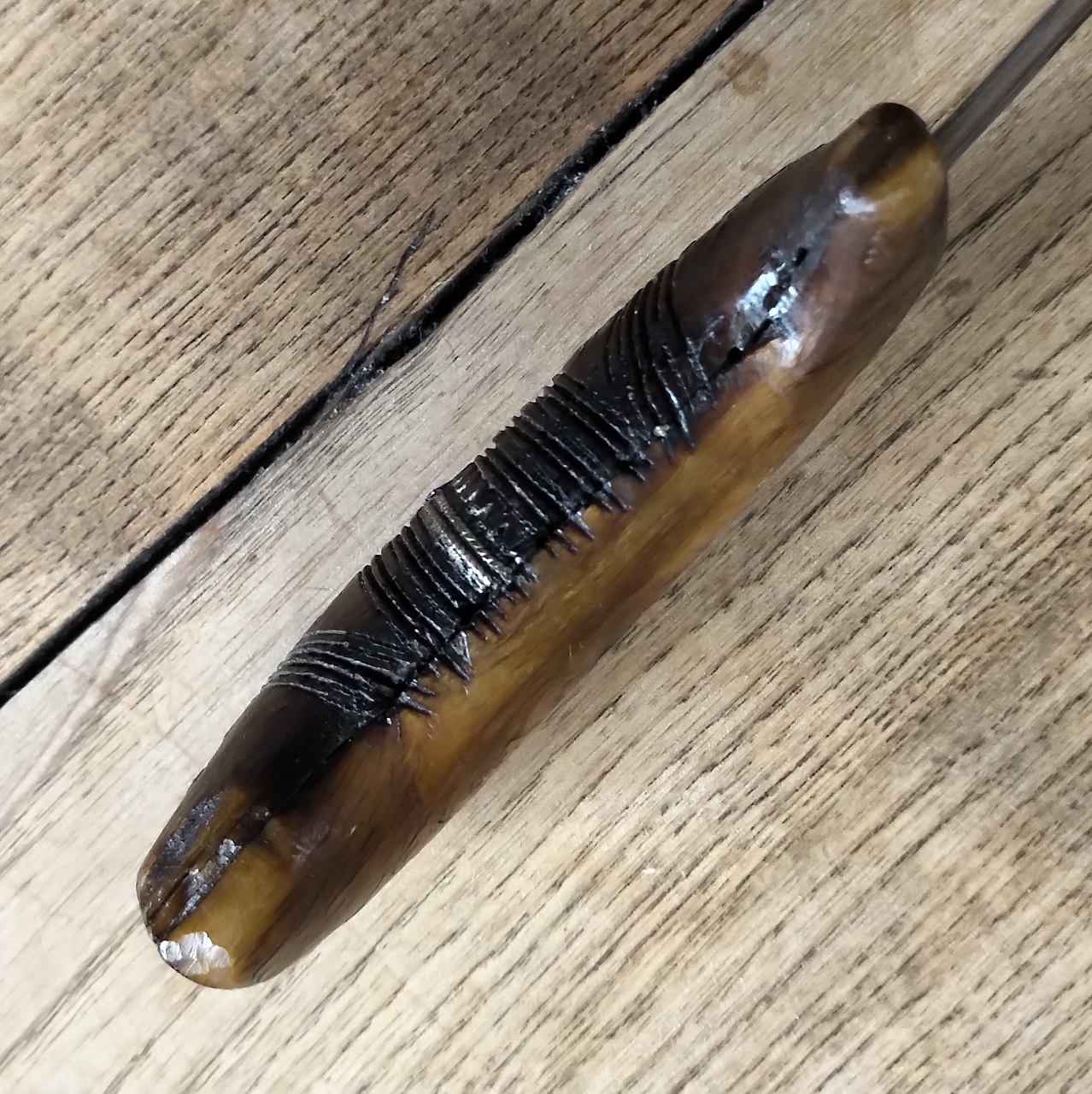

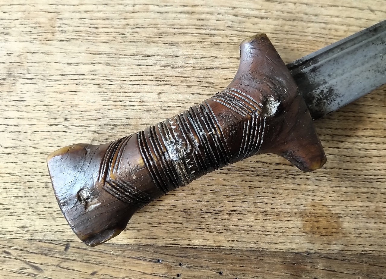

As always, the hilt is made of two pieces (or scales) of horn, riveted to the tang. I noticed that the shape of the hilt is assymmetrical, the piece that sits in the palm of the hand is thicker and rounder, while the finger lay on a flater scale ; it can also be noted that the scale adorned with grooves, originally filled with twisted latten wires (there is a little bit left), is the one that sits in the palm of the hand. Whether this design is intentional or not is up to debate, but it is sure that it provides an excellent grip on the weapon, reinforced by the « H » shape of the hilt itself that locks the hand in place ; it would be interesting to determine if those design choices are also found on other sboulas …

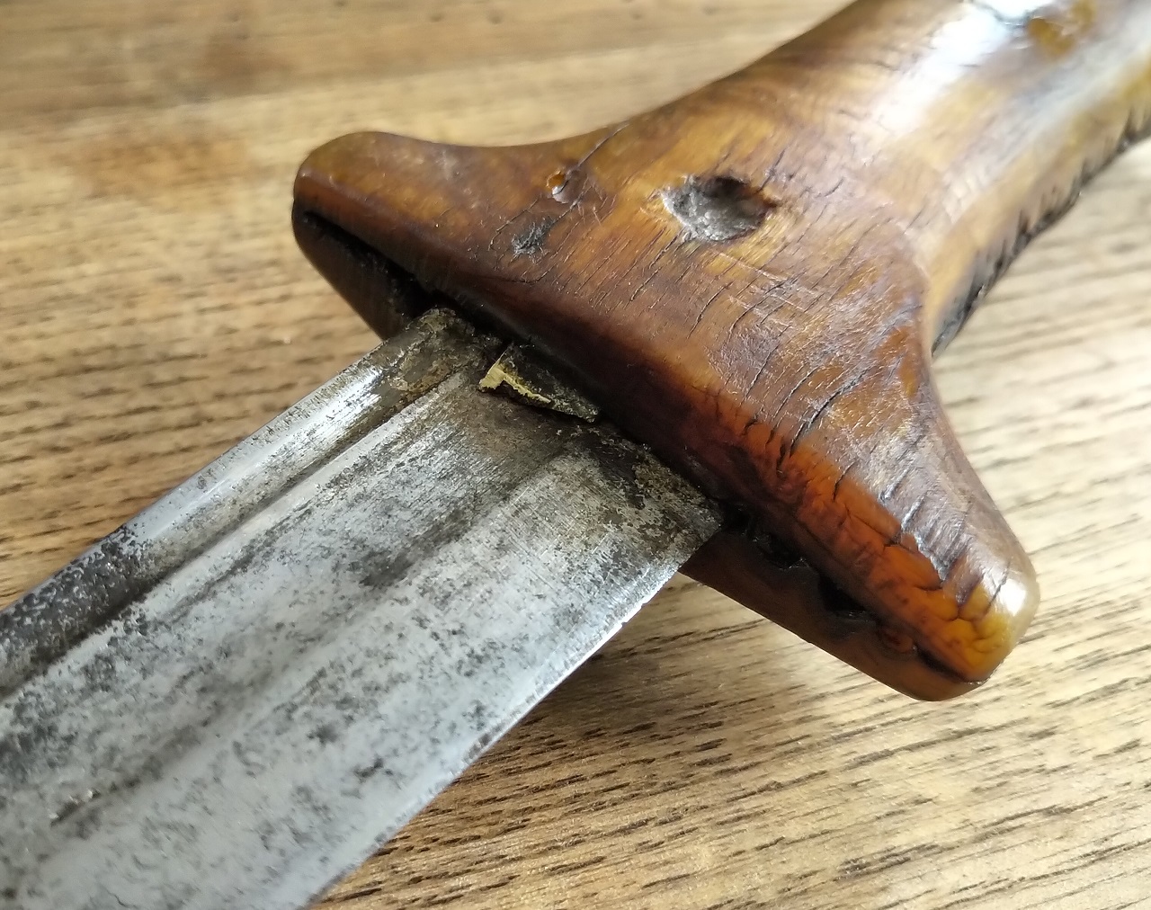

Moving on to the blade, I noted that it was stabilized with a small latten wedge under the guard to avoid any rattle ; interestingly, this is really similar to what I've seen done on original medieval sword for the same purpose, it also makes me think that this sboula was intented to be used, as the fix is rather crude and would have no use on a purely decorative weapon.

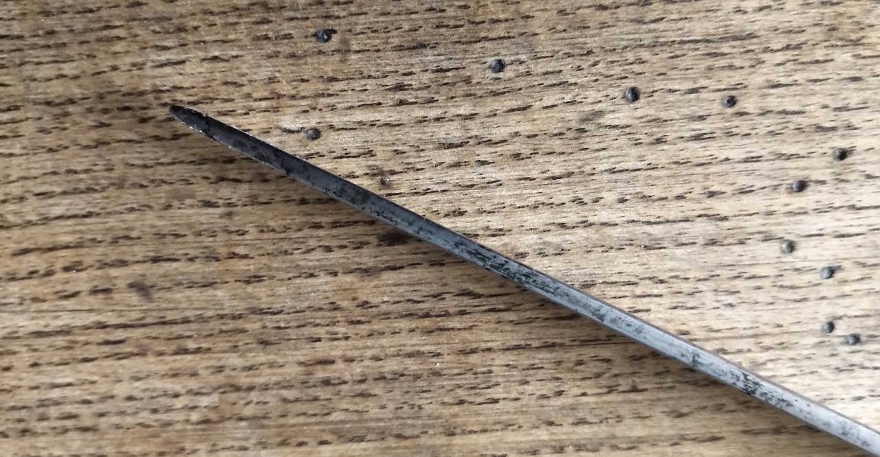

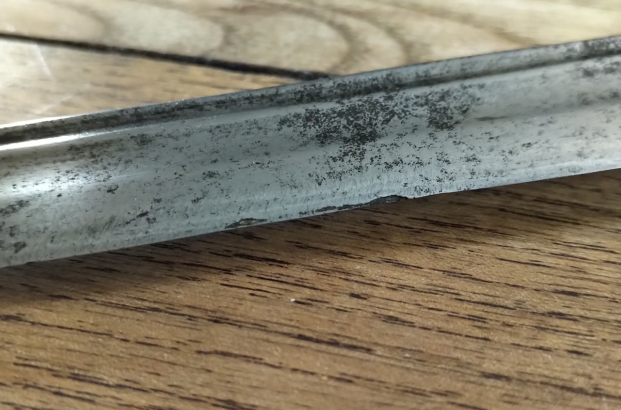

The blade itself is most likely a repurposed and reprofiled european saber blade, considering the regularity of its shape, and the fact that the point of the blade remains really thick, as if it had been shortened ; we can also see that the fullers continue under the guard (although the horn was shapped to fill them). However, even if I don't think the blade to be local, the reprofiling is, in my opinion, really neat and was done with a lot of care. I think that the original blade might have some age, as it shows traces of delamination on its edge (so maybe pre-1850). The edge itself is still somewhat sharp, and shows what looks like to be two old impact traces near the guard, again making me think that this sboula was probably used.

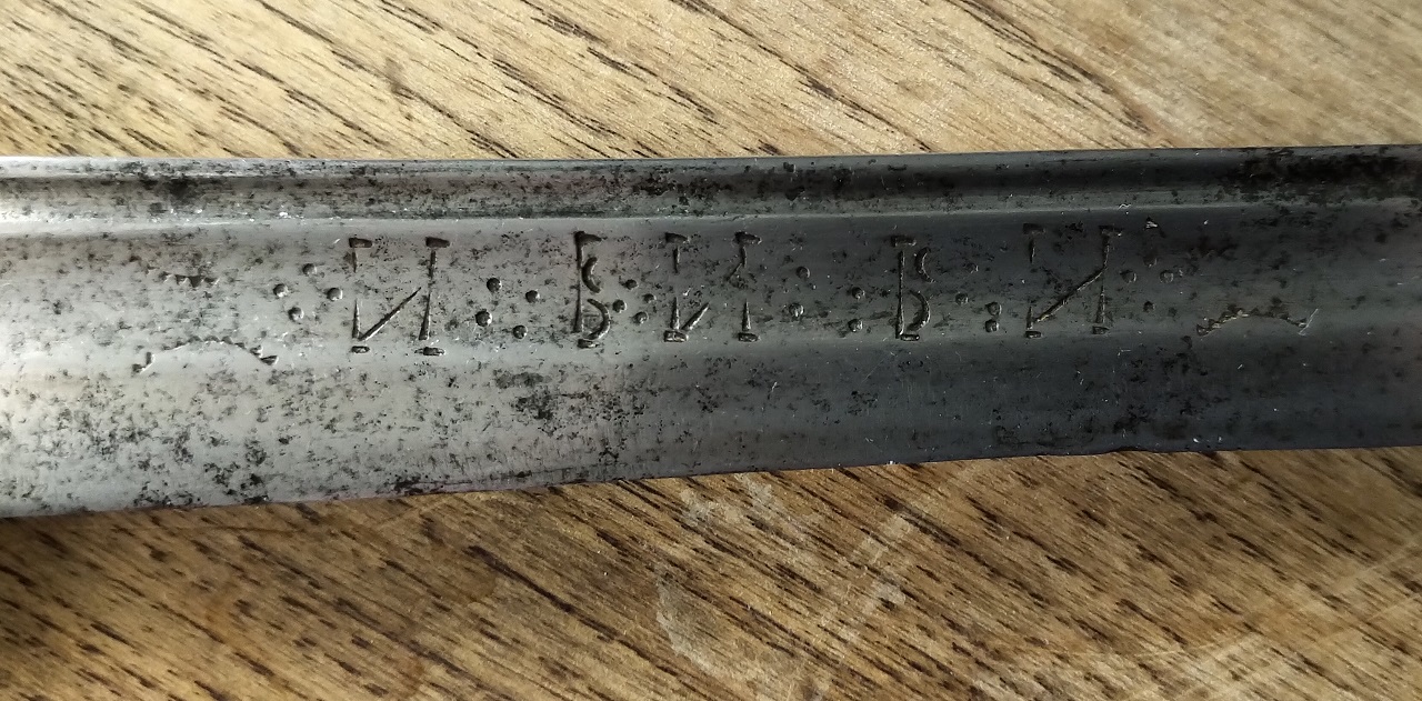

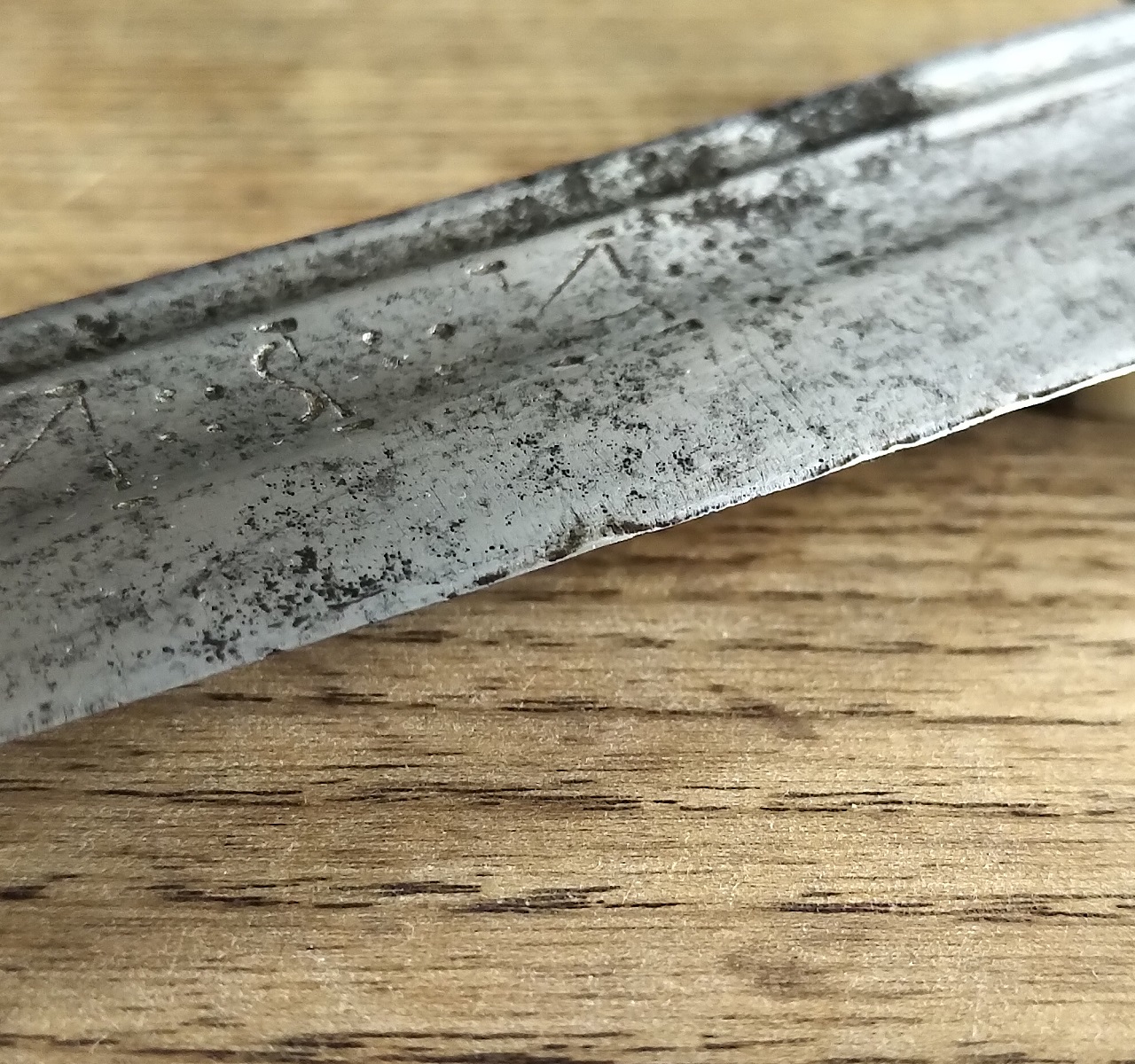

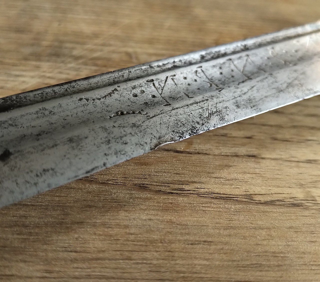

The blade also shows, on each side, the usual imitative illiterate markings (proof of quality, apotropaic phrase or something else ? I'm not really sure about this to be honest …). Here, it seems to be a repeat of two letters (« N » and « B »?), separated by groups of four dots, and flanked by two pair of eyelashes.
Full lengh is : 54,5cm
Hilt lenght is : 11,1cm
Point of balance is : ~8,8cm away from the guard
Weight is : 262g

Nice sboula Yvain, and some pretty good observations. If you search the forum you will find blades with similar letters that do not make sense or symbols that resemble European letters. My guess is that those were placed locally, in order to imitate markings on earlier European blades. The gurda marks may be original to the blade or may have been placed later locally as well, hard for me to tell.

Do we have any idea why those european markings were being copied ? Did it gave the blade more monetary value, or did it have some symbolic fuction ?

Native copies of European markings is a big topic. The short answer is that European markings became popular in various places around the world where European blades were exported to, and were later copied locally in an effort to signify quality.

But the blade is good, I wonder if it's an old sword cut and reused.
About the inscription I agree it's a pseudo European script, some people think that it could be some berber script, but I can't recognize any letters...

Indeed, I think the blade is a cutdown european saber, and I'm pretty sure that the pseudo-european marking doesn't have any meaning and is just imitative.

I'm pretty sure it is indeed a reprofiled european saber blade. As for the inscription, I don't think it has any meaning either.
