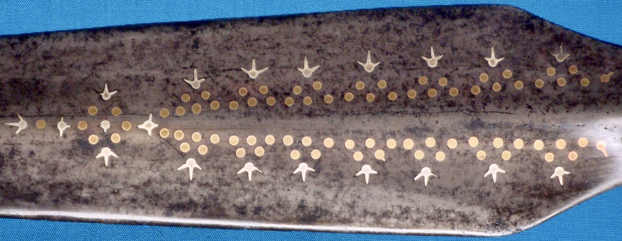

Greetings folks.
Here is the only Bagobo datu spear I have. I just finished restoring it based on research from old pictures and Krieger’s work.
The blade is steel with silver and bronze/brass dots. All of the silver inlays are reminiscent of Moro datu kris blade work.

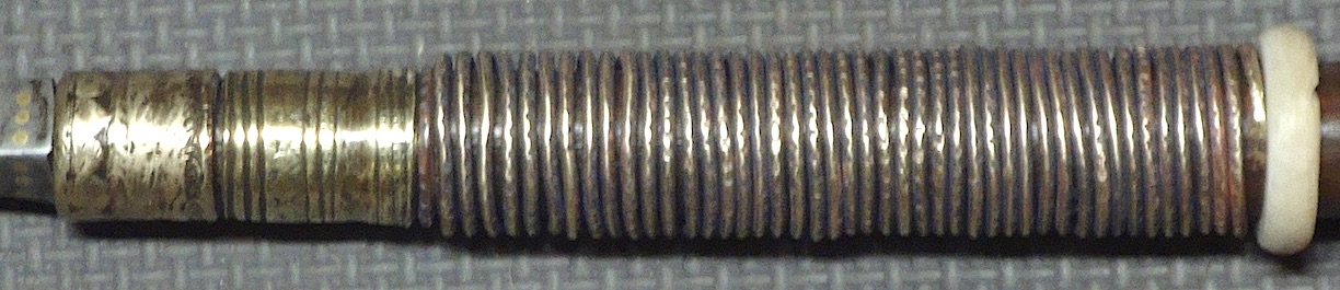

Beneath the blade are a bronze collar with worn down spirals and a brass collar with “figures” chased in it. Below all of that is a section of brass hammered wire, held at the bottom with a bone ring.

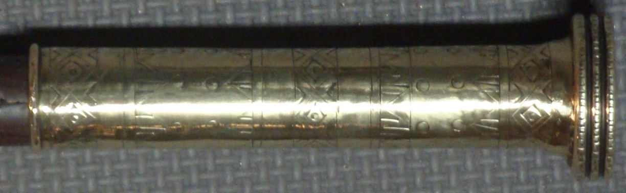

At the distal end the spear was split and I glued that, then made the Bagobo figured brass sleeve with a hammered cap at the end.

Do the silver as well as the brass inlays have central dots from another alloy? Could you take a close-up, please?

Hi Kai, I hope this picture is what you were asking. The only metals that I can find are silver (more like a sterling silver of around 90-92% silver and 10-8% copper alloy) and brass/bronze. No other alloys are present.

After re-reading your question again, I now understand better. The round/middle parts of the dots and inlays are the same. The color differentials are from lighting and the effects of etching. I etched the blade just in case there was a pattern in the steel (and yes it makes the inlays pop out better).
