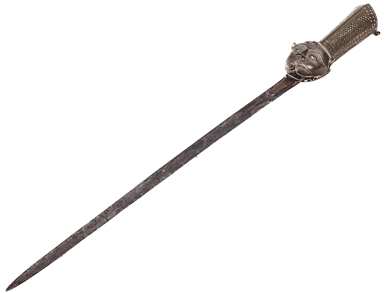

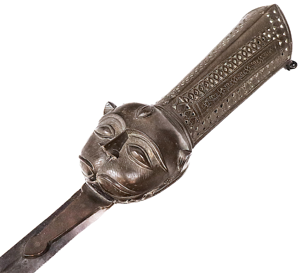

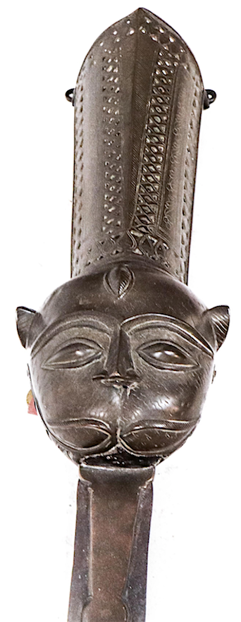

This pata example I acquired over 40 years ago, in circumstances which are somewhat intriguing, but irrelevant. In those days of my collecting, naturally I saw this as a fascinating ancient Indian sword.
Today, it is clear that while it in indeed a 'pata', it is likely a fabrication from Victorian times at best, and likely intended for use in Mahratta festivities and martial arts exhibitions. These demonstrations are using these in pairs and in the windmill style slashing in which they were most typically used in warfare in the 17th-18th centuries by Mahratta warriors. These were apparently termed 'dandpatta' in the Mahrathi language.
While it is known that these pata evolved in Mahratta regions in Central India in about those times, the origins of this form of transverse grip gauntlet sword may be of far earlier antiquity. In iconographic sources as early as 12th century there are ambiguous suggestions of these forms of weapon, as seen on the 'hero' stones (viragal) which are monuments to fallen warriors.
Naturally we cannot look into the 'pata' without considering its dagger counterpart, the katar. These push daggers seem to have evolved likely in the Tamil regions of S. India during Vijayanagara Empire and evidenced to about 14th c., again iconographically.
These examples were of the 'hooded' form which like the pata, had a gauntlet covering the hand over the transverse grip.

Returning to my example , the blade, well worn, has the central triple fullers resembling those found on kaskaras, and with the astral symbols (sun, moon etc) and as noted has clearly been sharpened down over many years. The metalwork resembles such work in India in items of Victorian period, thus use of very old blade, European, mounted into a likely traditional ceremonial item.

Returning to the example pata of the original post. This example was acquired from a well known dealer, collector who was a most unusual character, and his acquired holdings and holding were almost legendary in the arms circles of the times nearly 50 years ago.
I knew little in those days on Indian swords, but this thing was compelling!
In ensuing years I learned more of course, but knew this humble example paled next to the amazing examples I saw posted through the years.
However, in looking at it now, through very different eyes, with at least nominally more knowledge, I realize there is far more to this weapon than I had previously realized.
It appears to me that the blade is European, most likely German (Solingen) and of early to mid 18th c. Though the triple central fullers remind me of the familiar broadsword blades found in Sudanese kaskaras of the 19th c. We know that huge volumes of these blades from Germany were coming into the North African sphere from 1830s onward. It is believed that many were actually produced by Solingen later in the 19th specifically to the markets in Sudan.
With this blade however, I once thought it was in fact a kaskara blade, which had somehow ended up in a traditional pata type hilt later in 19th c. likely for ceremonial martial arts ritual and performance by Maratha men.
After seeing this sword again after many years, I think this was likely a German blade which ended up in probably an Indian firangi at some point in the 18th c. I could not see why a well worn kaskara blade would end up in India, also the central fuller extends virtually the full length of the blade. While obviously some kaskaras have this, these seem typically European.
It seems by the irregular edges of the blade, well worn by vigorous sharpening by individuals using stones rather than sharpening properly by armorers with proper equipment. IMO this suggests actual use in the native element and over considerable time. The astral symbols, typically sun, moon, star etc were at the forte, only traces can be seen, mostly obscured by the bolsters riveted to the blade.

Your pata seems a little unusual in orientation to me. The grip and forearm protection appear to be at a distinct angle to the orientation of the blade. If the blade tip pointed upward when held, it would appear to have been made for a left-handed person. If the tip pointed down, then a right-handed person. What do you think?
Also, the smiling moustachioed face on the guard is a representation that I have seen during my travels in Ghujarat (NW India). Perhaps it is more widely distributed also. The round face was depicted on a palace gate as the Sun with the face of a Rhajput warrior.
Ian.
Old 23rd May 2025, 02:30 AM   #7
Posts: 10,872
Thank you so much Ian! I was afraid I'd be solo here, I know this stuff is a bit esoteric and not much interest in Indian arms since Jens left.
Very astute observations, and honestly I had not thought of. Actually I thought the canted blade was just lousy mounting job. I also never noticed the lines which indeed might suggest facial hair. The face reminds me of a Buddha.
There were other suggestions of the Indian pantheon it seems some years ago.
I cant tell what this type of metal is, but seems like a bronze/copper ? alloy.
What you note on the Rajputs makes sense, as their clans focus a lot on sun oriented symbolism. I really appreciate this Ian, gives me whole new perspective on this, which I like better than the ideas I had resolved to from further south.

Jim, thank you, you are right, this object is from a "living" culture and was used as a weapon in traditional martial arts. And if the handle is new (19th-20th centuries), then the blade, as you pointed out, has a much longer and more complicated history.
The pata sword was not only a weapon of the Marathas, but much more often a weapon of their opponents: the principalities of Rajasthan and the sultanates of the Deccan, and was also used throughout the rest of India.
I was interested not so much in the "face" on the handle (usually it is either a stylized image of a tiger or a person; in the case of a tiger, these would be the animal's ears, and in the case of a person - mustache or a third eye), as in the image of Garuda. This is a rarity in medieval and modern India - the cult of Garuda is more common in Nepal and Southeast Asia. This allows us to localize your object in South India, where the cult of Garuda has survived to this day as part of the Vaishnavism tradition. And this cult is directly connected with the warrior traditions, although to a lesser extent than the cult of Hanuman: in the South Indian kingdom of Hoysala there was a group of the bravest warriors, especially devoted to the ruler, who were called the Garuda warriors (Garuda served Vishnu as his vahana, so these warriors served the king).
Thank you for sharing this unusual item!

It is very possible. Usually in akhara, kalari, festivals and ceremonies any weapon made recently and even from aluminum or something else is used. So in the case of your sword, such a combination of a real (not flexible, like most modern pata) and "very ancient" blade from the point of view of its owners in the 19th-20th centuries, and a handle with the image of Garuda may not be accidental. The image of Garuda is not just a decoration, especially on a simple weapon made not for sale, but for martial arts or fests. It is a sign, a symbol. It means that there was a semantic connection between the martial traditions and the cult of Garuda in this region for hundreds of years, which in turn means that your pata also comes from a warrior culture, regardless of when it was made. The main thing is that it lived in this culture. Not every item in our collections can boast of this.

Very interesting sword of yours Jim. The hilt is late of course, made at a time when they were being made as curiosities. That however does not mean that this would not have been used by a soldier/retainer in the employ of numerous kings and landlords in the Deccan probably. There is a Pata with such a Tiger face retrieved from Seringapatam but it has no 'tipu/tipuesque' features and would have come to his armoury from somewhere else.

Hi Jim:

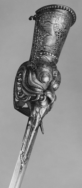

Just to show that your example is not unique, here is one that finished at auction yesterday. It looks similar and the face appears to me to be a mixture of cat (note the "ears") and human.
Ian.
Old 3rd May 2026, 04:21 AM   #19
werecow
werecow's Avatar
Join Date: Sep 2021
Location: Leiden, NL
Posts: 688
Could it be a Hanuman face maybe?
Old 3rd May 2026, 07:16 PM   #20
David R
David R's Avatar
Join Date: Jan 2011
Posts: 1,167
I was thinking Tiger head, and google lens suggested Tiger or Lion!
Old 4th May 2026, 01:59 AM   #21
Posts: 10,872
Thank you guys for responses!
Ian this is excellent and as you indicate, mine is certainly not unique. This is encouraging as it supports the idea that these distinctively decorated hilts may be to a Garuda oriented warrior cult.
As suggested earlier, perhaps these hilts are paired with venerated blades, typically older, and possibly these blades were significant as having belonged to noted warriors (much as the monuments made for them).
Often the hilts can also be older, as this one which is 17-18th c. and much later blade.
In the case of this example, the figure depicted in the hilt is a makara, which was also associated as a vishnu of Garuda.
