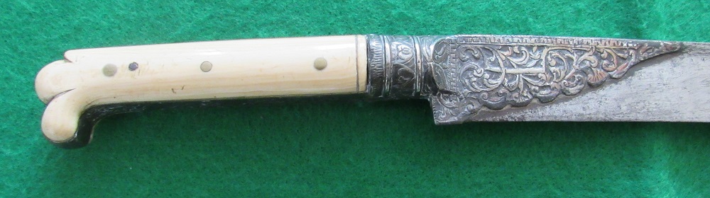

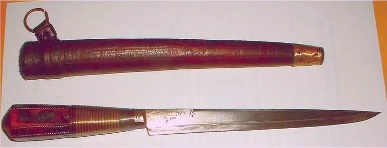

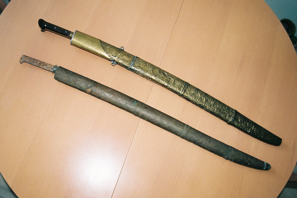

Time to play the yataghan ID game again. My guess is North Africa - while not a textbook Algerian example, there are quite a few features that make me lean that way:
- Small, trilobate years;
- The hilt material is from African fauna as opposed to Arctic fauna;
- The wooden scabbard encased in brass sheet has decoration that is not of any style associated with the Balkans;
- The scabbard chape looks like it was fashioned out of a thimble and is very similar to the scabbard chape on a flyssa I have;
- The addition of a baldric loop to the scabbard is also not something one would see on a Balkan yataghan scabbard.
This does not mean the yataghan was not made in the Balkans. In fact, it probably was, but with the intent to export it to North Africa, where it received its scabbard and maybe even its hilt.
Now you know what I think about it, but I am always interested in the opinion of the other members here.
Teodor

I vaguely remember that Elgood mentioned Balkan masters exported blades. It ring true: the rest was much simpler and correctly ethnic.
I showed here once mine: agate handle ( one side lost) with small real gems and wootz blade. That one likely was done in N. Africa in toto.

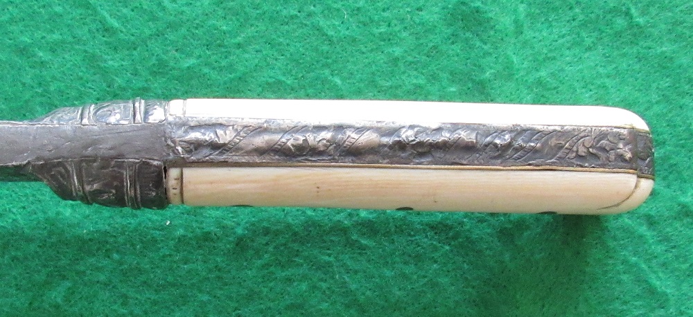

I think the handle is a later replacement, not sure when but I am confident that the original handle on this yatagan was a silver one. Sliver handles are prone to damage are easier to fall off than horn or ivory ones. Sometimes people would repacked them with whatever the regional taste was at the time. This one must have been replaced in North Africa as the style suggests. The scabbard also is a later addition to compete the restoration of the nice blade yatagan.

Sfenoid and Jim, thank you for your comments. I agree that the hilt is very likely a replacement and of course, there is very little doubt the scabbard is. It is quite possible that originally the yataghan had silver mountings (or tin guilt with silver).
As for flyssas, I do think the shorter versions that are closer to yataghans in shape and size were most certainly intended to be functional weapons. They just were not as well made. Part of it was the skill level of the Kabyle smiths, and the other part was the attempt to make the flyssa into a cut and thrust weapon, sacrificing the excellent chopping characteristics of yataghans for the addition of a pointed tip and a more rigid blade.
