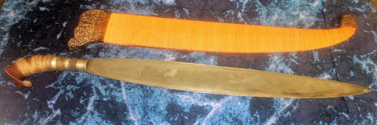

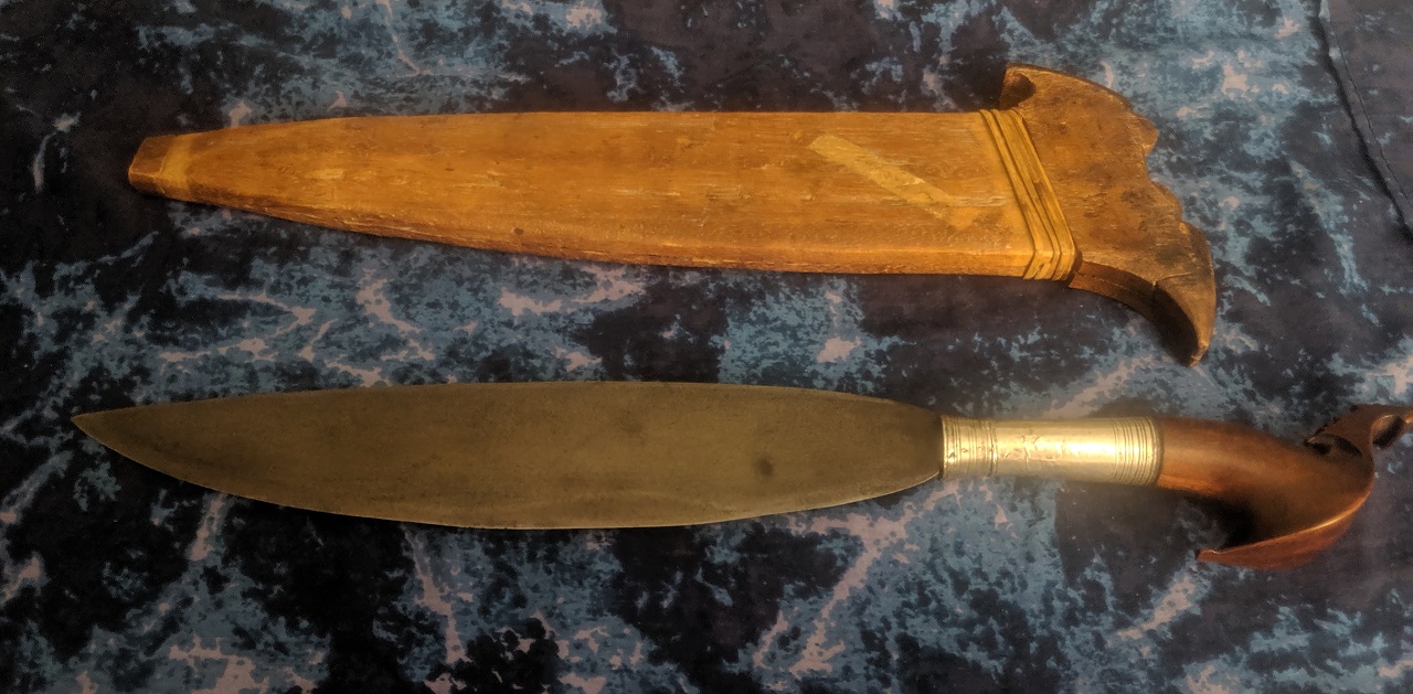

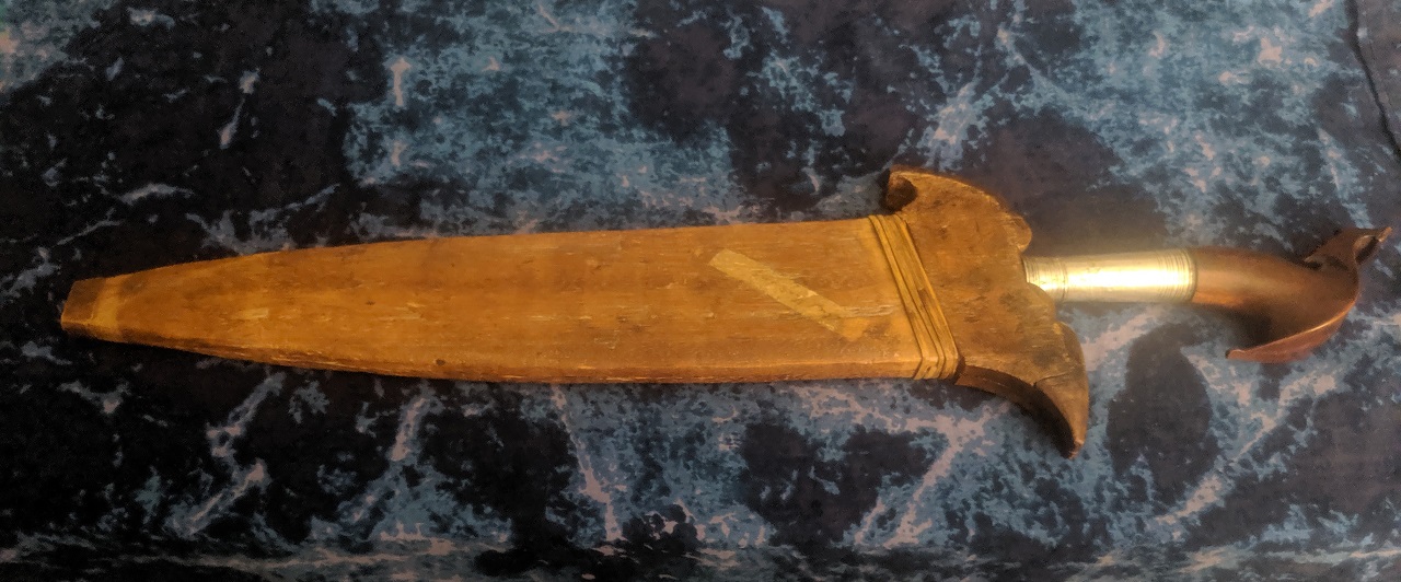

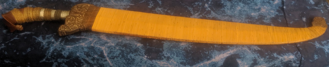

I've attached some photos of the two barongs to this reply. I really do think that they are quite beautiful, and I hope that y'all enjoy them too! I'll see what I can do about getting the keris up on the other forum.

Two nice looking barung which appear to have some age. I think the second (smaller) is probably late 19th or early 20th C, and the larger one is probably a little later with a scabbard from about the mid-20th C. The blades show a nice laminated pattern.

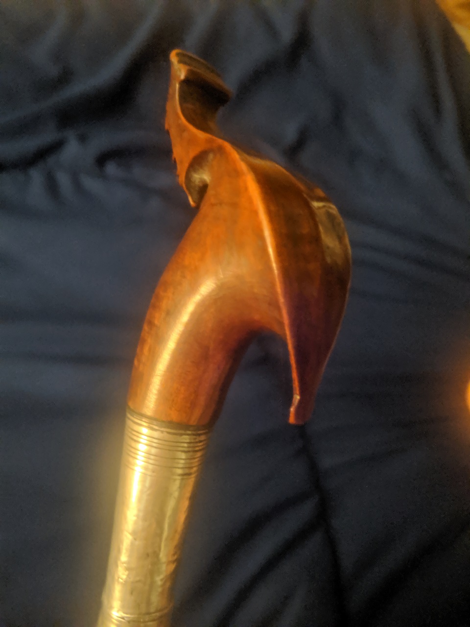

It would be helpful to see the hilts in more detail to get a better idea of age.
Ian.
Old 11th September 2019, 11:06 PM   #7
Posts: 7,421
I agree with Ian and will add that the first one seems to be Samal tribe. The second one needs to be flipped over and pictures taken of the from of the scabbard as well, though I am guessing from the profile it is Tausug tribe on Jolo Island.

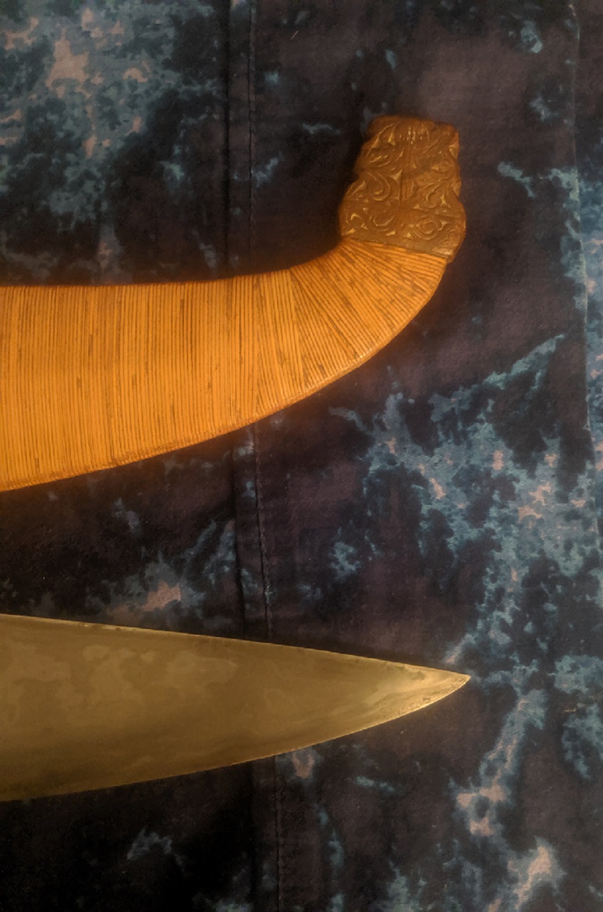

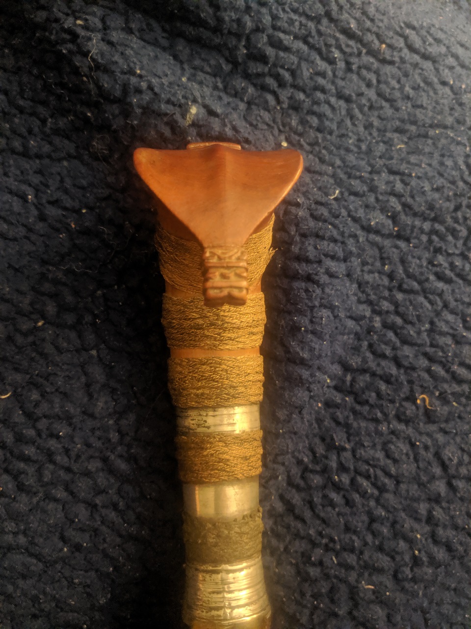

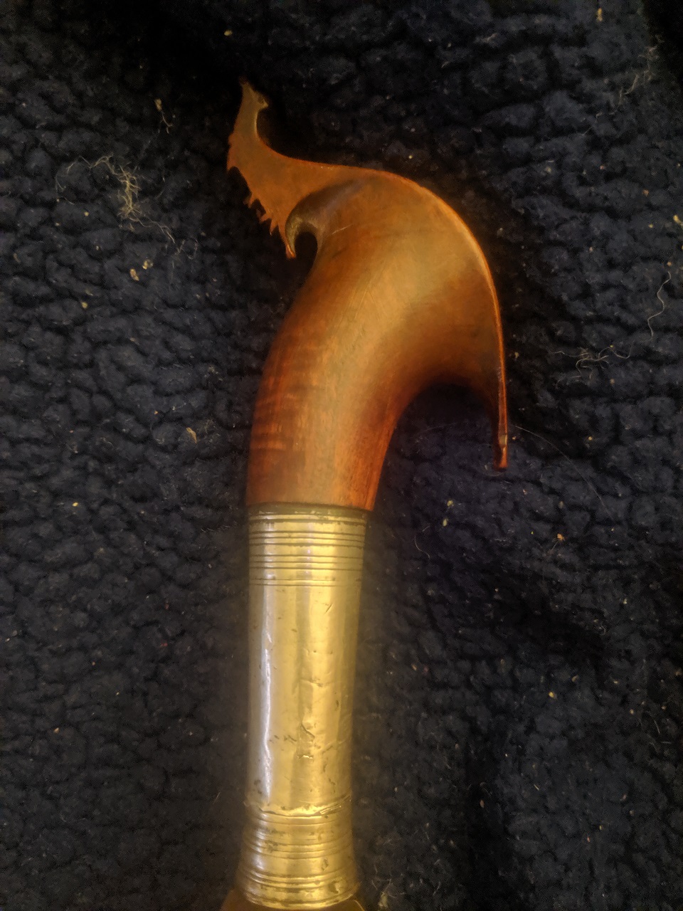

I really appreciate the input. What are some of the indicators that y'all are looking for as you're making your estimates on their age and island origin?
The dimensions were provided by the gentleman who sold me the blades. The longer one is 28 inches overall, with a 20 & 1/2 inch blade which is 5/16th of inch thick at the base of the spine. The smaller one is 22 inches overall, 11 & 3/4 inches in the blade, and is a 1/4 inch thick at the base of the spine.

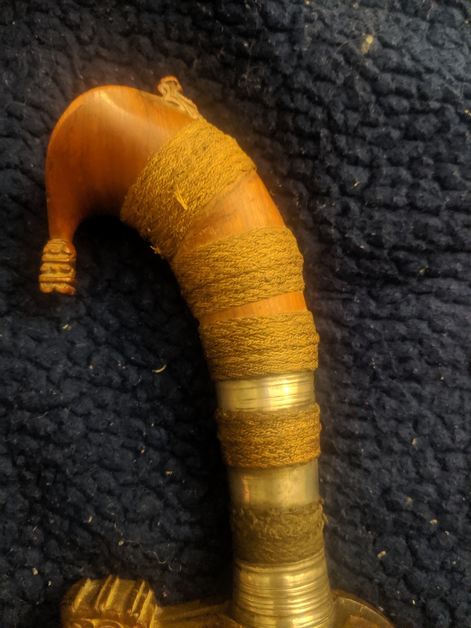

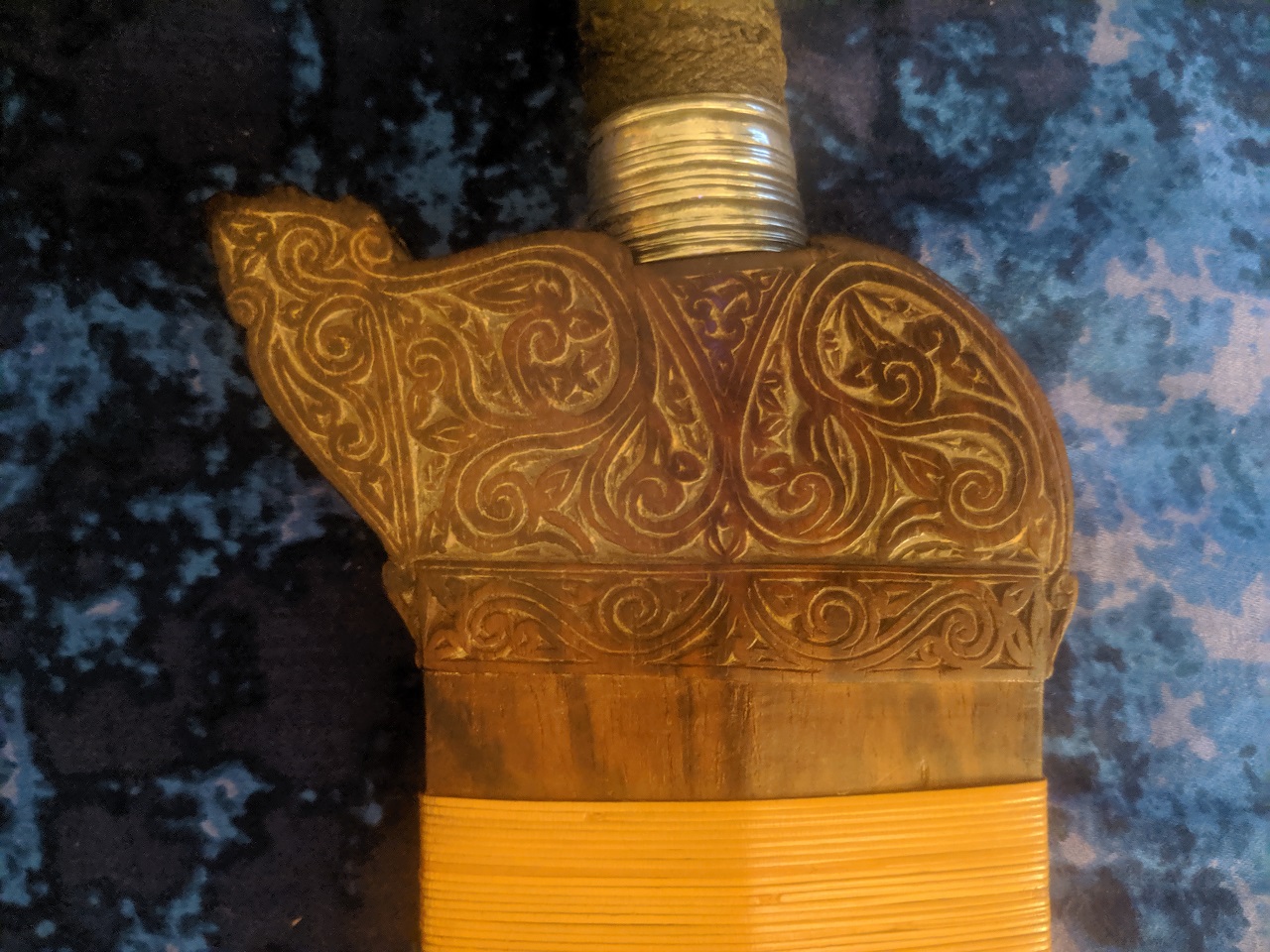

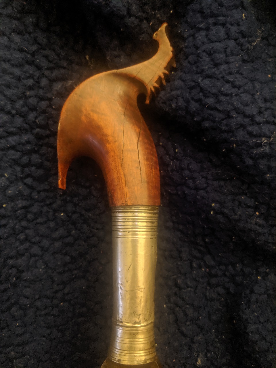

I've also added more images of the hilts. I'm quite happy to keep taking and uploading pictures to keep the discussion going.

For the purposes of discussion, I'm going to call the first barung that you show in Post #4 of this thread, Barung A. This one has a hilt with a silver punto (ferrule) overlaid with woven strips of jute, and a small kakatua pommel with a very minimal "crest" arising from the rear of the hilt.

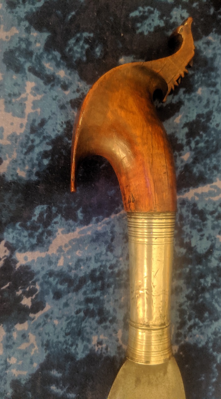

The second one will be Barung B. This one has a silver punto also (but no jute wraps) and has a larger kakatua hilt with a longer "beak" and larger flowing "crest." The carving on this pommel shows graceful lines and curves which one associates with more prestigious pieces such as a datu barung.
According to Cato, the more integrated, flowing style of kakatua hilt (Barung B) is older and was prevalent on hilts made before 1900, while the appearance of a crest erupting from the back of the hilt (Barung A) came somewhat later (maybe 1920 or so), with the two styles coexisting from the early 20th C. In my opinion, the older style never died out completely but became less common post WWII.

There are other features of the hilt that warrant mention. A silver punto offers a rather slippery grip, especially when blood is present. The woven jute strips provide a better grip of the hilt and suggest to some observers that barung with such hilts were intended for, and actually used in, combat while the plain silver versions were more for show (although no less dangerous as a weapon).
Your Barung A shows wear and discoloration of the jute wraps, with a pattern indicating it was handled quite a bit. Compare the condition and color of the wraps closest to the blade with the more distal wraps. This one appears to have been a "user."
One last comment on the type of wood used for these hilts. A common material is banati wood which I think both of your examples show. This has an interesting grain and often exhibits chatoyance when polished or wet. I think the hilt of Barung B is looking dry and cracked. It would benefit from feeding with teak oil which may encourage some of the cracks to close. I would let the oil sit for a few days, then wipe off any excess before applying some wax, such as Renaissance Wax, which can be buffed with a cloth to a nice shine and will show off the grain well. I would also give the silver punto a gentle polish.

To my understanding is that the barong with the large "tail" is for a datu common usage.
Part of my basis for the other barong is not only the hilt, but also the style of the ukkil floral motif on the scabbard.
