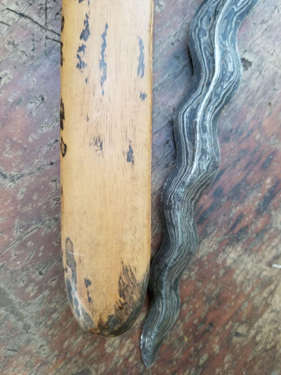

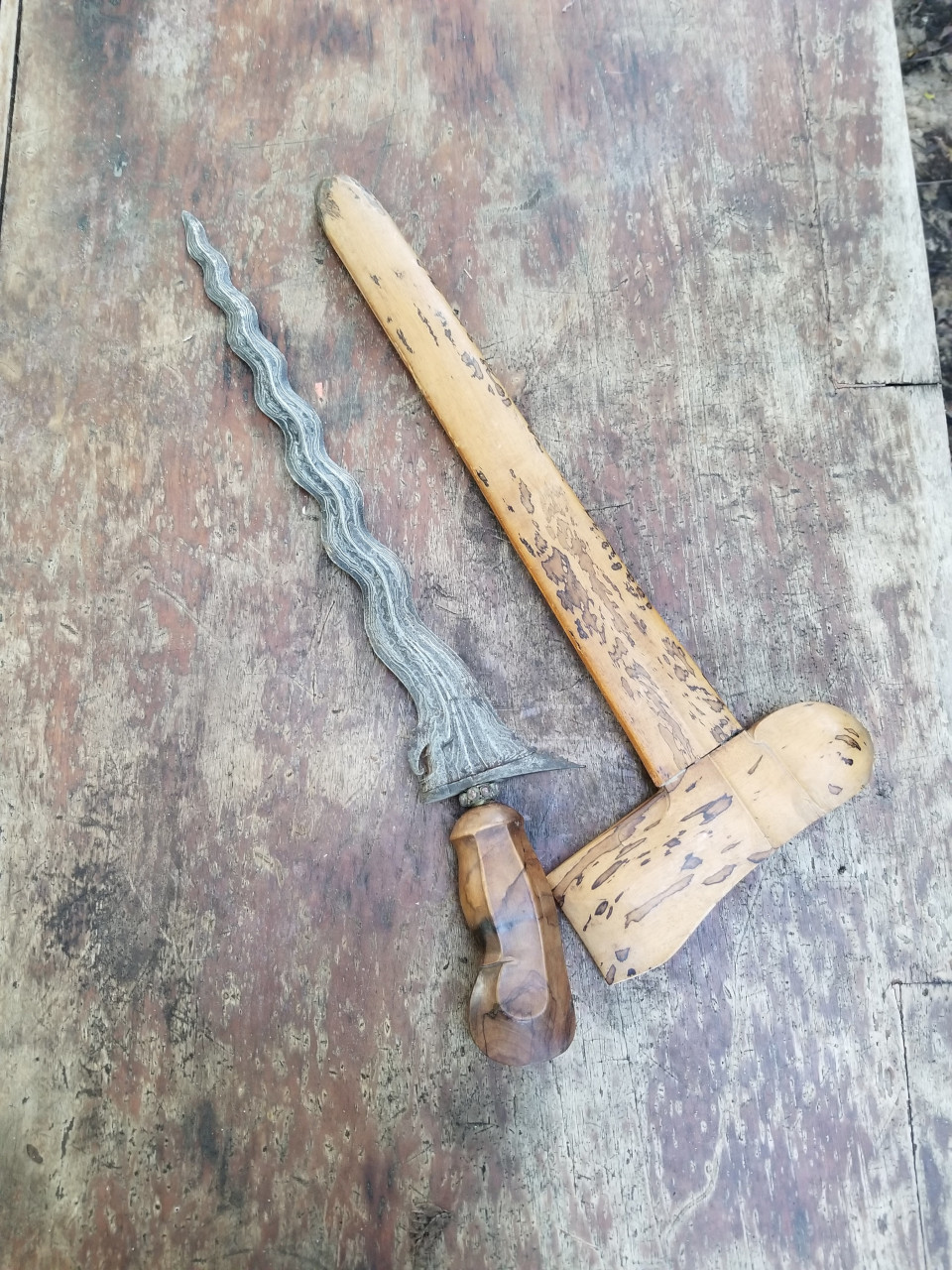

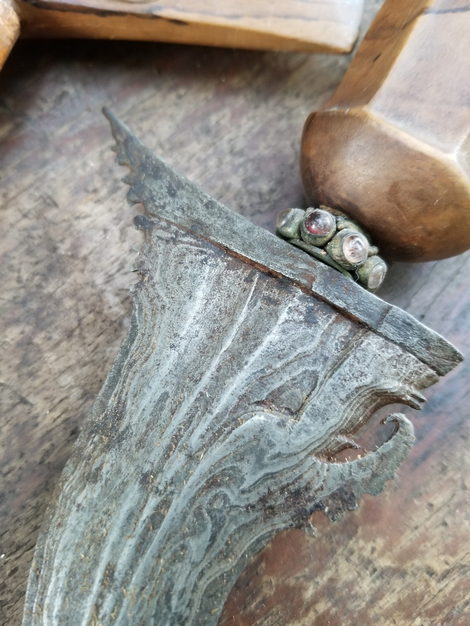

Hello! I've just purchased my first keris. Can anyone tell me what the pamor is and it's magical meaning? I've looked through examples of pamors and to my eyes it looks like it could be one of three. Are there any signs that this is a pre-WWII blade? I want one that was smithed with rituals.
I slept with the keris under my pillow to perform the 'dream test'. No bad dreams, but the scabbard broke where it was glued. There isn't anything wrong with the hilt but it fits my hand very poorly. The mendak is really beat up.
If the blade is worthwhile I'll seek high quality attachments, but if it is a mediocre blade I'll look for mediocre replacements. I really like this blade. It has a strong aura about it. I really dig the pamor. But I don't want to 'overdress' it.

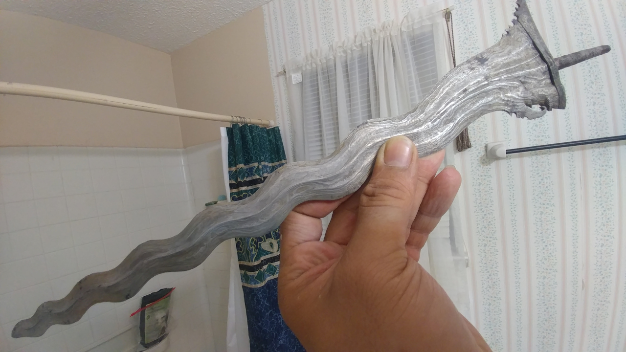

Attached are pictures of the seller's photos. The keris looks alright in them. It was was filthy when I received it, though. I didn't take photos of the dirty keris. I put some time in tonight to clean the blade. I've still got a while to go but much of the gunk is gone. Attached are some 'after' photos of my first cleaning. Parts of the blade have 'milky' appearance. There is some kind of translucent yellow/green.
Is my first keris an ok first buy? And what are the purported magical attributes? Any help would be wonderful. Book references and links are very welcome. I might make the keris a new hobby!

Firstly, this keris is presented in Balinese dress, but i am having trouble seeing it as a true Balinese blade. The greneng on the gonjo is cut rather poorly for a Bali keris and the gonjo itself does not look right and the sogokan do not seem to be nearly cut deep enough for Balinese standards. I believe the pamor is the standard Beras Wutah - scattered rice grain, but the blade certainly hasn't been treated in the typical Balinese manner of keeping the surface polished smooth. It is also a bit shorter than most Balinese keris of this era. I suppose that a Lombok origin is possible and i have seen Lombok keris in this particular sheath kekandikan style before, but i really can't be sure. I am inclined to think the blade may have a Maduran origin. Despite the obvious wear on this blade it appears more contemporary to my eye than older.
If you are concerned about "over dressing" this blade i personally would not seek any new components for this ensemble. The pelet timoho wood that is used is considered quite desirable and frankly this keris blade is fairly mediocre as Bali style blades go and does not require fancier dress. As for the handle, it isn't really mediocre per se, it is a very common Balinese bondalan form and i see no reason to change it. That it does not fit well in your hand should not make it unsuitable.
If this were mine i would cleanly repair the now broken sheath, clean up the uwer (mendak is a Javanese term) and re-stain if possible after fully cleaning the blade. A re-stain with warangan will do wonders for making theirs blade more attractive IMHO.
All that said, i would not consider this a "bad" first keris. I think most of us probably faired far worse on our first outing. What is always most important about any keris is that you like it. And just a warning...they are addictive! LOL!

This is a quite decent kris IMO and it looks to have some age, including the blade (see the rust between the gonjo and the base of the blade). The Lombok origin seems a fair assumption, the blade has 15 luks indeed and the pamor pattern is a standard one, may be identified as Beras Wutah/ Ilining Warih according to the Neka book. Is the blade fitting neatly into the scabbard? Like David I would change nothing to it except cleaning the blade and uwer, and repairing the scabbard if needed. What is the blade length?

The blade doesn't fit nicely into the scabbard. The angle of the blade base is too acute. As was mentioned earlier, the blade is short and the scabbard too long. It's not a bad fit, but it does bother me a little.
I'm happy it's a decent blade! Thanks for the identification. I'll keep all the parts as you've all suggested but I will be on the look-out for better fitting gear. The mendak really has to go, it's too warped.
