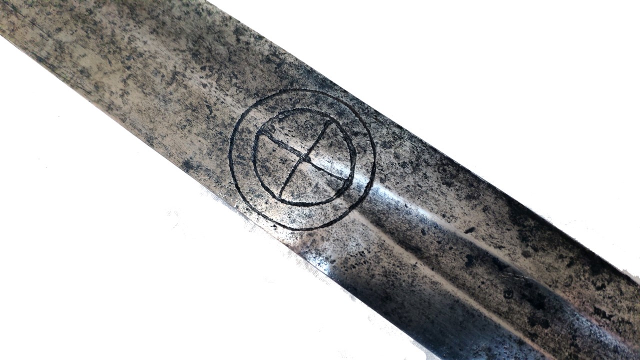

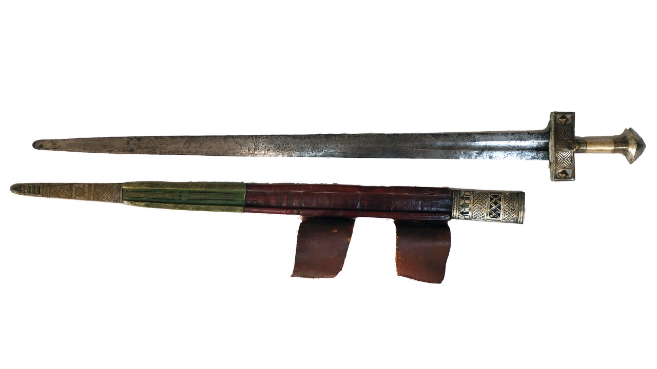

This is going to a good friend, but I managed to take a few pics today. While the hilt is a nice Hausa or Nupe brass one, with very complete scabbard and 19th century, the blade is the special part, European, quite old and marked with an encircled cross.
Thought the forum might enjoy it.

Thank you Iain, always nice to see that more of these takoubas with old blades are out there. How would you date the blade - 15th-16th century?

Hi Teodor,
Something in that range seems very likely, at least 16th id say. I'm not aware of the motif cropping up as a blade mark after.

These encircled crosses seem to date from as early as 13th c. (per Boeheim, 'Waffenkunde' 1890, p.674) as late as 15th c., however other references show similar circled crosses are known with double circles as late as end of 16th.
Some are the so called Maltese cross with flared ends and others have the cross fourchee (forked)ends
Boeheim suggests Italian origin for the marks, but as these marks were rather universally 'European' they were of course used in Germany as well. I am not aware of any particular significance of the double circle, but the use of it seems to end by open of 17th c. Crosses were used in many configurations and as elements of inscriptions etc.
I am curious about the rudimentary character of this marking and that it is placed partially over the end of the fuller, and that this is a cross quartering a circle, in the manner of the cross and orb in full contact with the circle. In the other encircled crosses they are encircled but not in contact with the circle.
Obviously the blade is old and European, but the marking, could it be later application? The cross in Saharan parlance is of course having to do with four cardinal directions, not religious or talismanic, but more symbolic.

Hi Jim, based on my experience this definitely is not locally applied and is consistent with European engraving. Of course I could be wrong! But I would be very surprised!

Iain, I agree, this does not look native, but perhaps the work of an entrepot worker ('artisan'?) . These blades entering the North African sphere may have had 'alterations' which enhanced value before being dispersed to merchants and caravans. While somewhat consistent with European marks, it seems odd in this quartered circle, but surely recalling the circled crosses which they were familiar with. That's just my thought, which is sort of somewhere in between European and native...…….the blade is of course European and quite old as suggested.
I still think of the beauty you got with the cross fourche in double circle.!!!
