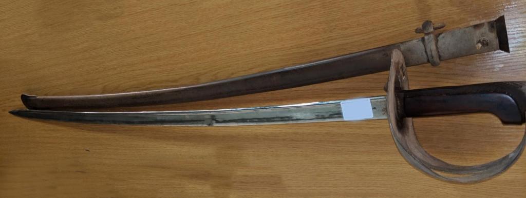

I have been looking to buy this sword but there seems to be very little info available online. What I did hear it that this type of pipe back blades were extremely flexible and practically useless at thrust.
I would be very grateful for any additional info about this pattern.
Here are some photos of the sword I was looking to buy.

The thumb guard recess looks distressed/broken.

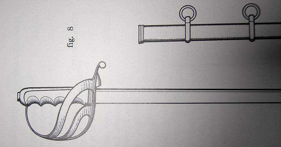

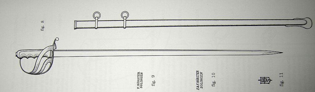

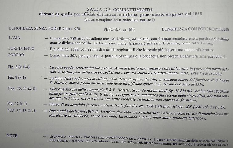

Here some fotos out of an Italian book "Alfredo Bartocci/Luciano Salvatici, Armamento Individuale dell' esercito piemontese e Italiano". Maybe it is of some use. At least it might be the challenge to learn some Italian language
