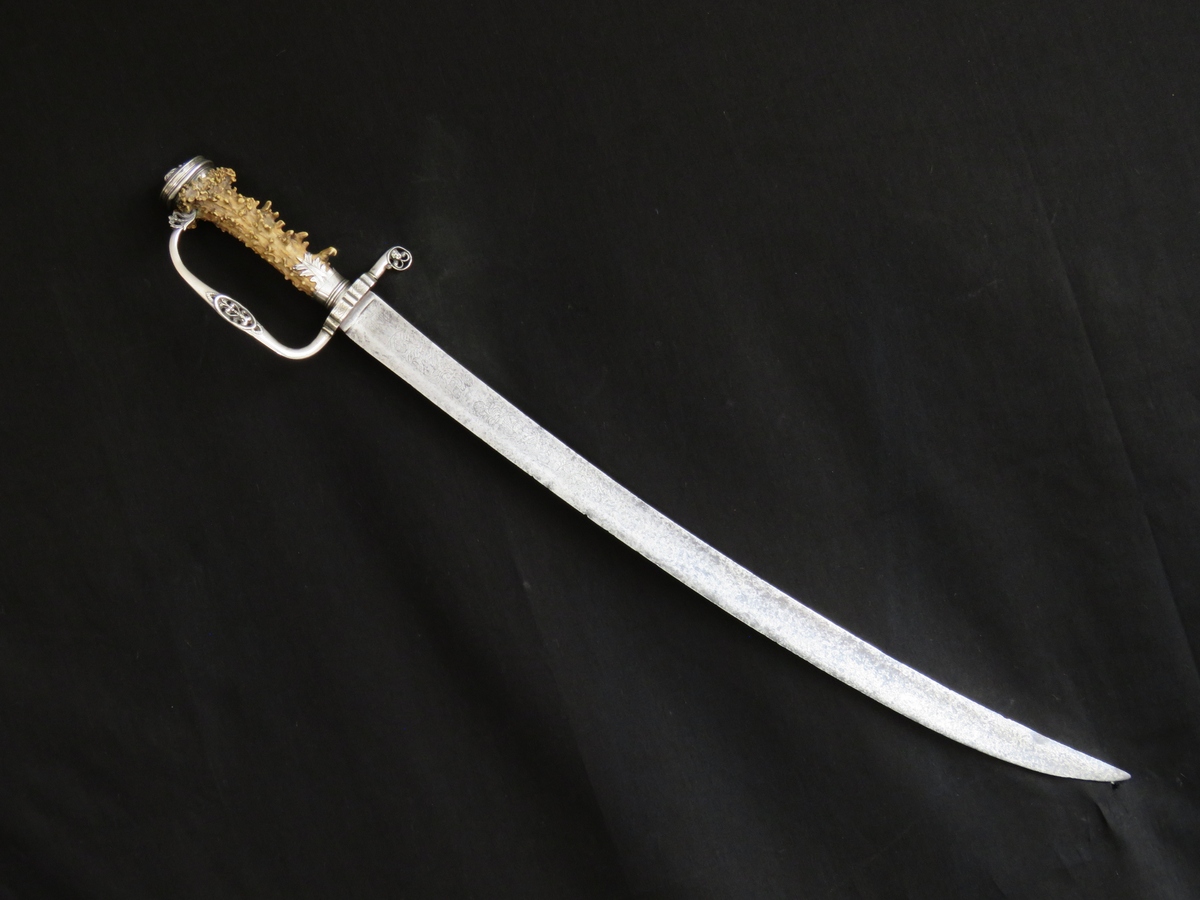

Default English silverhilted hanger 17thC

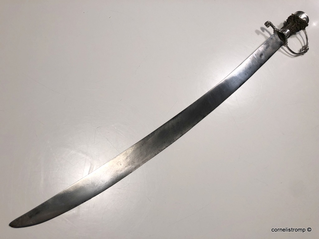

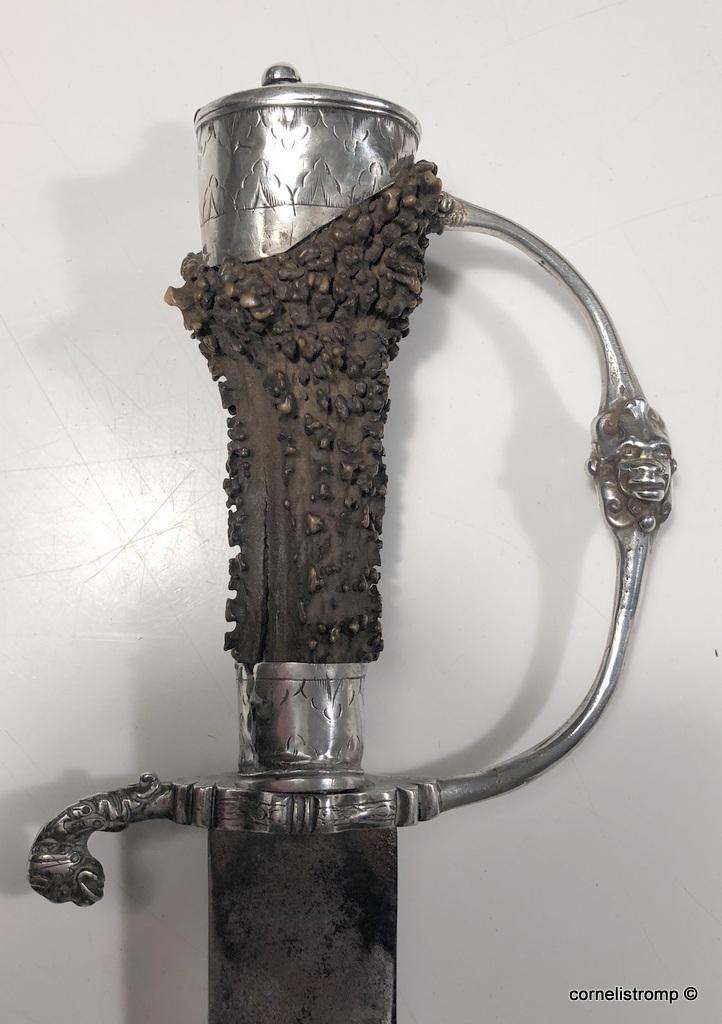

this silver hilted hanger does not fit in my collection that mainly consists of pre 1600 or clear Dutch, but it was too nice to pass up....unfortunately

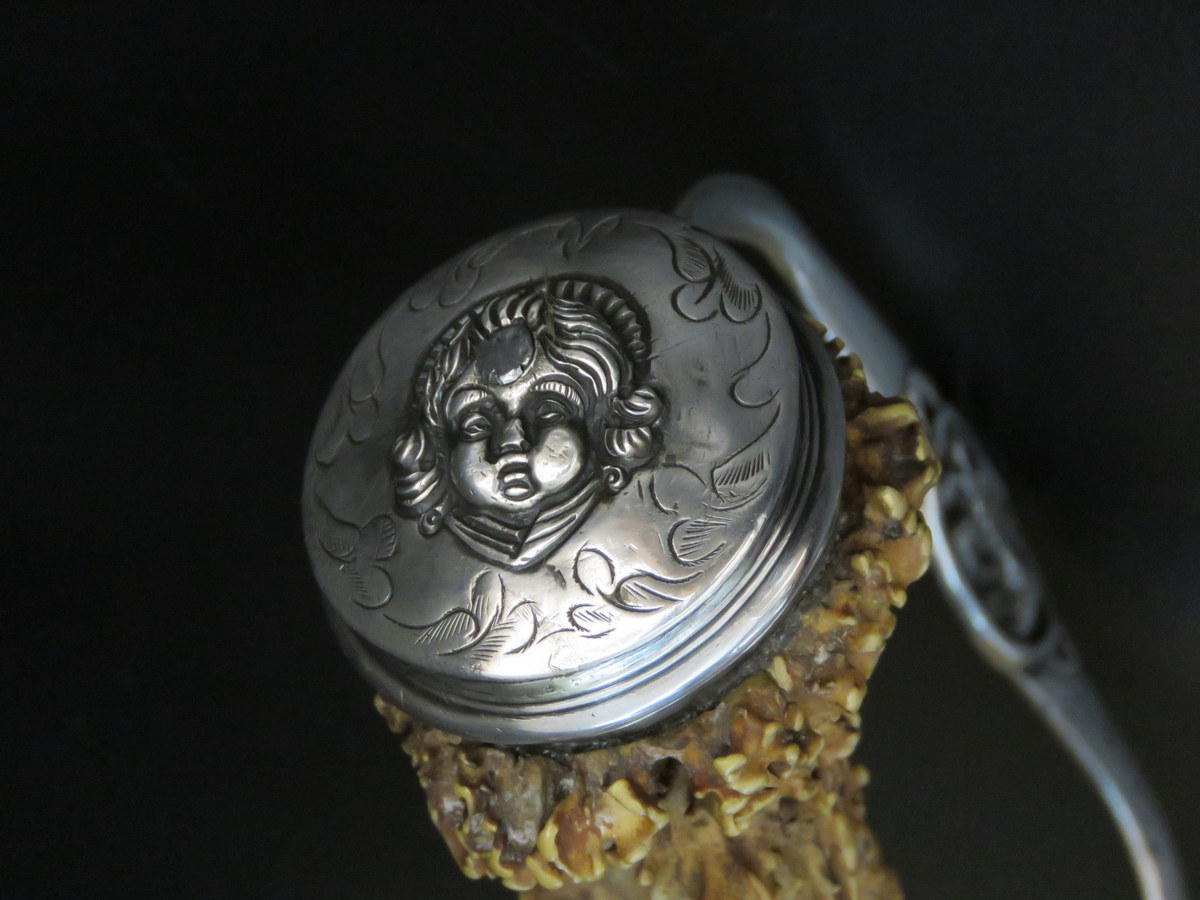

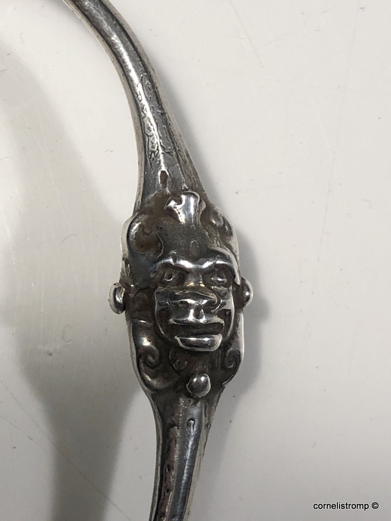

Jasper, that is an amazing hanger! Beautiful silver work and I love the face on the pommel cap! I see it was made by the Wundes family. The length of it perhaps indicates it wasn't just a hunting implement, but a weapon as well. The grotesque monsters and faces were popular on English and Dutch swords of this period. Since it is something different for you, feel free to let me reduce your stress and take it off your hands for you!!

I agree Cap'n Mark, the heft and profile of that blade along with the amazing silver suggests some profound possibilities of nautical context perhaps an officers hanger/cutlass?
Jasper, with Dutch and English so closely connected in this period, could this weapon have been indiscriminate enough to fit into your collection on those grounds?

this type of hangers were not necessarily worn during the hunt but often in civilian outfit.
that it is purely English does not really bother me,... it is a beautiful stranger

Truly so, Jasper, a beautiful piece! As Jim indicated, it very well might have seen sea service, as many officers at the time carried fine hangers such as this. Brass and silver hilts were supplanting the earlier iron hilts, as they were resistant to salty air and rust. The sea monster head/dog head quillon on yours is so reminiscent of the so called 'dog head' English naval cutlasses of the same period, themselves resembling the kastane.

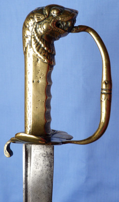

I had thought of the VOC myself, Victrix, in that many of their officers carried high end weapons. Jasper helped me with an old Dutch hanger, pointing to its museum-quality counterparts carried by bigwigs in the Company. Here's the old thread-
http://www.vikingsword.com/vb/showthread.php?t=11701

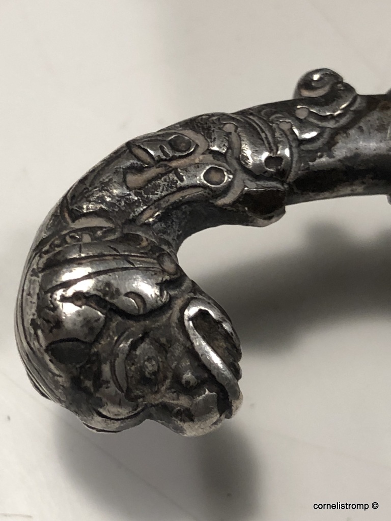

Note again the monster head finials, much like on this silver piece.

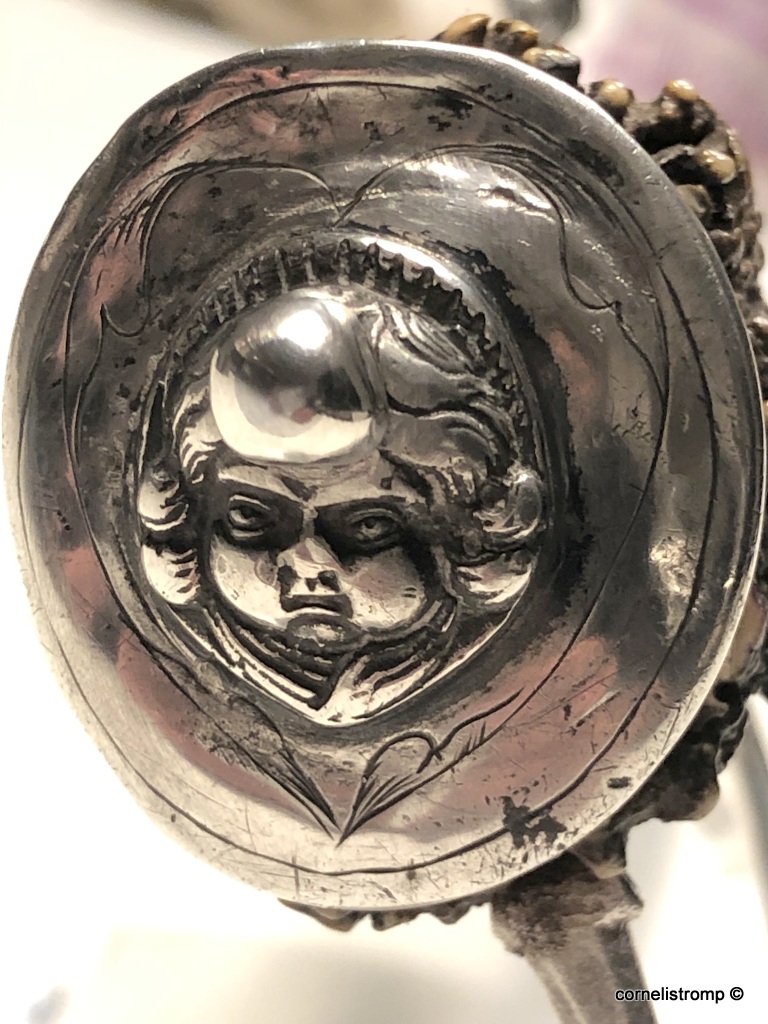

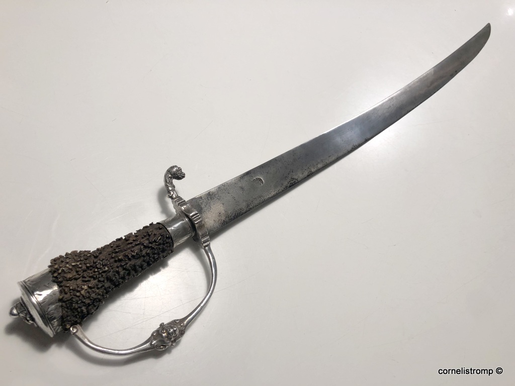

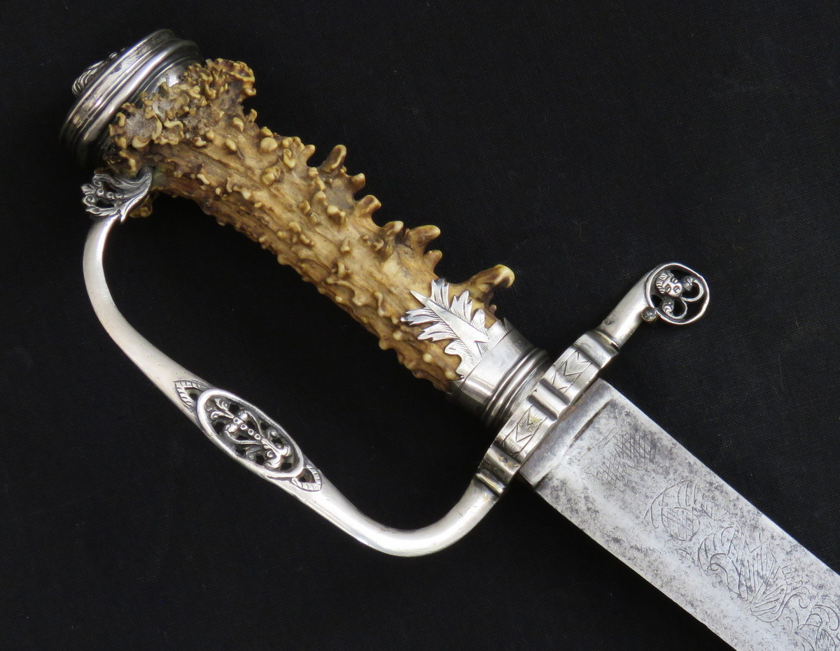

a beautiful late 17thC silver hilted hanger made by a London silversmith.
a similar cherub occurs on the pommel cap.
That's another beauty, Jasper. The cherub faces always remind me of those found on the Queen Ann cannon barrel pistols also of this era.
