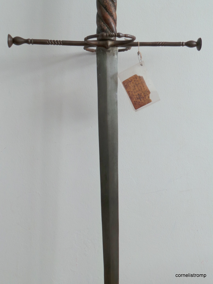

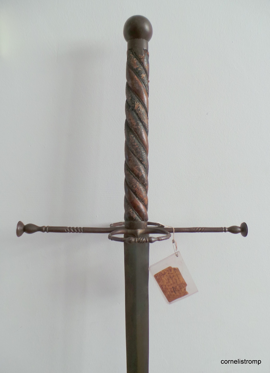

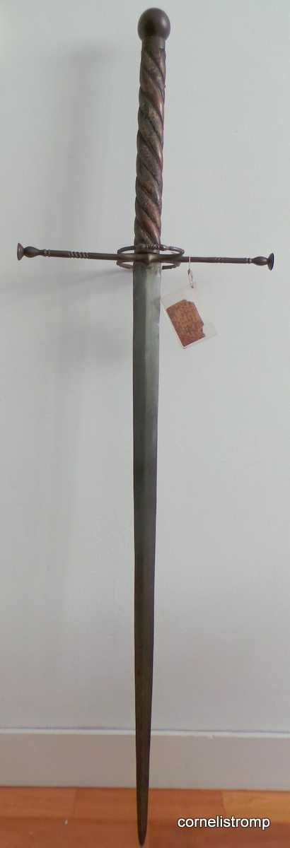

Last year I got a sword in my possession, in a very good condition (indoor patina) with a scabbard whose leather shell unfortunately falls apart in VERY little pieces.

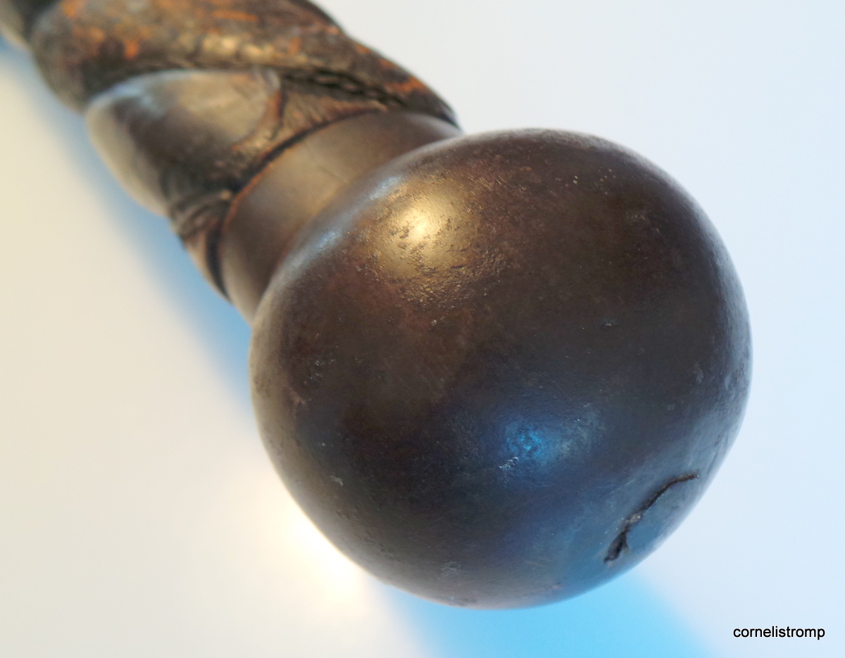

A round pommel, actually a basic shape, Oakeshott type R, rarely used on swords, when.... mainly on Scottish and Northern European swords.
a stiff diamond-shaped blade for the thrust and a hilt with inner and outer rings, wide parry rods with saucer-shaped finals.
long leather bound grip with two rings at each side.
the sword's is 142.5cm, blade 102.5cm.

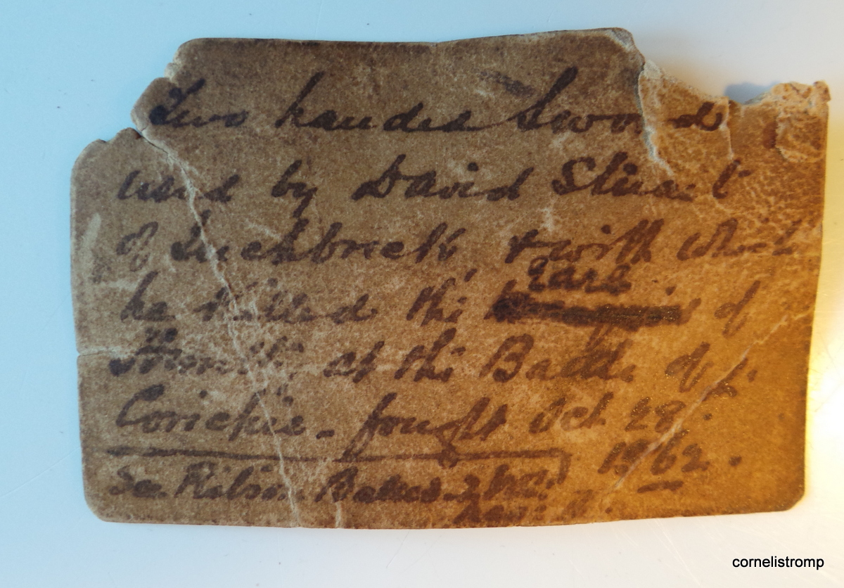

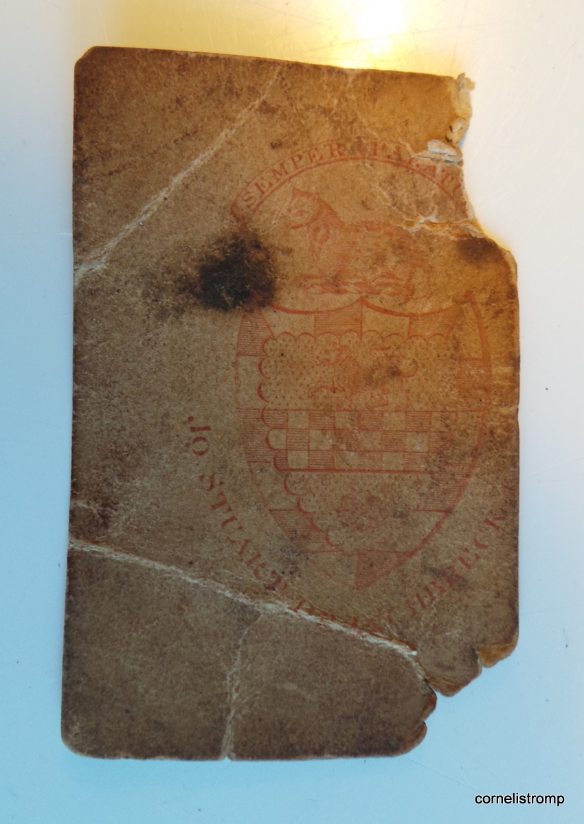

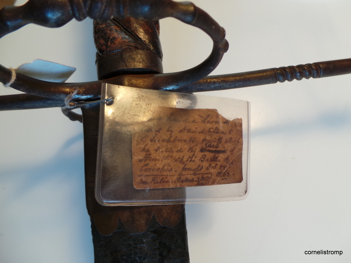

in a plastic folder to parry ring was a piece of parchment with family crest at one side and a written part at the other side.
I have found that the text on the old parchment must be;
Two handed sword used by David Stuart of Inchbreck with which he killed the Earl of Huntly at the Battle of Corichie fought on Oct 28th 1562
the weapon on the other side is the family crest of the Family Stuart.
Motto: Semper apparatus = Always prepared
Blazon: A Civet Cat Couchant Ppr.
SourceFairbairn's Book of Crests, 1905 ed.
Because the weapon of Stuart of Inchbreck it is depicted on the parchment , in all probability, made up by someone from the Stuart of Inchbreck family.
when, I don't know.

Hi Jasper,
My congratulations on the acquisition of such a historically important sword!
How would you actually date this impressive item - probably ca. 1540-50, as it is rather delicately wrought throughout, with quite thin quillons and a globular pommel?
Best as ever,
Michael

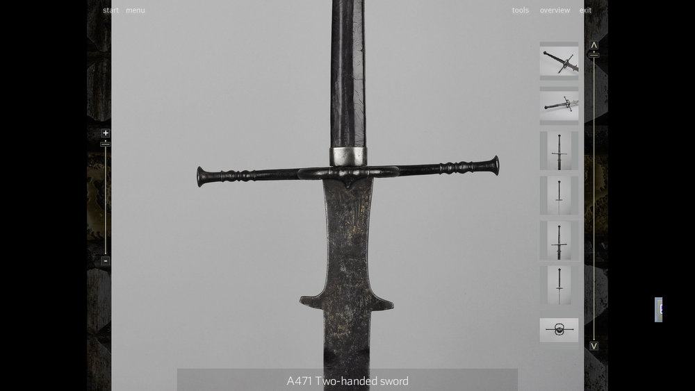

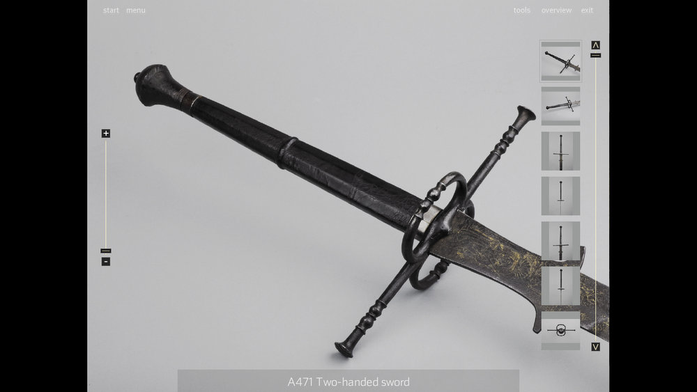

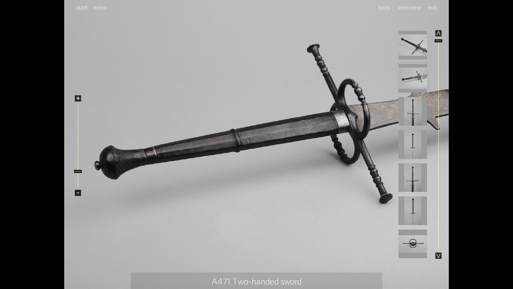

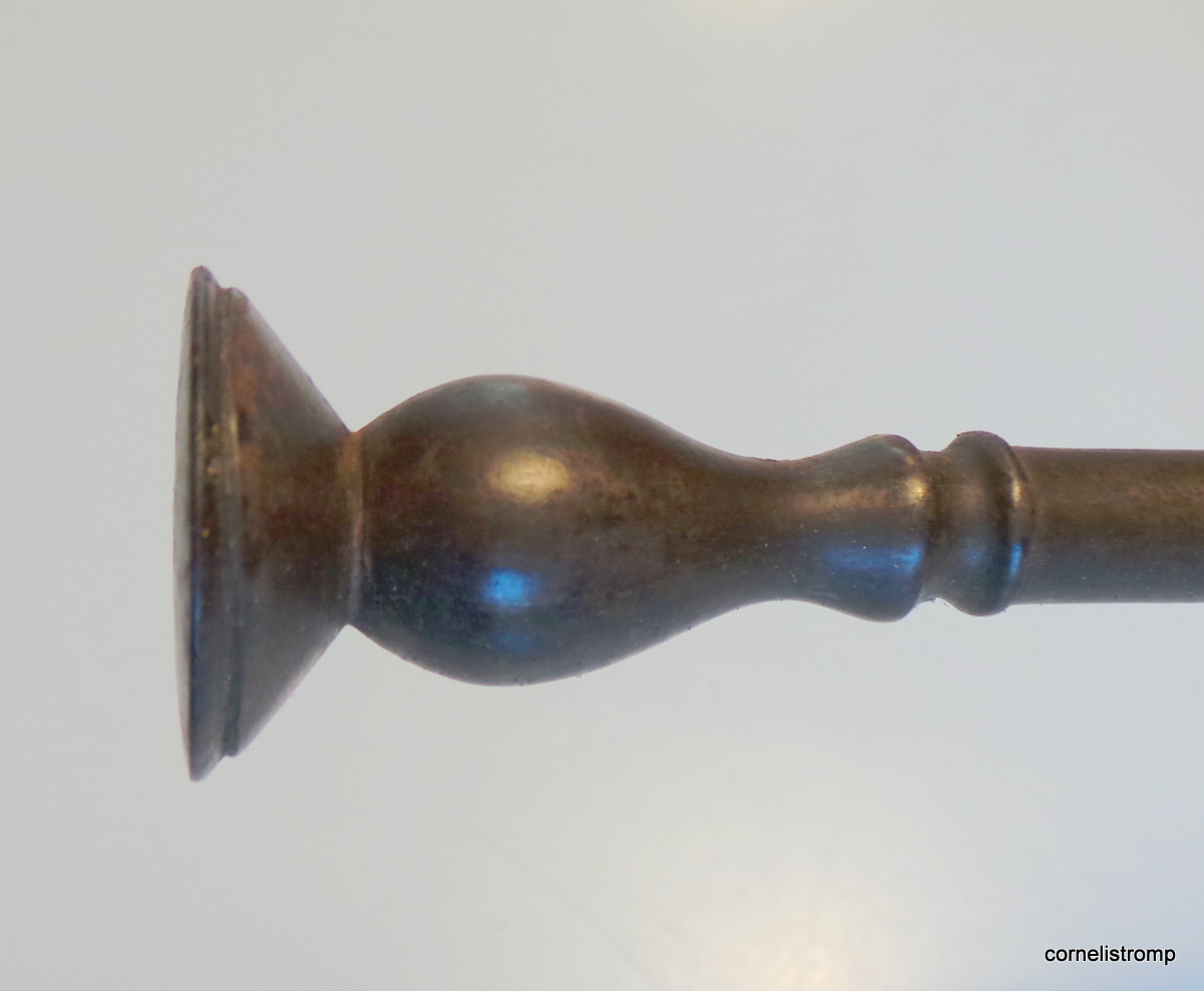

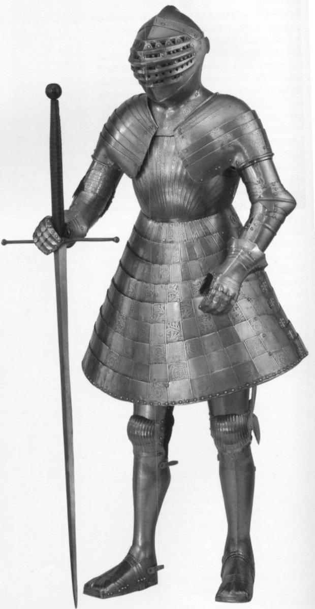

though there is very little scottish reference material, I came before having studied the parchment off at around 1550-1560 and Scottish. (it was offered as 18thC)
The round pommel and parallel oversized spiral bound grip characterize scottish two handers, see for example an almost simlar spirally grip of a two-hander in the castlemuseum of Edenburgh and the pommel and grip of the very famous 16th century hilted sword, hilt also reshaped in in the 19thC, which is (probably incorrectly?) attributed to William Wallace.
The parry rods with their characteristic finals have style similarities with a sword recently auctioned at Thomas del mar 3/12 lot 179; a two-hand sword possibly for the field german or swiss , circa 1550-60.
the last picture; 1520 Henry VIII’s tonlet armour is English, the elegant two handed sword with the round pommel and diamond shaped blade probably also.

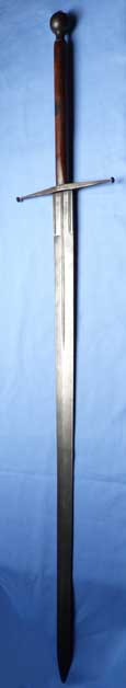

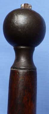

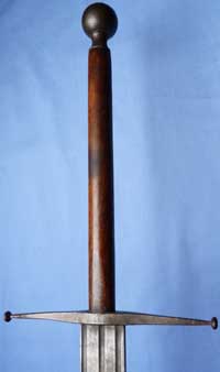

Scottish 2handed sword, probably 17th or 18thC, all-over length 52.75 inch
pictures © Harvey Whiters.
the grip ring and pommel are intergrated into a pommel with neck.

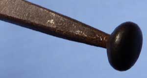

Hi Jasper,
This one's crossguard looks in the same style like the one you have.
kind regards
Ulfberht
