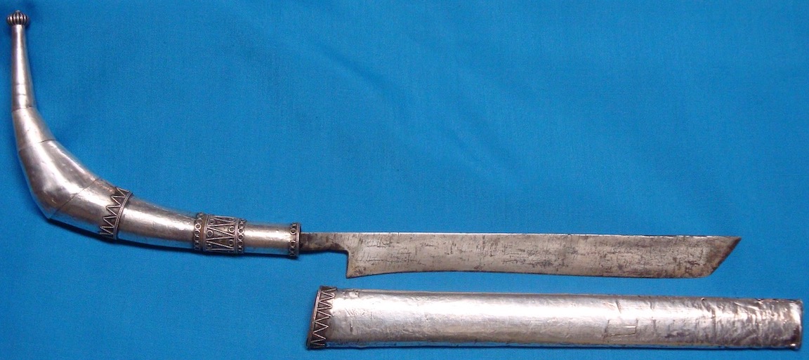

Greeting folks!
I got this lopah petawaran (thanks Detlef ) and restored it. Half of the hilt was cut off and on upside down:

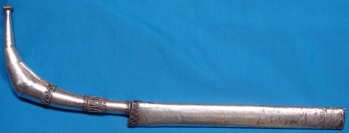

Here are the pictures of my restoration attempts:
Battara is online now   Reply With Quote

Battara, the hilt on the LP is no easy thing to replicate and it looks like you did a nice job using historical examples. I especially like spherical finial... you seem to excel in finely crafted details like that. Awesome sauce!

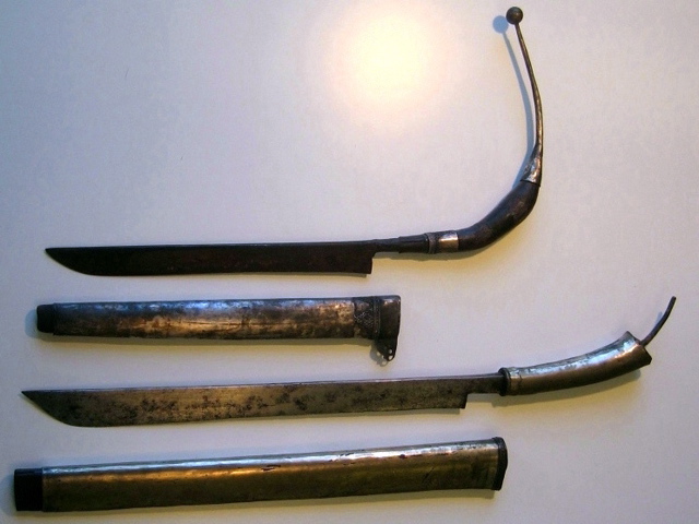

Whoa, Jose, hold your horses!
Willem is on the right track - I'm also fairly sure that the hilt was original as is. I'd agree that it might have been turned upside down though.
Jose, your example is a known type that is characterized by a kinda simple blade without bolster; the hilts tend to be often only very slightly curved and there may be (but not always is) an exposed tang protruding from the pommel.
The typical lopah petawaran is characterized by a blade with an integral bolster (somewhat resembling a rencong bolster) and the typically strongly curved hilt of the hulu jongo type.
I thought I had sufficiently explained this here previously:
http://www.vikingsword.com/vb/showthread.php?t=23443
I'm attaching a pic taken by Michael which shows the two types side by side.
And, yes, the current example is Karo Batak, indeed.

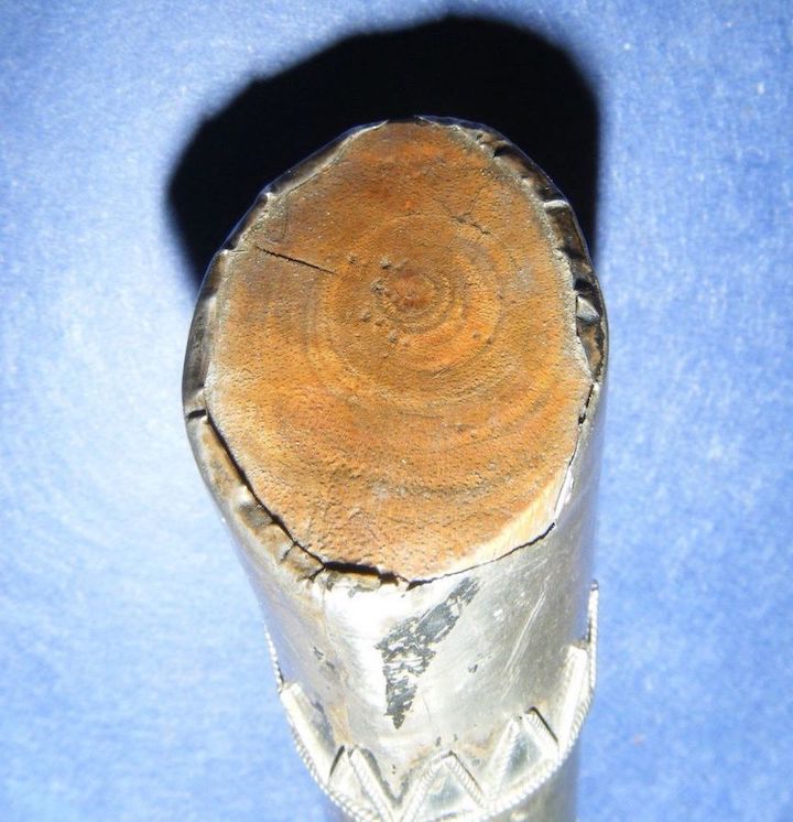

Old 21st December 2018, 01:37 AM   #10
Posts: 7,420
Originally Posted by kai
Hello Jose,
Could you post a pic, please?
Ok here is the picture of the end of the hilt before restoration.
Old 21st December 2018, 01:34 PM   #11
Post
Hello Jose,
Thanks, that helps to put things into perspective!
BTW, if you ever get access to this part again, I'd be interested in a thin sliver of the wood (preferably cut with a razor) for identification purposes.
From the looks it seems that the wood surface exhibits some patina & wear: So, it wasn't freshly cut (nor a recent amputation of an older hilt). I reckon the current surface was never meant to be visible; otherwise, the hilt shape is pretty typical for the variant type (except for the scalloped pommel/top as you already mentioned; not all examples exhibit this feature though).
My best bet would be that this hilt was fully covered with silver of which the top got lost sometime during use.
