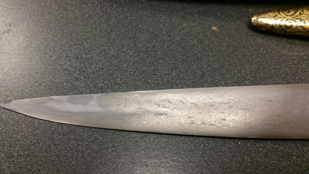

This is my first post but I think it won't be my last. I have recently acquired and edged weapon that I have no clue about. I've been able to find similar looking weapons online and on auction sites but apparently here in The States there are few if any experts. I got this "knife" or "Dagger" because of the steel used in making it. I understand it is Wootz Steel which is very intriguing to me. I'll try to add the pictures I have in the hope that someone can enlighten me on where and when this weapon may have been made and any other pearls of wisdom. Thanks in advance!

Welcome to the Forum. What you have here appears to be a Balkan KARD. Yours is likely Ottoman Turkish, but the style is found throughout the Balkans, Persia(Iran) and even India.

Modern Indian work made in the last decade.

Do I see "tears" in the hilt. Was that ever a traditional feature?

The scabbard mounts look modern Indian to me (better pictures would help) as well as the velvet condition.
I have not quite seen these from the Balkans, but I do agree with Khanjar 1 on them being from the Ottoman, Mughal, and Persian empires.

I do think the scabbard is not old because the wood you can see on the inside looks very fresh and white. Any specific pictures you would like to see?

I'm specifically responding to this post because it's such a departure from the others. As I stated, I have no knowledge about these but I'm not sure it's quite that new. I have been reading as much as I can find online (which isn't much because I don't know how to search this) and was under the impression that forging Wootz steel was a lost art and hasn't been done since the mid 1800's... unless I'm mis-informed or this is not made of Wootz?
If it was made that recently, would it be considered a trinket made for the tourist trade or is it something of some quality? Other than the flaws in the steel itself it seems to be well made. And what of the "Tears" in the grip spine? Is that common in these?

I had the same suspicion, but it looks like the blade at least is old and just recently enhanced with fresh koftgari. Or am I wrong and blade is a newly made wootz blade?

Oliver raises a very good point. There are recently made Indian knives flooding the market, many coming from Rajastan, that are hard to distinguish from older knives with wootz blades. These copies are getting better and the appearance of the blades is getting closer to traditional wootz.
I would agree with those who point to a recent hilt and scabbard, and recent gold work on the blade. The question then becomes, Is this an old blade?
As I look at the blade, I see inconsistencies in the pattern that could indicate the blade is not traditional wootz. In particular, towards the tip, there are "blank areas" in the pattern. This suggests to me that Oliver is indeed correct, and the ensemble is recently made, most likely from northern India.

Recent production from India.

Nothing "balkan" in this kard.
100% Indian, of recent production. Albeit of high quality showing crystalline wootz pattern.

I join: modern Indian work thru and thru.
They make wootz ingots in quantities and would have no problem forging one into a blade.
But the devil is in the details: they do not know how to forge it right and that is the reason for a pitiful and patchy pattern. The rest is obviously virginally fresh.
It is obviously well above their mass-produced daggers, but it ain’t no antique.

[QUOTE=They make wootz ingots in quantities and would have no problem forging one into a blade.[/QUOTE]
Ariel,
I do not think this is the case nor real wootz ingots are being made The subject blade is likely antique wootz blade, heavily grinded from larger blade, likely tulwar, into smaller one, which resulted in discoloration and losses of pattern. The modern "wootz" daggers made in India that look like wootz are not real wootz, just like "wootz" ingots they sell on eBay.

It is possible but in my oppinion unlikely.
Antique wootz, reworked, will retain the watering pattern, or loose it but will not transform into crystalline wootz. And from what I can discern in the photos, the blade displays some crystalline wootz patterns.
After looking more at the photos, I believe I can discern some watering pattern...
If this is the case, then it is a blade reworked and the partial loss of pattern may be due to reheating locally the blade.
