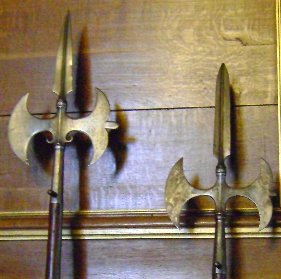

Interesting halberd. I wonder why this sort of thing was found Mozambique . It should have been be used by the Royal guards of one of the Portuguese Kings . Not an early combat weapon, but certainly one used for escorts, parades or Palace guards.
It is not the same style has seen in the entrance of Palacio da Ajuda, though.

Judging by the short langets and guessing that its blades are not sharpened (?) it could have been a symbolic/command weapon, like that of a sergeant; as naturally in this remote fort no Royal guard parades or escorts would have taken place.

The less perfect engraving of the coat of arms would mean that this was not a Kings Guard halberd but a Guard of some important personality, like the Governor of Mozambique or one of the Brazilian States. The shape of the blade, when of the Kings Guards, is rather different, with its two opposite "half moons" as shown in previous post; the Royal crest together with the initials of the King or Regent, are finely engraved, and never of cast iron.

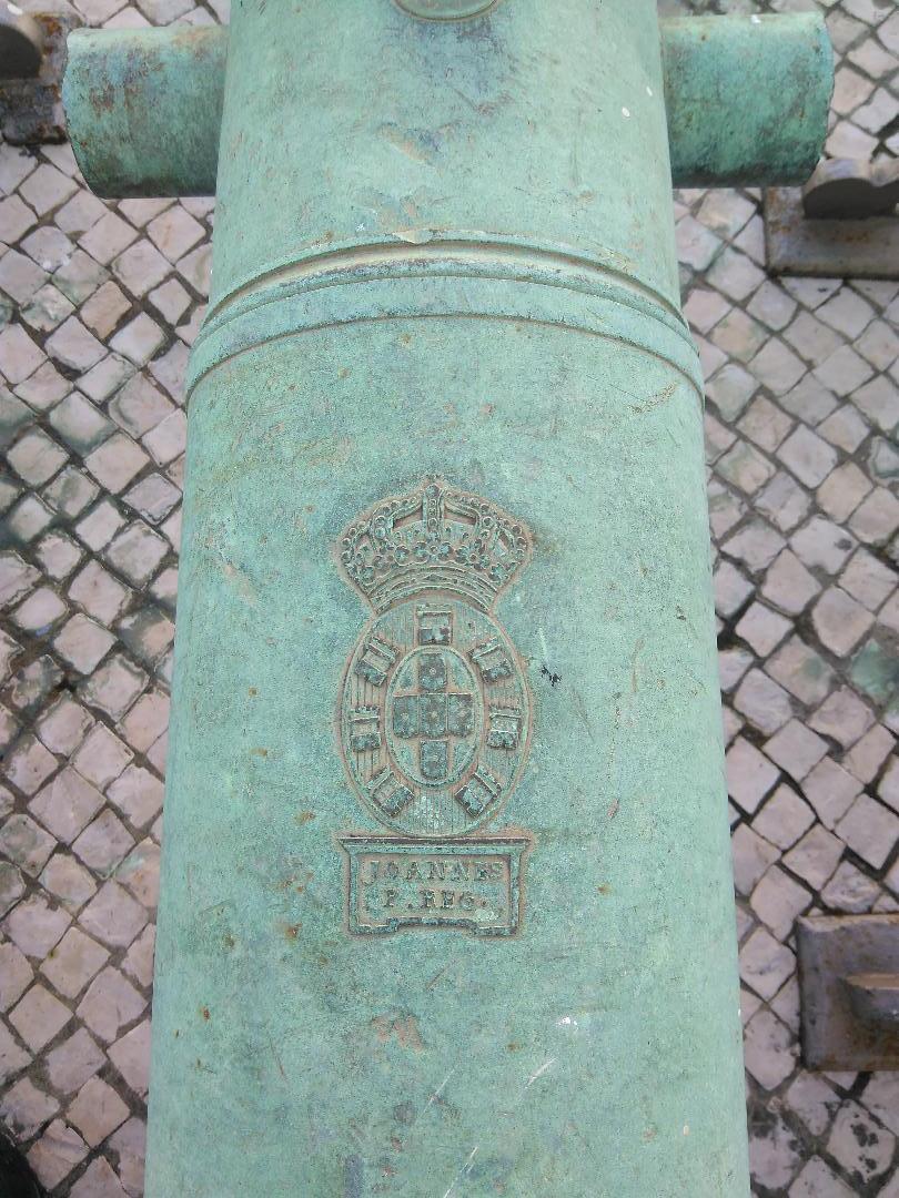

One interesting thing is the coat of arms, if you notice this coat of arms is not very common, the circular shape can be related with D.Joao VI, i found a similar coat of arms in a canon in the army museum in Lisbon.

Looking at this cannon, we notice that the shield is oval, that of Dom Joćo while Prince Regent, as it says in the inscription. Later when he became King (and Emperor) while in Brazil, we see that the Coat of Arms becomes circular, including the armillary sphere. After 1826 it returned to the prior version, as by then Brazil was already independent. In any case, your halberd having the circular shape but not including the armillary sphere, could be due to it not having been made in Brazil but in Mozambique ... i would venture.

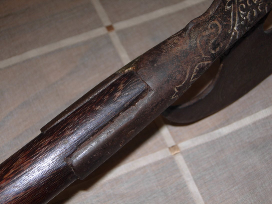

It is not cast iron. Cast iron has a carbon content by weight of approximately 2%-4%. As such it is very heavy and rather brittle. It can only be cast and ground. It cannot be holed or hammered (even most makers marks and decoration in cast iron are part of the mold). This piece shows clear evidence of forge work having been done for either it's fitting, manufacture, or both. The work also shows no distinct casting seams or evidence of the removal or wearing down of casting seams.
Neither is it wrought iron. As given it's apparent age and condition we would see at least some evidence of surface cleavage revealing fibrous structure. To me this looks to be a low to medium carbon crucible steel. Worked on a forge from stock. Possibly case hardened.

After tests my conclusion ist that it's forged!
About the origin still don't know, asked for "experts" i know opinion and no conclusion.... i will continue to study the halberd, i think the best evidence so far is that ir's origin is from mozambique and probably a local forged one...
