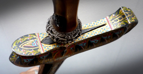

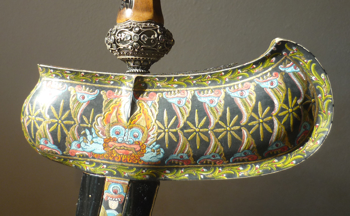

If we consider these Sunggigan krisses as being used for formal events then there is no difference in the dress code for a Gayaman versus Ladrang as opposed to the unpainted versions?
Here is one with a black back ground?
Decorated with Kala and one eyed Bintulu creature (along the opening of the blewah).
Paul B. is offline   Reply With Quote
Old 26th July 2018, 01:04 PM   #5
Posts: 7,229
Paul, there are events of varying natures. The style of dress, and the style of keris dress can vary according to the nature of the event. In some instances it may be acceptable for some people to wear gayaman keris dress, but not for other people. The answer to what is acceptable when, where and by whom is really a question that can only be answered by an authority on the protocol that applies in a particular kraton or social setting. My knowledge does not extend that far.
Black is the colour for a jajar.
