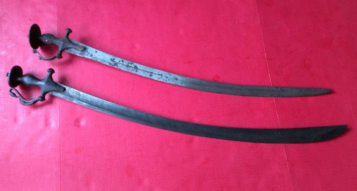

Hi everybody!
Need your expertise and advice.
In his book on Indian weapons , Pant shows a hilt he specifically attributes to Marwar based on the " kissing swans) on the D-guard.
I have 2 similar ones. Regretfully, Pant, IMHO, is not a very reliable source of information.
So, my question #1:
Does anybody here has an independent confirmation of the Marwari origin of this pattern?
Then, question #2:

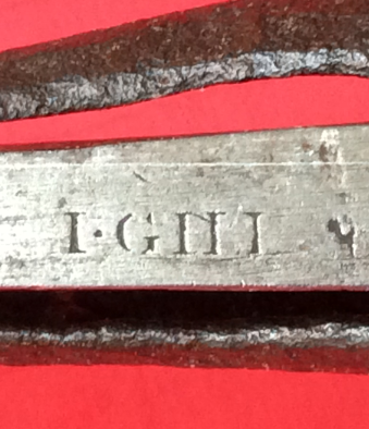

The upper sword has a standard Indian blade. But the lower one has a British 1796 pattern blade. I know that Brits transfered ( sold?) their blades to the Indian contingents.
This blade is labelled on the spine with the name of I. Gill. I know of Thomas, John and James Gills, but am unfamiliar with I. Gill. Perhaps, the letter of the initial is damaged. Does the stamp on the blade help?
I will be grateful for any help.

Hmmm.. I would be a bit careful when it comes to Pant, as you are well aware.
I think it may relate into another group, which I try to research, and in this group there are several hilt - all of silver. But I may be wrong - research will show. See cat. p. 296-297.
I dont know where I will end, but it is interesting all the same.

Yes, I know your Rajput one. Still, can we further pinpoint this pattern to Marwar?

Can't help you with the hilt, but I can confirm the blade is from a British 1796 pattern light cavalry sabre. I Gill stands for John Gill who took over the sword business when his more famous father Thomas died in 1801. Remember in the Latin alphabet there was no J. John Gill was in business from 1802-1817. Richard Dellar has a chapter on the Gill family in his book "The British Cavalry Sword 1788-1912".
The crown over 4 stamp is a government acceptance stamp signifying the sword was accepted into British service by the Board of Ordnance. From there it obviously found it's way into Indian hands.

Since you ask Ariel, no I would not pin point it to Marwai at the moment.
There are postulates, but no arguments why it should be from there.
