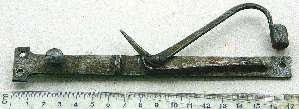

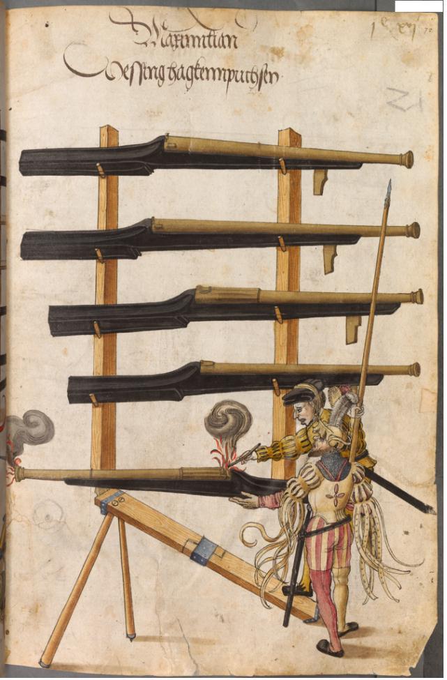

Nothing fancy, perhaps something along these lines

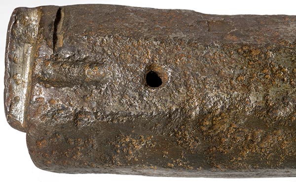

You will see that there is a groove that was chizeled out for a pan, I;d probably fabricate something and age it so it would fit. Then I would need a matchlock, or serpentine along these lines.

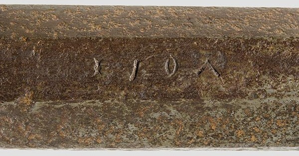

This barrel is interesting in that it is dated 1507. My old pal was of the opinion that it was the second earliest dated barrel known.

Congrats on a great acquisition, Ed. The priming pan was no doubt mechanically fitted via a dovetail joint in that groove, the extensive corrosion over centuries has eaten away at the undercutting. If you merely want to display the gun and not shoot it, you can probably attach your replacement with epoxy. Do the aging on your replacement pan and cover assembly first, and you can mix various organic materials like sawdust, powdered charcoal, and even some ground up rust in your adhesive to make it look like the thing has been together for donkey years.
The barrel is interesting for not only the pan attachment but for the lack of an extended tang on the breechplug. Having restored a lot of Oriental guns (Indian, Tibetan, Chinese, and early Ottoman) I have seen exactly the same format and can confirm the dovetail attachment in all of those instances.
If you have Robert Held's The Age of Firearms (1957, and several subsequent eds. incl paperback and foreign languages), Fig. 39 on p.28 has an excellent 3/4 view of a lock and pan. You will note that the pan, being essentially square with the cover pivot screw on the outer rear corner, has a round bowl shaped depression with the touchhole drilled BELOW THE RIM on the side adjacent to the barrel, and connecting through to the bore. It is not the oblong or bidet-shaped depression with a trough-like path to the touchhole as is used on later lock systems.
The deep vertical notch on your barrel is to help retain a flash shield fashioned from a thin iron plate, running from the top flat of the barrel to a tubular sleeve that supports the long pan pivot screw. The drawing in Held's book says it all.

So you think the dovetail was to position the barrel and prevent lateral movement? It seems like a pointless embellishment.
Note that my, or rather the gun's, touchhole is on a line with the groove and even with it. It suggests that the pan was sorta rectangular and extended forward of the grove. Yes?
Agree.

2. Yes, the forward portion of the pan extends further than the dovetail. It allows a pan of sufficient size, and reduces the labor needed to chisel and file the slot further. The walls of the dovetail slot were originally undercut to provide the necessary support (the pan being tapped in with a hammer for a tight friction fit), but so much metal has been lost due to centuries of corrosion that some sort of adhesive is now needed if you don't want to re-cut the slot. (to avoid an invasive, irreversible alteration to the metal of the barrel, re-cutting would not be advisable and is unnecessary for something you want to restore for display and not use).
3. Yes, the projecting pan does allow for increased stability of the barrel in its trough in the stock considering the fact that the breechplug has no projecting tang that takes a bolt or screw. The stock inletting of many early European guns is such that the right hand "wall" of the barrel channel projects a tad higher than the bottom of the pan, providing a notch that supplements the barrel pin(s) in the forestock in providing a firm and stable fit. (this is even more crucial with many Oriental matchlocks that utilize barrel bands, but that is another story). As I recall, the barrel hook on guns like yours is normally perforated for a barrel pin, so the attachment of the barrel is especially sturdy both fore and aft.

Reading your original post again, I noticed that you provided a pic of a Schnapplunte mechanism with button trigger. Do you have this, or are trying to acquire it for your project? Your endeavor sounds quite intriguing, please post images when the project is finished!
If I have misread your post, and you are still searching for a suitable lock, perhaps fellow forumite rickystl might able to locate a source for a correctly styled replica. I will send him an email. If you rather wait for an original, there are two big auctions in Europe, one in Munich and the other in Sarzana (Italy) which regularly feature interesting and hard-to-find locks. It might take awhile but I trust that you aren't in a burning hurry on this. Good luck!

LOCK: I have searched my sources for replica locks. The earliest available snapping style matchlock lock available commercially is from about 1544. And it's English. So that won't due. The German/Bavarian locks are all late 16th to early 17th Century. And that won't work either.
There are custom lock makers that can make you an exact copy of the one in the photo above. And that lock looks correct to me for this extra early period.
Unlike a flintlock, this style of early matchlock would be fairly easy to build for a custom lock maker. So I would suspect the cost to be reasonable. If you have basic measurements along with the photo(s), it's even easier. Should you decide to go this route, let me know. I have 3/4 sources.
