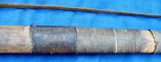

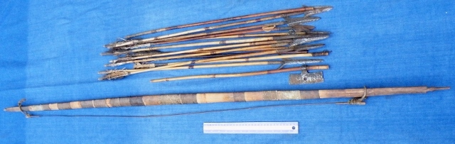

This small group of weapons came together recently, and are a bit of a puzzle.
Based on the small/miniature axe, I am thinking from Tribal India somewhere ? (Khond ?).
The little axe is 60cm in length and very light, it would be of no use as a weapon. Could it be made for a child or for ceremonial use ? The bow and arrows do not really look African to me, as African bows do not normally have that type of split bamboo bowstring.
Anyway, can anyone help out with identification and any relevant information ?

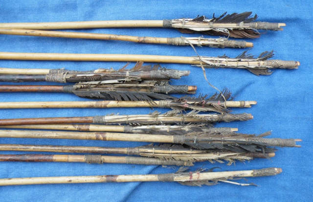

The arrowheads look very African to me.

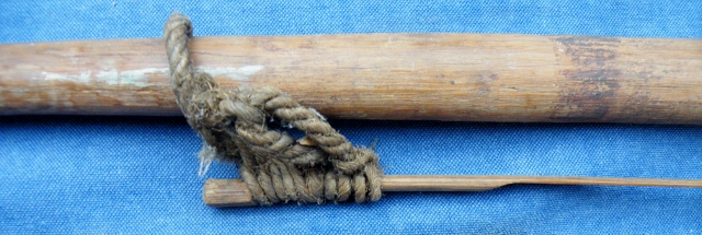

Strings like this are/were used in the Congo Basin (and West Africa too, I have read, but the examples I've seen have been Congo). Two examples of such strings in Traditional Archery from Six Continents (139 and 140), though the nocks are different (only one tip of the bows are shown, not the whole bows). Size is also common enough for Congo bows.
The arrows might not belong to the bow (and might not be from the same continent). The bowstring is flat, and the arrows have nocks.

Good point about the nocks and the bowstring. I have looked through the book on African archery equipment "Ata Epe" but cannot see a bow stave with those distinctive carved tips. There are some arrows illustrated with fletching a bit similar to these, however.
Any thoughts on the diminutive axe ? I should mention that the axe shaft and arrow shafts appear to be made of the same type and width of bamboo...

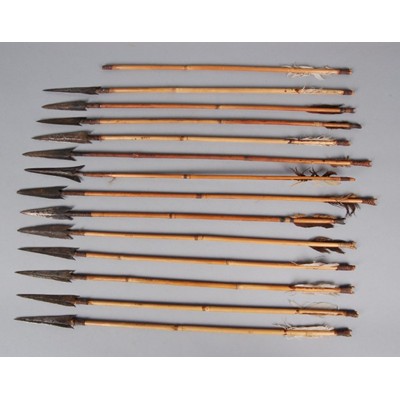

The axe looks Indian. Khond? So, the obvious next step is to look at Khond bows. Here is one in the British Museum: http://www.britishmuseum.org/researc...71416&partId=1 (photo attached) with a rattan string very similar to yours. The nocks/tip aren't a closer match than the African bows, though. (The African bows in Six Continents might have rattan strings too, rather than bamboo (the text says bamboo).)
The African thing about the arrows is the heads: Z-cross section blades, a mix of double and single barbs, and a needle point. (Is the needle point iron or something else? African needle point heads are often hardwood and grooved (for poison).) I don't know enough about tribal Indian archery to say whether or not they're plausibly Indian or not.

Thanks for your post. The arrowheads are all of iron.
I did some internet searching and found these images of Khond archery. It seems all my items could be Khond ? Wonder what the hole in the axehead is for ... the attachment of adornments or just for fixing to a wall ?
