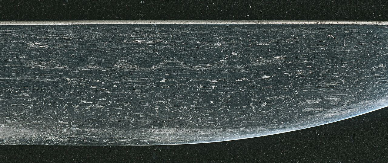

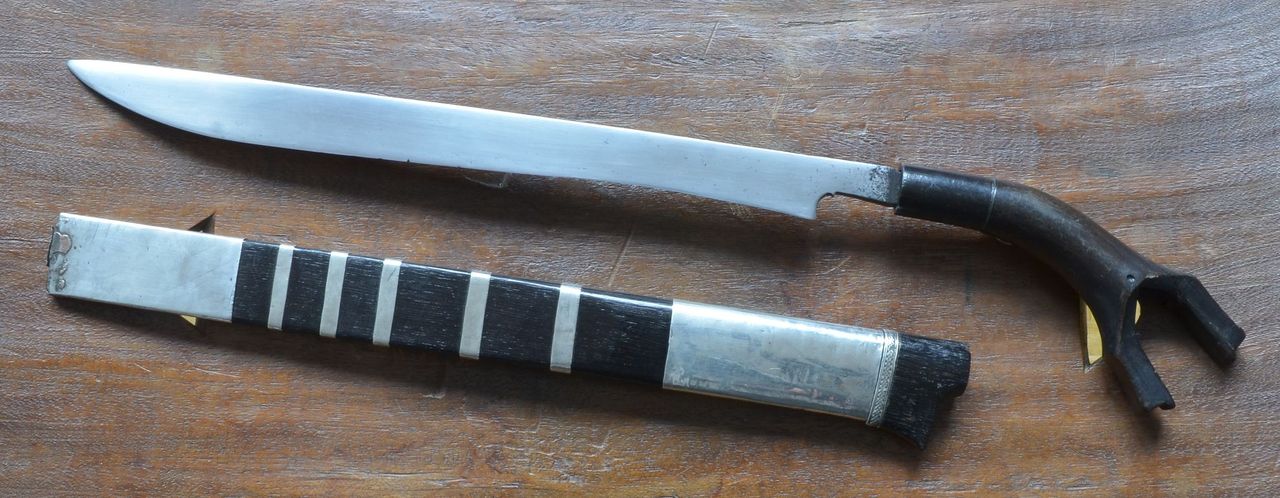

after restoring this nice Sumatra dagger, it became one of my favourite daggers in my collection.
According to Volz it is an old Karo-Kalasan as a dagger with a 30 cm (almost 12") long Taka-blade.
I received it in a very nasty condition, deep corrosion and active red rust.

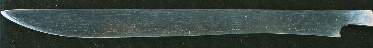

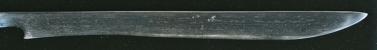

I quickly decided, that it is worth the effort and this was a truly exhausting decision.
The blade was extraordinary hard to grind and polish, eats sandpaper like peanuts.
It took more than three weeks to grind and polish a simple shaped dagger! But the result is worth every effort.
It is a perfectly laminated shear steel with a wavy pattern a nice Hamon on one side and probably with an inserted cutting edge.
I`m really happy with my Kalsan and this was just the beginnig of a wonderful year 2017 for my collection.
I hope you enjoy the pictures and every comment is welcome.

The most important reason to restore the blade was its condition. Absolutely no visible sign of laminations and I was just curious to see whats hidden. Even after the polishing the surface of the steel was looking like monosteel. It is quite rare to find an old blade without the tiniest flaw. This is truly a masterpiece of forging and important for my private research.

The current finish is just intended for my detailed etching. I plan to create a finish with more contrast under daylight conditions later in this or next year.
