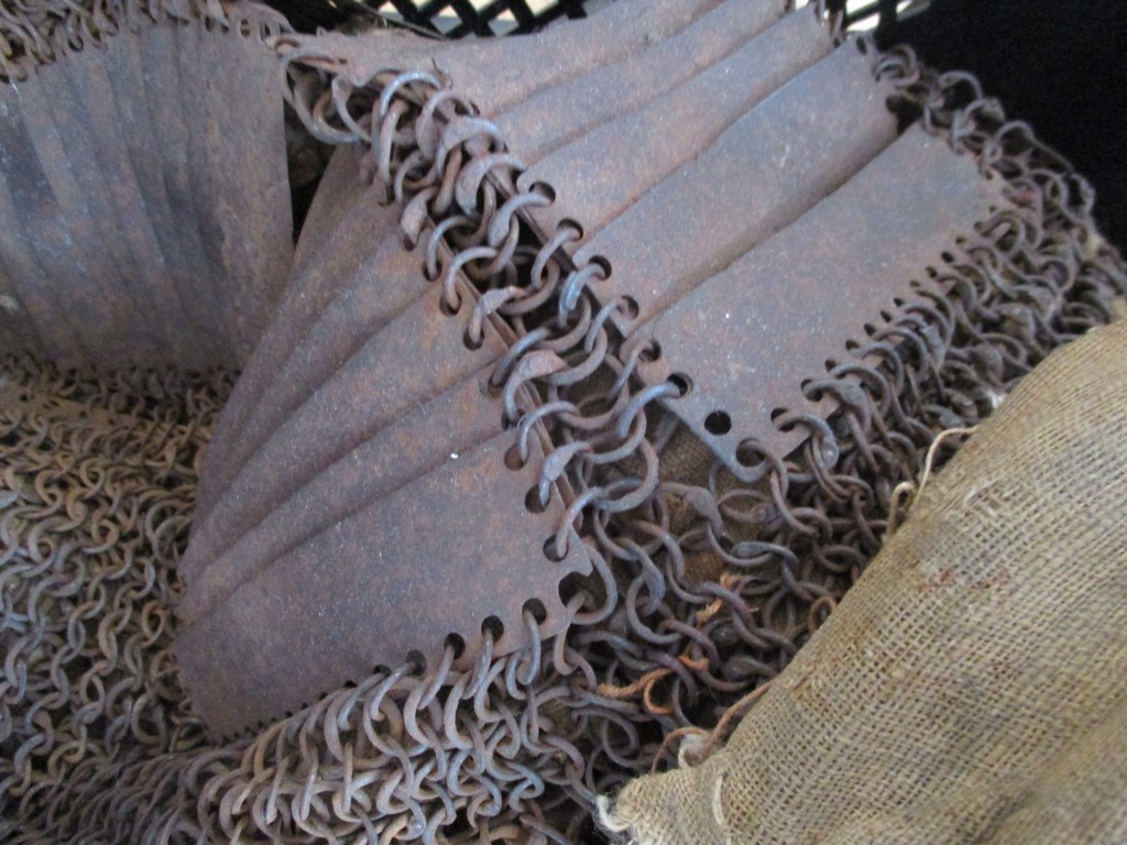

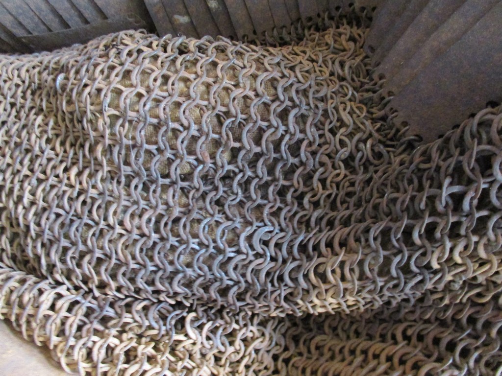

I have a potentially nice full coat of Indian riveted chain mail with most of its kapok padded liner intact . It is rusty but perfectly sound . I would like to both conserve it and enhance its appearance for display. Do any members have any tips ?

It is not badly rusted just overall light surface rust ... my aim is to stop further rust rather than to bring it back to shiny newness ...... any less drastic suggestions anyone ?
