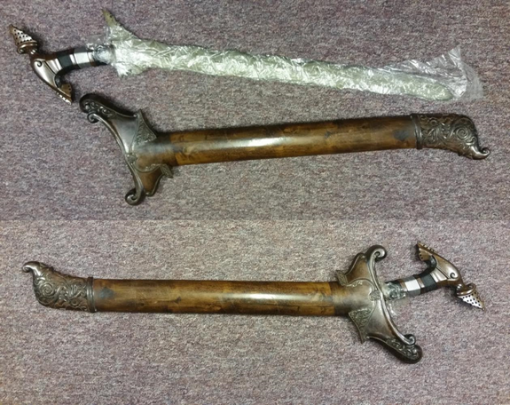

I hereby enclose some newly-made Moro Kris sheaths and handles for comments. Please also feel free to comment on the blades.

The piece with the fittings from light wood is a khukuri(-type) blade (dressed in pseudo-Moro fittings).
It would be good to see larger pics of all other blades including a close-up of the base of the blade.
I'm afraid that the fittings (and possibly blades) are not Moro but rather originate from Indonesia: Probably Madurese carvers - where did you obtain these?

Yes, I commissioned these sheaths from Indonesia. The blades were all sourced from the USA, through ebay.
Just wanted to hear comments on how closely these sheaths conform to authentic Moro designs and motifs.

Frankly said I have a strange feeling by this thread and wouldn't like to comment on how closely these sheaths conform to authentic Moro designs and motifs.

Not at all, I'm afraid! There is a vague similarity in some details and way off in many others, sorry...
If you want a Moro scabbard, you really need to reach out to Bangsamoro craftsmen (and skilled ones are not easy to find). While the Philippines have their share of gruesome fantasy fittings and pieces, there are some pieces coming out of Mindanao which have reasonable, newly made fittings. An ebay search for Davao should turn up something, I guess.
You can also contact forumites Jose Albovias or Philip Tom who have done quite a few scabbards from scratch for nekkid blades.
With both approaches it will get more expensive the more you insist on a traditional high-quality dress, obviously.

Only in superficial ways. No one with any knowledge of Moro weapons would think this is authentic (even modern) Moro workmanship.

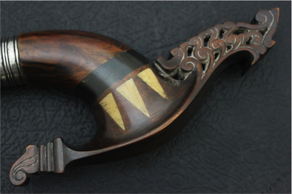

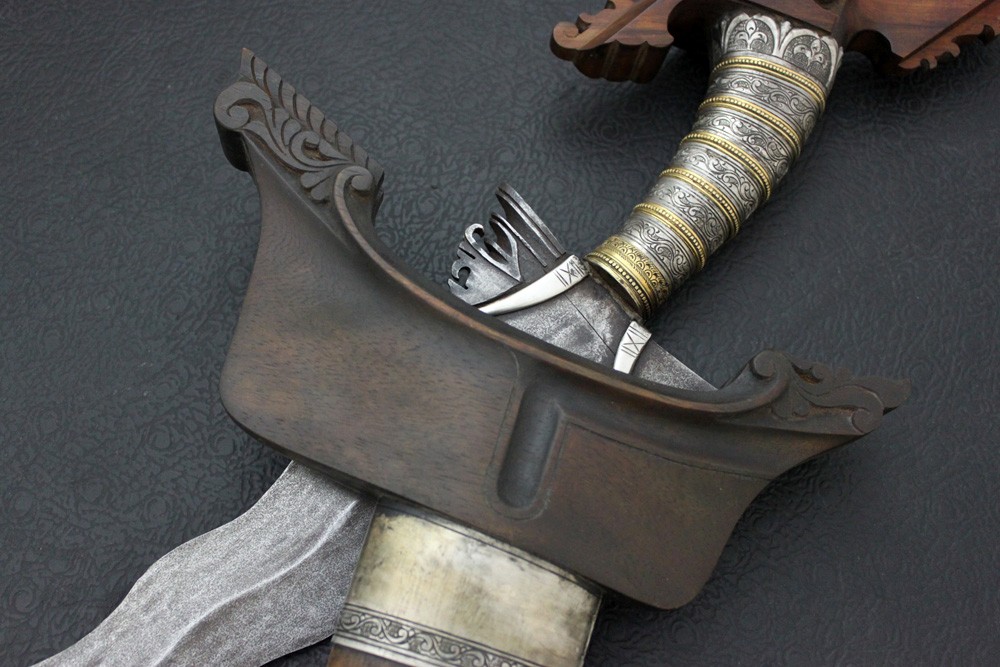

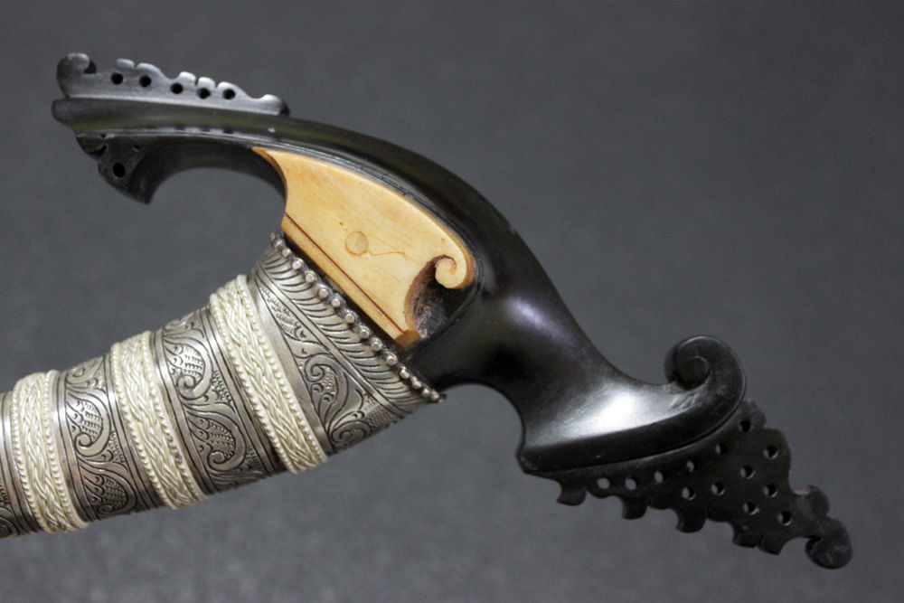

Old 9th June 2017, 10:54 PM   #9
alexish
Join Date: Jun 2017
Posts: 127
Default Are these traditional Moro designs and motifs?

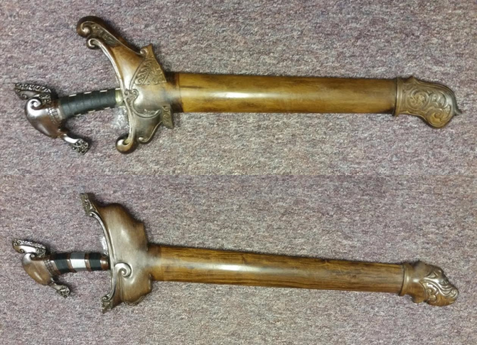

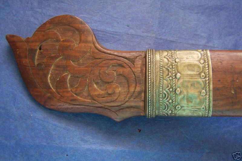

I hereby attach pictures of the original Moro handles and sheaths that inspired my new Sarungs.
Can someone comment on whether these are traditional Moro designs and motifs? Or are these a modern artistic expression?

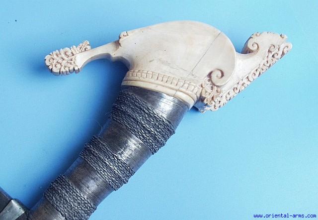

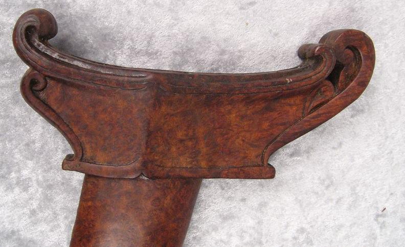

Old 9th June 2017, 11:15 PM   #10
alexish
Join Date: Jun 2017
Posts: 127
Default Pseudo-Moro Khukri
Additionally, I also attach pictures of the original designs that inspired the new sarung for the Pseudo-Moro Khukri. Are these authentic traditional Moro designs and motifs, or a more recent artistic expression?
alexish is offline   Reply With Quote

Hi Alexish:
Several people have noted that these are not decorated in the traditional Moro manner. However, I like the carving. Although somewhat "over-embellished" on a couple, at least for my taste, I can appreciate the skill that goes into these carvings and the finish that has been applied to the various woods.
While some of them are Moro-like objects, they would not pass for items from the original culture. I think many people noticed quickly that these were of Indonesian style and manufacture. An interesting interpretation of the original forms—art craft.
Thanks for showing us these pieces.

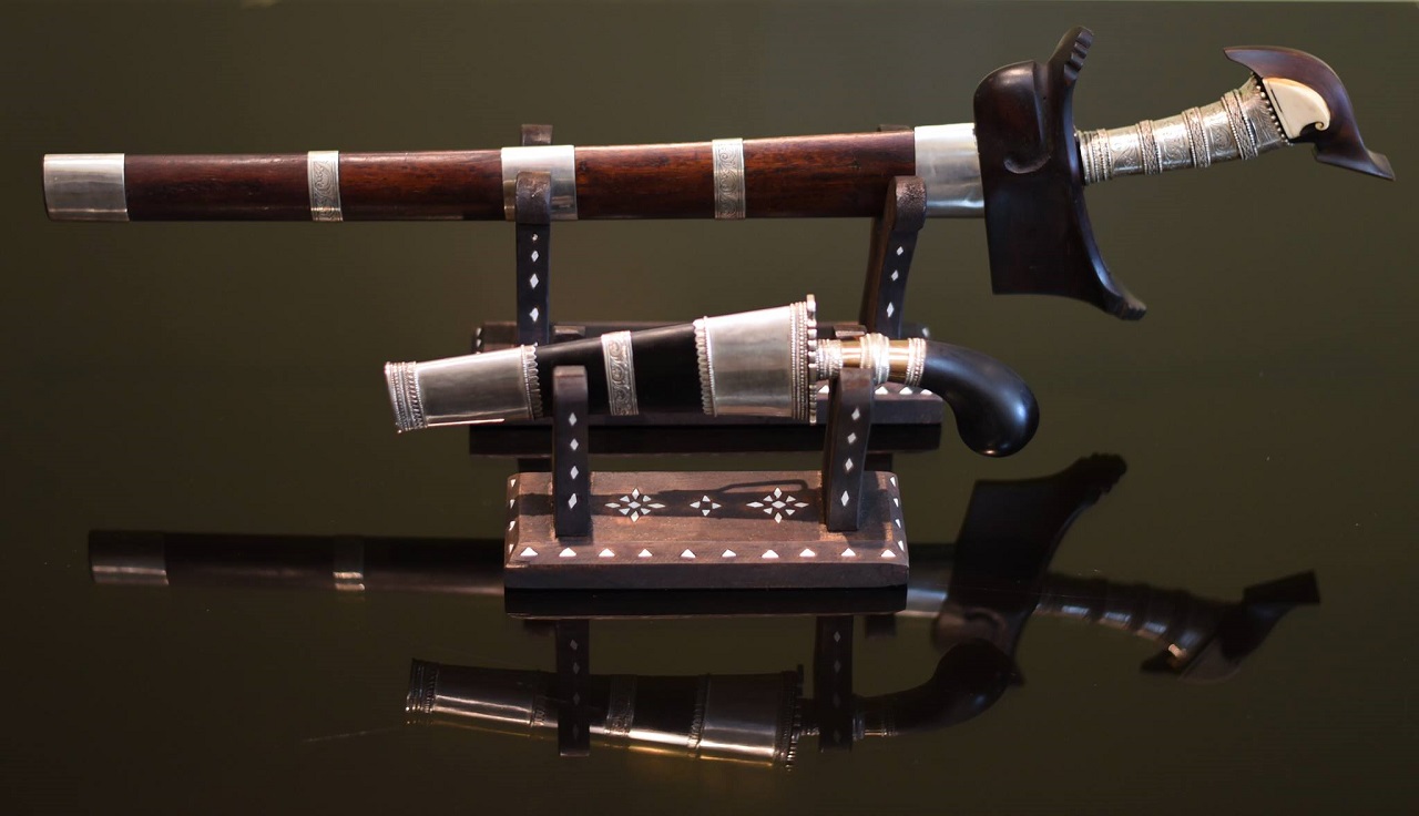

Hello Alexish,
The first three photos show modern pieces but they are examples of what are currently the highest quality products from the town of Tugaya in Lanao del Sur, Mindanao. Tugaya is the traditional home of the best Maranao craftsmen so your examples (post #9) are authentic Moro pieces.
For your reference, attached is a photo of a modern kris and gunong that I purchased in Davao City last year. While not as nice as the examples you provided, you will notice some similarities in the details.
May I request for a close up of the kris blade in your first picture (post #1)? I think it looks interesting.
I hope this comment is helpful.

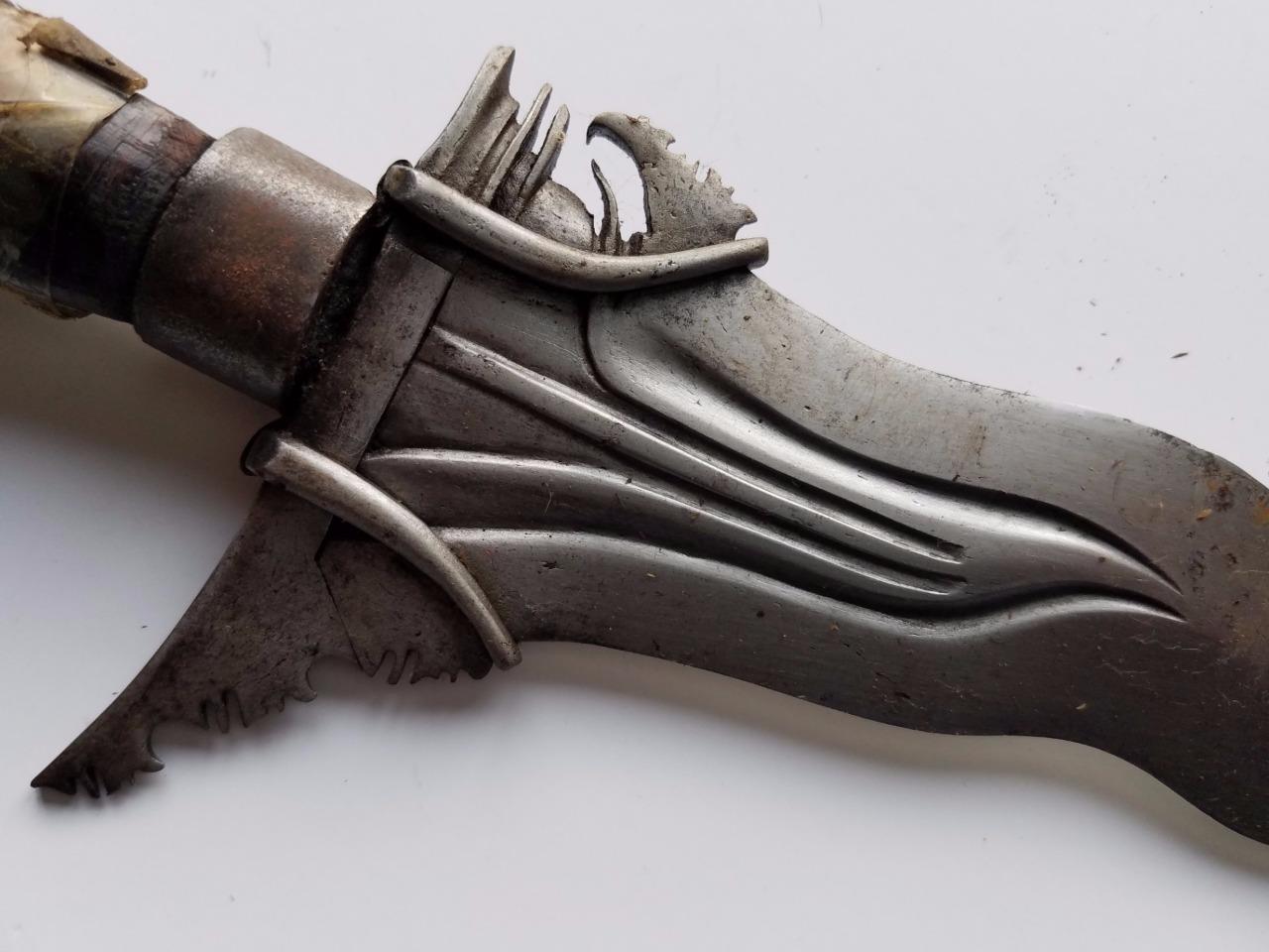

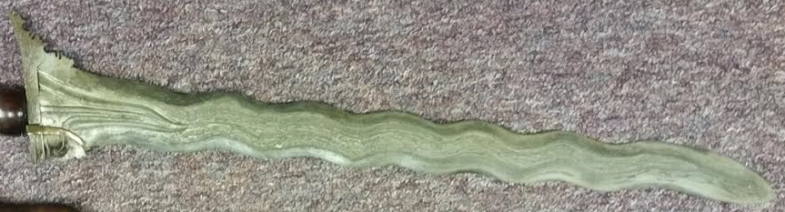

Default Close up of blade
Dear Fernando,
I hereby enclose a close-up of my blade.
Do you have any cooments on my new kris sheaths?
Hope you can comment on 2 areas:
1) Aesthetics of the entire sheath.
2) How close these sheaths conform to traditional Moro design, and whether they would be considered as Moro in the Philippines.

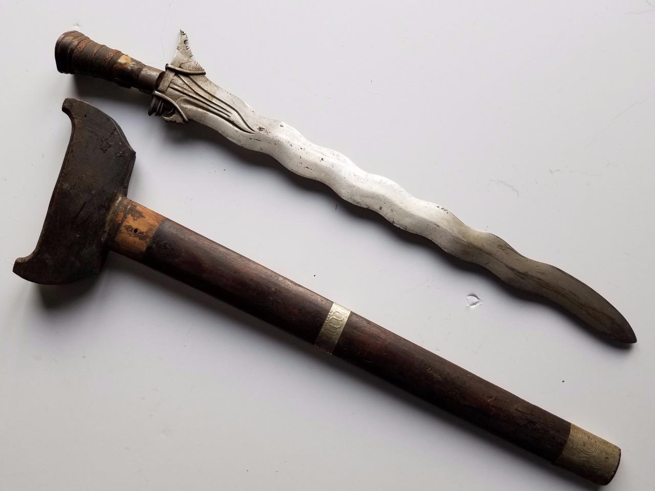

Old 10th June 2017, 10:57 PM   #14
Red face

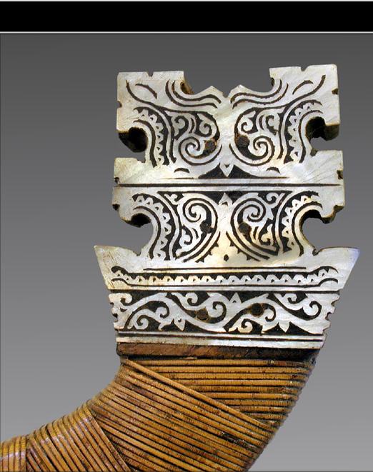

Additionally, I also attach pictures of the original designs that inspired the sarung for the Pseudo-Moro Khukri. Are these authentic traditional Moro designs and motifs, or a more recent artistic expression?
Actually, this hilt is the only modern version with reasonable craftmanship shown (while he also offers the gaudy modern examples, this seller seems to have contacts to artisans who are able to do decent work) and based on a traditional style; however, if one compares this modern example with antique pieces, there is a considerable difference in quality as well as in details like ukkil!
The MOP scabbard tip is a later development (approx. mid-20th century) and again this rather gaudy motif got changed by the Indo carvers and now looks even more flowery and the MOP also got dropped...
While the fittings of this pseudo Khukuri are IMHO the best effort, it is blatantly obvious, that these are not genuine Moro style, especially nothing remotely approaching traditional styles, sorry.
Old 10th June 2017, 11:08 PM   #15
Unhappy
Thanks, I now see where the results are coming from.
None of your examples is traditional, old Moro style - the shapes are rather flowery and the ukkil/okir motifs tend to be off.
When you give these examples to the Indonesian carvers, they don't understand the Moro motifs and add another layer of confusion including even more flowery artistic expression. It is possible to see what example they tried to emulate but the result is just way off. IMNSHO that is...
Old 10th June 2017, 11:58 PM   #16
Hello Fernando,
I beg to differ: While there certainly is still quite a bit of talent in Tugaya, I believe there has been a general shift from genuine, traditional Moro design to modern, artistic designs during the last, say, 50 years or so. Often enough the ukkil/okir and other motifs appear to be corrupted and, especially, the flow of lines is off. Moreover, in the 50 years before this, we saw a strong decline in Moro craftsmanship (and general decline of economy as well as effects of US/Japanese/Filipino influence throughout Bangsamoro).
I believe most modern pieces are a far cry compared to antique pieces, especially those from well into the 19th century and before...

Hello Alexis,
Thanks - I'd like to see larger pics though, especially of the base of the blade!
I'm afraid there's something off here...
The other blades would certainly be of interest, too. TIA!

I guess they could be modern interpretations of old Moro forms into recent custom knife making.............

Default Close-up of blade
Dear Kai,

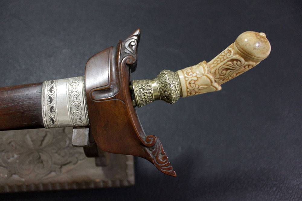

I enclose close-up of the Moro Kris Blade, as well as a picture of the original sheath.
Is the Kris Maranao, Maguidanao or Tausug?
Old 11th June 2017, 04:59 AM   #22
Posts: 4,736
Alexish:
The pictures you posted in #9 and #10 of this thread were not present when I made my initial reply in #12. Perhaps they were still in the Moderation queue at the time I posted.
As I read your comments, the ones that you showed at the top of the post were based on/adapted from the hilts and scabbards in posts #9, #10. Just to further comment on what David said, the examples you show in #9, #10 are indeed recent Moro work, but the ones that you first posted are clearly not.
Ian.

Dear Alexish,
Thank you for posting the close-ups of the blade (in #13 and #21) . I think it's a fine blade and I won't mind having than in my collection.
Regarding the hilt and sheaths, I think that the workmanship is commendable however, the style does not conform to traditional Mindanao/Moro design. To the initiated, it would stand out as Indonesian style, as others have already pointed out. I agree with kai's observations in #15. These are not the work of Mindanao/Moro craftsmen.
Despite that, I still think they are nice and unique.

Old 11th June 2017, 07:46 AM   #26
Dear Alexis, [or is it Alex/Alexish?]
Thanks! Pics of the other 3 would certainly be of interest, too!
That's a genuine Moro kris, probably from around the turn of 19th/20th century or a tad earlier. The sogokan may be a bit stiff but otherwise is looks like a really decent example of approx. average quality - I'd love to see the laminations upon re-etching!
I'm inclined to believe that this is a Sulu blade; OTOH, this style is usually associated with Maranao origin and this would be one of the latest examples of this type I remember seeing from Sulu. The scabbard is from Mindanao though...
One last comment: The original fittings of this kris from post #21 seem pretty much intact. I'm sure with a little TLC they will look orders of magnitude more appropriate than any modern dress! And IMHO more beautiful (despite average materials and craftsmanship)!
