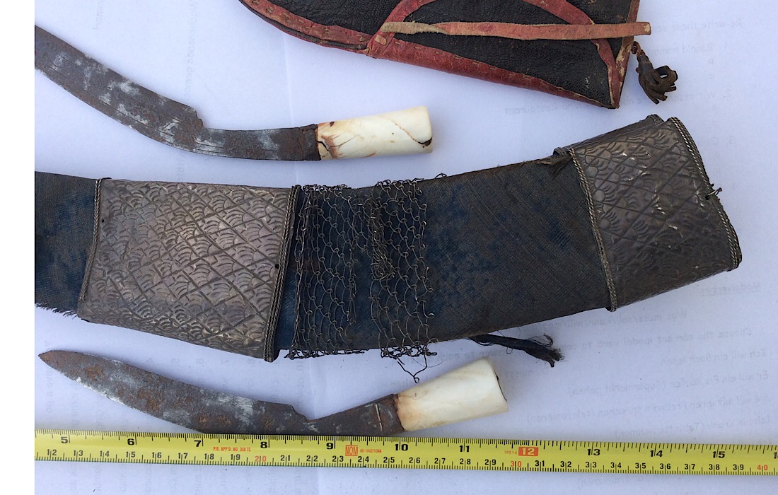

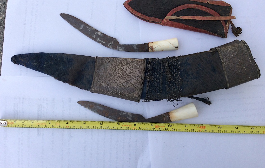

Hi
I am looking for information on the following
It looks like a khukuri scabbard of sorts
No main knife but the two knives and the pouch were present

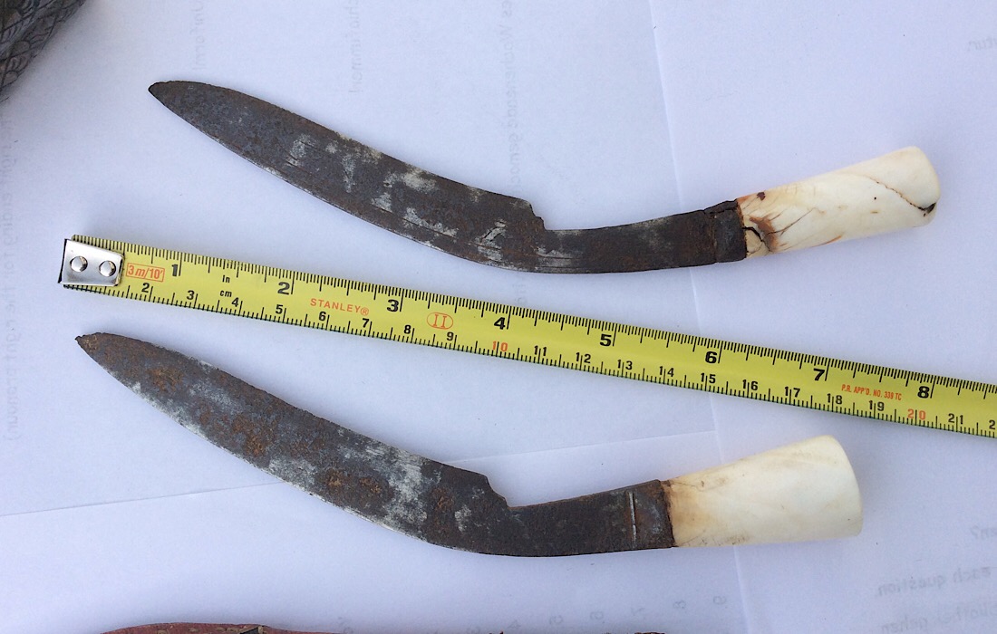

The small knives are 7 inches long and the metal seems of good quality
The handles are ceramic like they feel like marble or stone, it is shiny to look at and quiet resilient.
Would anyone be able to tell me more wrt origin or anything at all really.

I think you have a very old style Kukri scabbard which I downright envy! The two auxiliary knives karda and chakma probably have hilts of shell, as in shellfish shell, more often seen on Philippine and Indonesian items. What a pity the Kukri is gone.

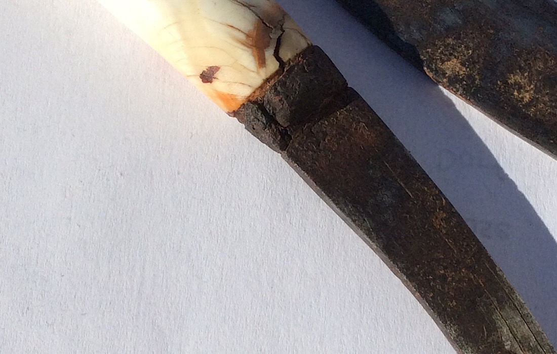

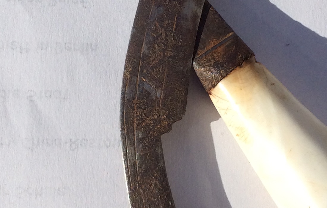

I tried handle with a hot needle and it is impervious
Handles are v cold to the touch and look like they would shatter if you hit off the ground. Where the tang comes through the ends there is some metal showing in the shape of a c.
The material could be tooth but in all honesty it does not look organic.

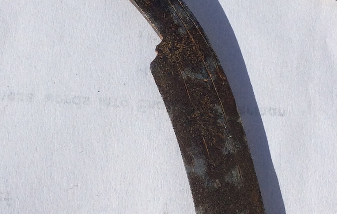

I have attached more images and also forgot to mention there is some decoration on the blades, which I have photographed.

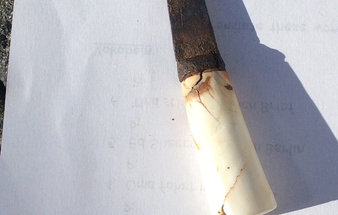

These are very nice...some what lacking in condition but given the rarity of the knives, hilt material and the design of the sheath, I think they could be late 18th century.

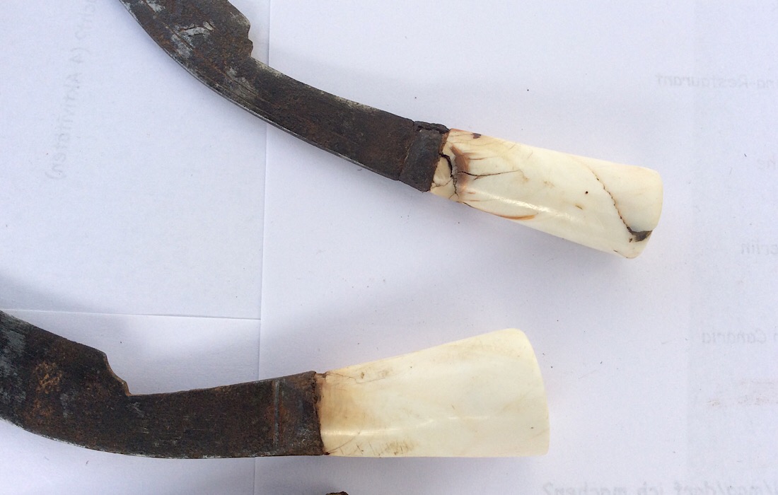

The hilts are shell, however, they are not tridacna.
Tridacna are giant clam shells, these clearly have the spiralling rings of a conch shell.
Gavin

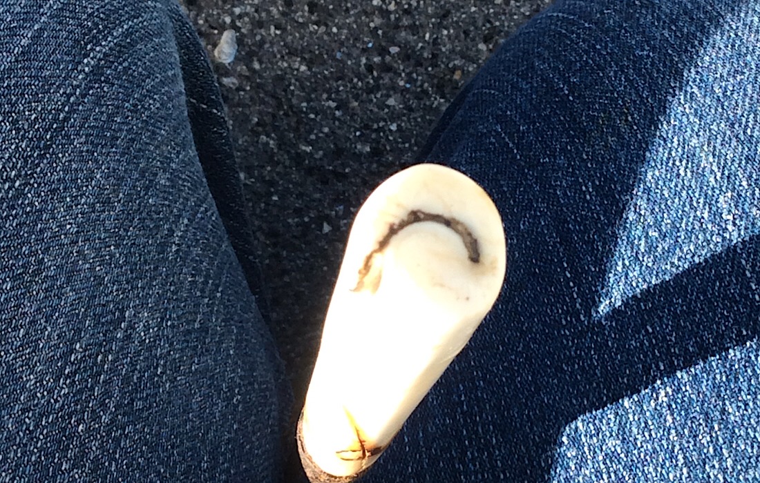

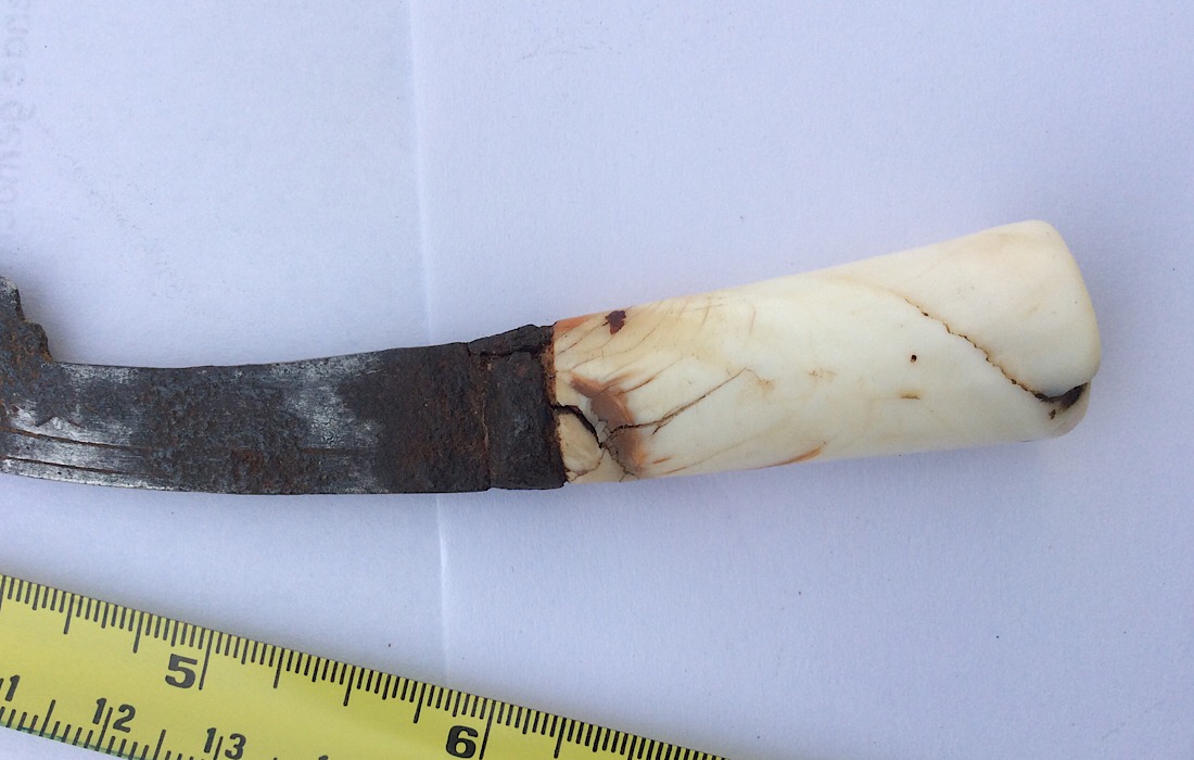

Gavin, you're spot on with the smaller hilt - apparently crafted from the center of a large marine conch shell (as you know, these did got traded into the Himalayas). The larger hilt seems quite massive - a close-up of the tip may help...
Thanks Kai,
throw your eye over the first post, third image...clear spiral to me.
Gavin

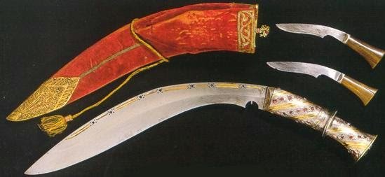

just for interest, here is a modern khukuri from a nepali mfg. based on the older ones before they had a proper cho (aka kaudi or kauri). and an older quite ornate khukuri with similar tools.
normally the two tools are a karda, a small sharpened utility knife and the other an unsharpened but similar sized and shaped one, the chakma(k) with a thick hardened edge used to 'steel' a dinged edge back to shape or with a flint, to start a fire.

Hello Gavin,
Yes, it seems so but the 4th pic (close-up) is less convincing. The top partly visible in the 3rd pic does indeed suggest the same structure though...
