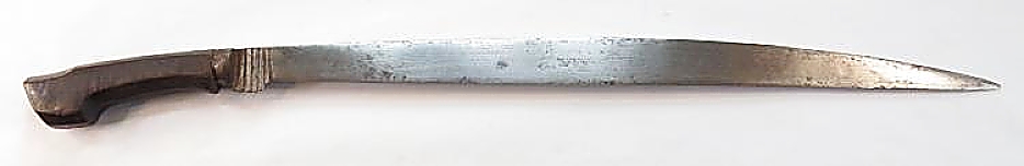

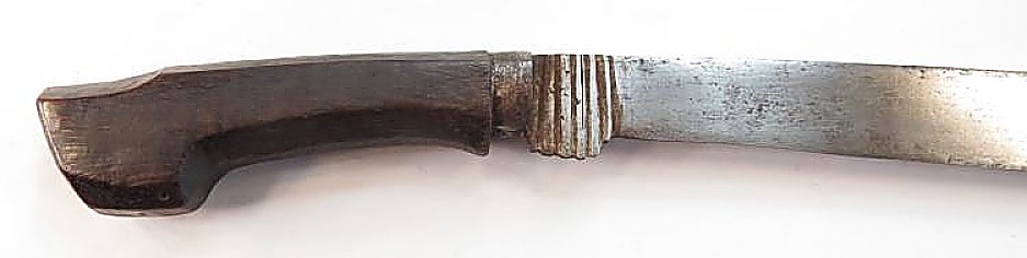

THIS GRADE OF EDGED WEAPON WAS NO DOUBT COMMON IN THE PHILIPPINES AND CARRIED BY THOSE WITH LITTLE MONEY AS A WORK KNIFE AND WEAPON. WE SELDOM SEE THEM ON THE FORUM BECAUSE COLLECTORS WANT THE BETTER GRADE WEAPONS WITH ALL THE BELLS AND WHISTLES. THE SMALL ONE WITH THE WAVY BLADE WAS LIKELY FOR PROTECTION NOT WORK AND I WOULD CLASSIFY IT AS A GUNONG AKA PUNAL. THE LARGER ONE IS LIKELY A FORM OF MATULIS . I HAVE SEEN A FEW PHILIPPINE KNIVES AND SWORDS OF THIS SIMPLE QUALITY OVER THE YEARS BUT THEY ARE NOT COMMONLY COLLECTED.
NO DOUBT THESE WERE CONFISCATED BECAUSE OF SOME TROUBLE IF THE SHERIFFS RECORDS COULD BE FOUND IT MIGHT MAKE AN INTERESTING STORY. PERHAPS (THE PHILIPPINE TONG'S OF HAWAII)
#1 & #2. MATULIS
