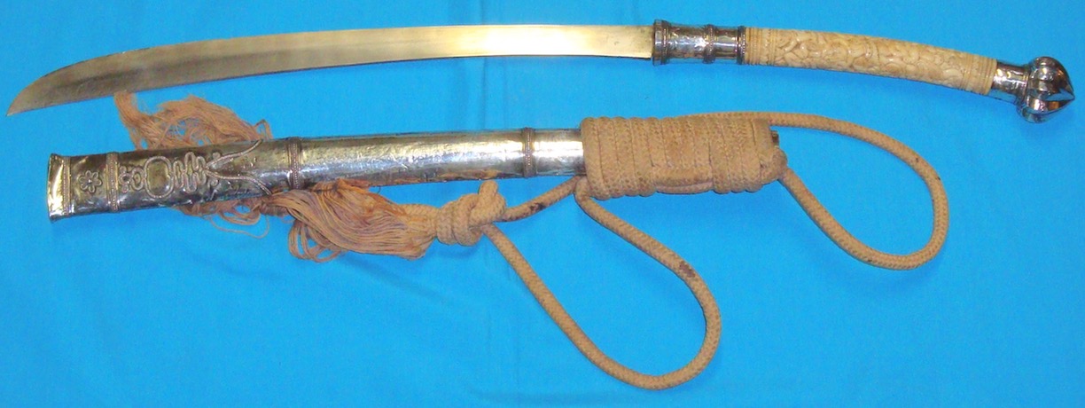

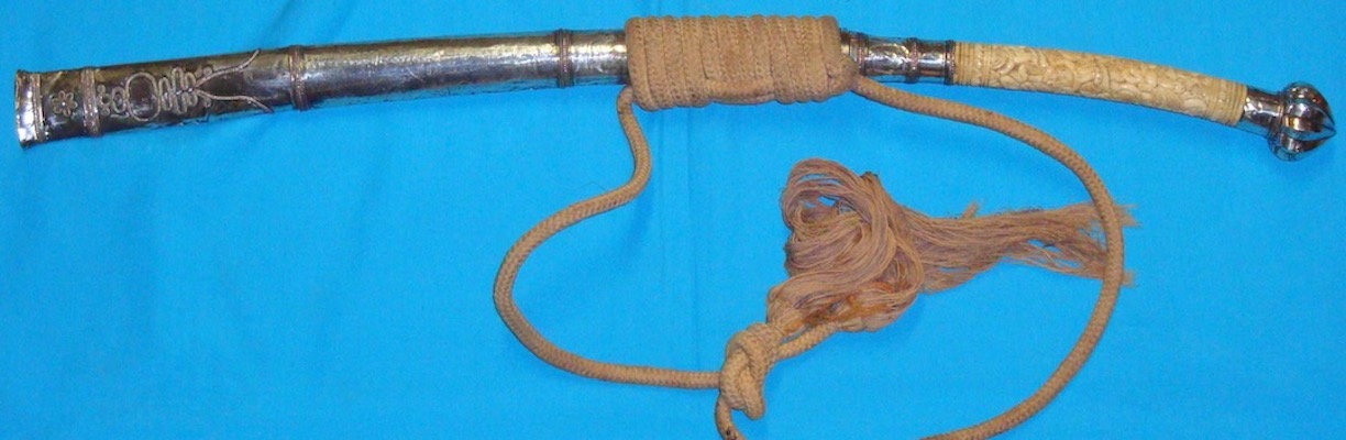

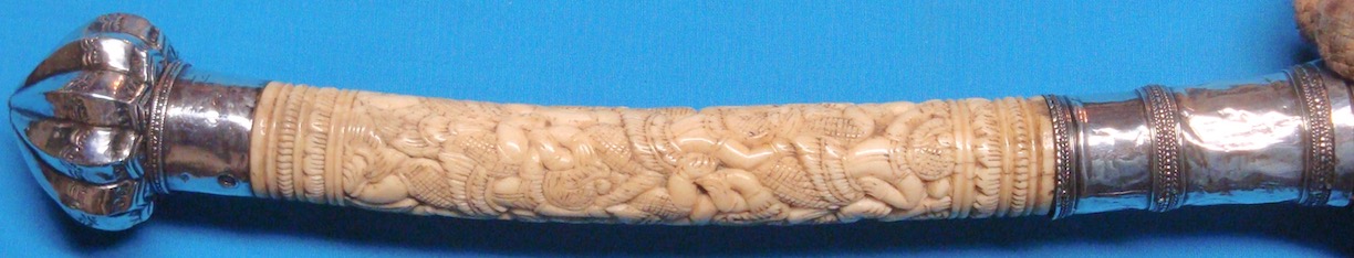

Here is a dha I got from a friend. The hilt is carved ivory with a silver onion pommel and ferrule.
The blade appears to have some differential heat treatment.

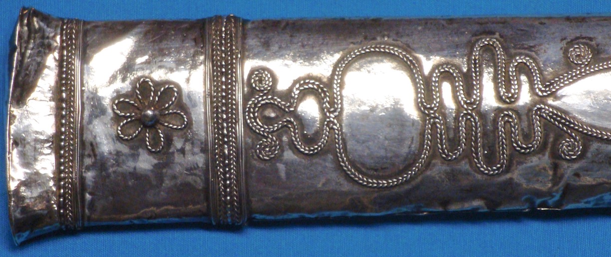

Regarding the scabbard, it is wood covered with very thin silver with silver filigree.
I am thinking this is Burmese, but not sure if it is Shan or not.

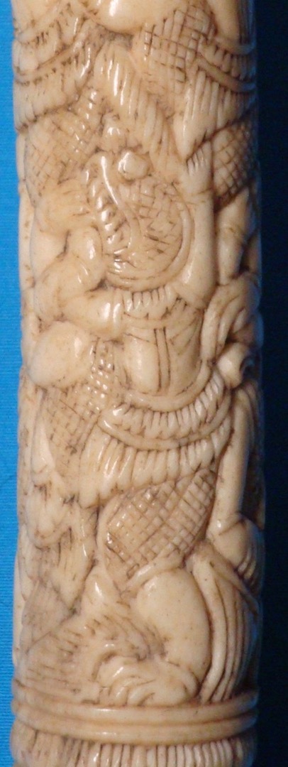

Also, the carved figures on the ivory hilt - are they demons? What are they? (see last picture).
Finally, I am thinking this is late 19th century - what are your thoughts?
Thanks in advance.

Hi Jose.
A very nice Shan dha made in the Burmese style with an intricately carved ivory hilt.
The carved ivory hilt says Burmese. The v-ground blade (no deep fullers), the large lotus bud pommel, and the silver covered scabbard with flared, blunt toe all say Shan. The Shan made high quality blades with hardened edges, so that is consistent too.
This is a prestige piece made more for show than use, so it is surprising to find a hardened edge to the blade. Perhaps an important blade reworked with high quality fittings.
The carved figures on the hilt are most likely "nats"--various Burmese (Bama) spirits that can be helpful, mischievous, or downright nasty. These nats need to be appeased with offerings, etc. or they can do you all sorts of wrongs.
Would you mind showing more detailed pics of the blade, its edge and the tip?
Late 19th C sounds right for this one.
Congrats on finding a very nice dha.

The carved motif I've seen before several time..it's like a Monkey tower :P I don't know if I think of them as Nats, as those are usually human spirits? But the monkey army from the Indian epic, Ramayama which spread in popularity through SEA, Buddhist and Hindu regions of present day Cambodia, Laos, Thailand and Burma, including former Hindu regions like Indonesia and Malaysia. It's a symbol of strength and protection. The most well known monkey from the epic people maybe familiar with is Hanuman.
