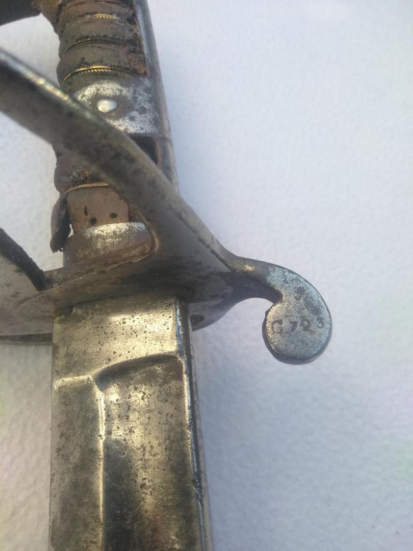

Default Portuguese cavalry saber

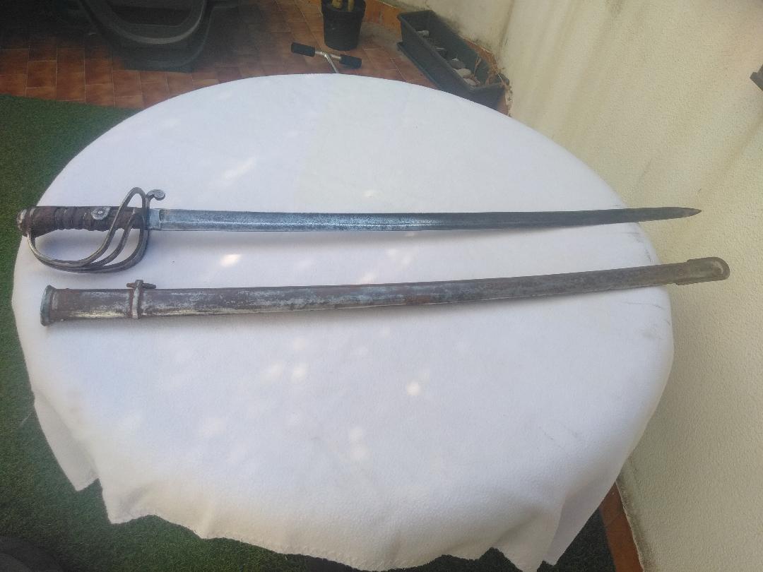

A Portuguese cavalry saber with marks, opinions (Fernando you are a specialist on this i welcome your appreciation) ?
Tks!

Looks like Charles Reeves, Birmingham.
Old 16th October 2018, 04:55 AM   #3
Posts: 10,872
Surely an anomaly.

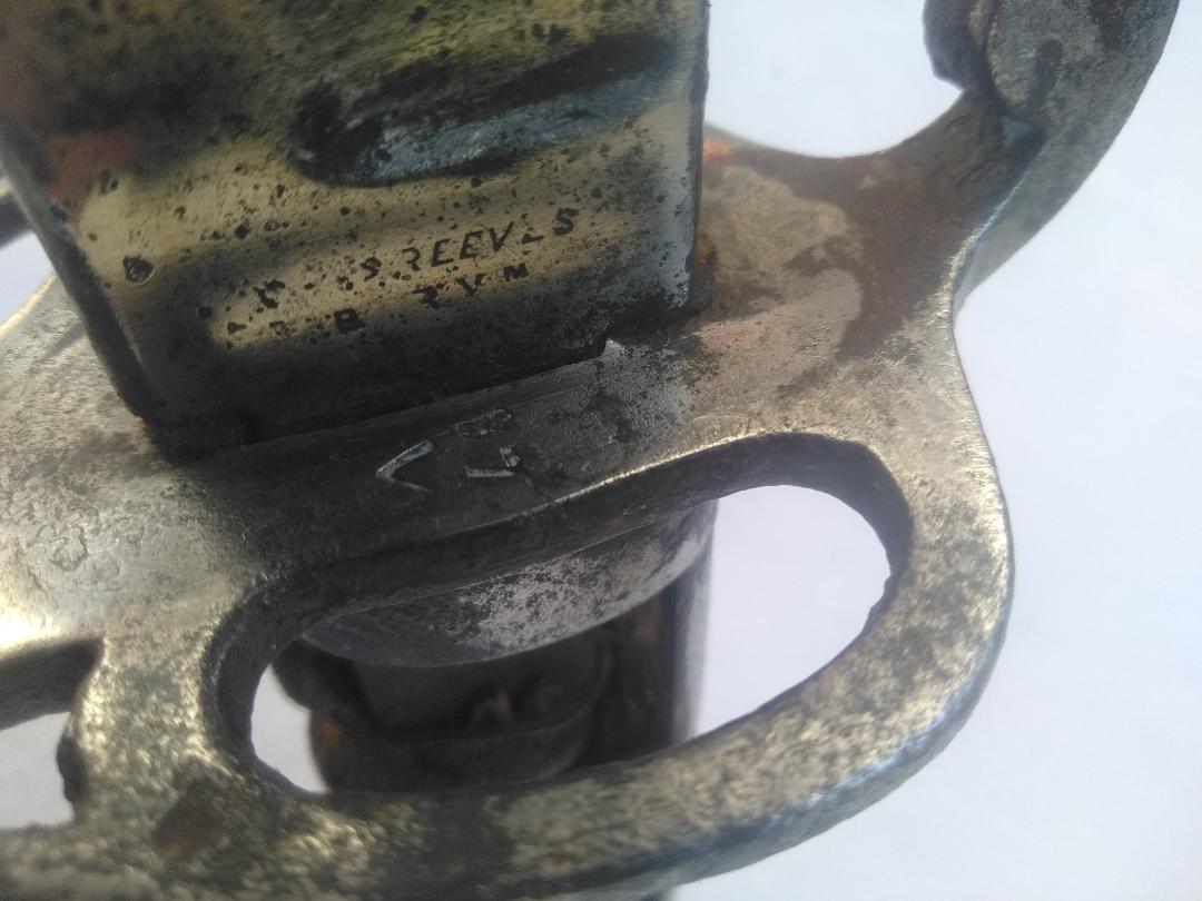

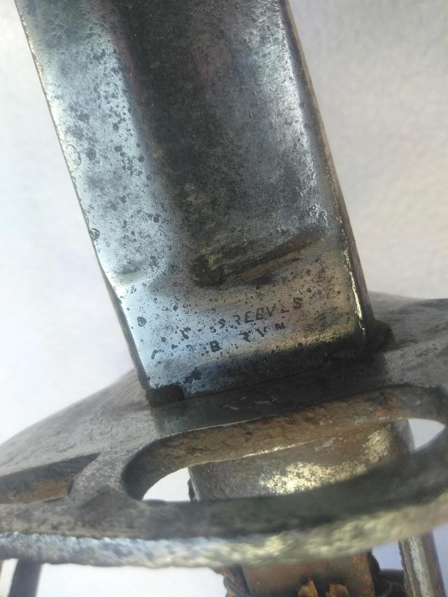

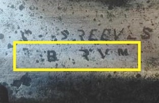

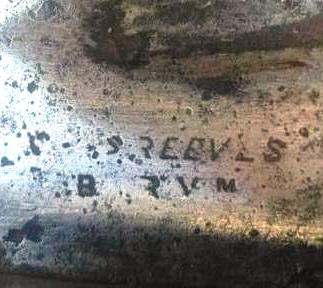

Charles Reeves is believed to have begun with partner Joseph Greaves in 1829. While the blade marking is inconsistent with the manner of stamping blades at this time...usually on the back near the hilt.....this example is apparently a sword made for export to Spain.
It is of the M1821 regulation pattern for light cavalry, which had interruptions in production until 1829, when these were produced in number. They were superceded by the pattern 1853.
The unusual stamp on the face of the blade REEVES and the abbreviated Birmingham at the forte is as these were marked. It is odd to see the 'ears' from the backstrap usually on the troopers M1829 while this hilt has the braided wire wrap for the officers cavalry sabres.
Also unusual is the single carry ring on the scabbard, which on British cavalry swords there were two until much later.

As you see Bruno, your saber is not Portuguese, and the specialist in its context is Jim.
I just wonder whether this model was exported to Spain and not (also) to Portugal. Just wonder, not documented at all.

I know the saber is not portuguese, most of the blades and sabers used by portuguese troops were made outside portugal... soligen, toledo, Great Britain....
My question right know is if this a export model or a pure british troops version!

I have only seen one of these offered by a very reputable dealer.....who I will not name as there are notable restrictions regarding commercial traffic here. In this case it was virtually identical with the exact same forte marking format down to the abbreviated Birmingham.
As the 1821 (1829) pattern was produced through the 1840s and not replaced until the M1853 pattern came out (ironically also produced largely by Reeves) it would estimate the period of this sword late 1830-40s. It seems unlikely that Reeves or anyone for that matter would produce these for export and in such an atypical manner:
1. the wire braid grip yet with riveted ears off backstrap.
2. the blade with such unconventional markings and abbreviation for
Birmingham. Also it is dramatically reprofiled if indeed a British
blade. The blade on these 1829 patterns was 35.5 " long.
3. The scabbard is with single carry ring....which is more suited for
a Sam Browne belt (sash) than the double ring carry.
The double ring carry on earlier scabbards was designed to be worn
low slung when as mostly fashion but some practicality for horseman.
The large surround on the chape is termed a drag as it is for doing so as
the cavalryman walked and scabbard tip scraped the ground....sort of like
jingling spurs (an old Texas thing) .
Obviously a sash carried scabbard and shorter blade would not require
a drag.
So is this a Spanish made example imitating the British? The Germans copied the M1796 British light cavalry sabre until they created their own version....the M1811 Blucher sabel.....perhaps the Spanish followed in this manner?
After seeing only one similar example I am not convinced of the Reeves export situation....but this is certainly an 1829 type sword....and in no way a sabre made for British troops.

This model was made in Toledo by a private entrepreneur called Ballesteros for the Portuguese army.

The model yes, might have been known to Portuguese forces but, this specific example doesn't appear to be a Portuguese import. In the place were these 'late' pattern swords used to be property marked by the Arsenal do Exercito (AE) there are digits worth of further reasoning, possibly those of a Regiment ?. Also that mark in the guard near the ricasso doesn't seem to be Portuguese. Interesting also the way Birmingham is initialized; doesn't seem to make sense.

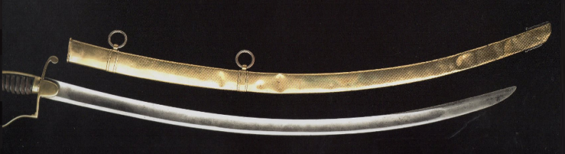

Ah ... the dragging swords (espadas de arrasto). It is said that fancy horsemen even reinforced the chapes (here also called mud guards) with iron straps, to make them last longer. Still in the extreme they reached severe wearing.
(Picture courtesy Eduardo Nobre).
And by the way Bruno, is it my eyes or that scabbard looks too large for your sword ? Probably the picture angle is tricking me

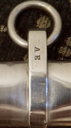

It would be interesting to know from Bruno whether the scabbard suspension loop has any marks in either side and if the quillon point has the AE initials in the opposite side of that #number. Also the length of the blade would be a vital detail.

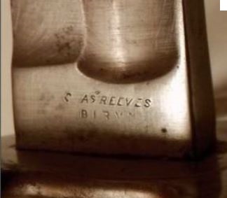

I would like to stand corrected in my reputing the REEVES mark in Bruno's sabre as a spurious one, judging by the 'Birmingham' odd initial system.
Having just spotted another example with precisely the same marking system and with the assumption that this was a Reeves export to Portugal (AE marks and all), my doubts have vanished. Despite clear evidence that Toledan Ballesteros also exported this model to Portugal, one would hardly accept that this was the case of the unit posted by this thread author.

About Fernando question i think all the material is original, and it doesn't have any AE mark... i think it's a portuguese used sword because the sword came originaly from a portuguese thomb... it was in really bad state, i just saw the marks after starting to restore it!

I will have to move toward correction as well as I was thinking that the application of this REEVES marking and BIRMN was not in the typical English manner, and that perhaps Spanish blades were being marked with a spurious signature.
In going through notes I have found that on 'export' blades from England, in the case of those to India, MOLE placed on his blades for tulwars (though in the case I found c. 1890s) at the upper blade quadrant at forte
MOLE
BIRMN
Obviously this was much later than we presume this sword as it is a M1821 pattern, but we realize that REEVES was producing most of the 1821/29 pattern up to the replacement with the M1853.
Actually about 1840s he was experimenting with a new type of tang which was a full tang with the grips attached to either side in a 'sandwich' fashion.
We may presume that by the 1840s, the old style blades (for 1821) were probably ceased in production and by 1848 he was using the new style with full tang for officers blades. The blade of the example posted here seems reprofiled in comparison to the original 35" blades.
While it was customary for English makers to stamp their name on the back of the blade near the hilt (this was done on other ranks blades to the end of the century). ......on officers blades a more elaborate makers panel was etched at the forte.
I thought this forte stamp with C S REEVES / BIRMN was out of order but after seeing the MOLE blade for India with the same abbreviation and on the face of the blade...I think export blades from Birmingham must have used the name and this abbreviation on the face of the blade in this manner. It would seem that the same maker in Spain producing similar hilts as the British M1821 must have had some of these Reeves blades.

Sory for the delay here are the details:
Blade - 84 cm
Full sword - 98 cm
Scabbard - 89 (and responding to Fernando it's the original i have no doubt it matches perfectly).
