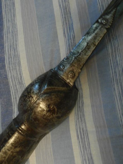

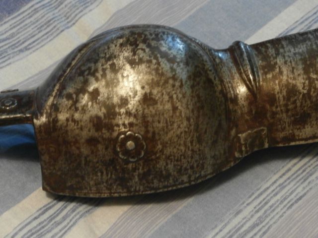

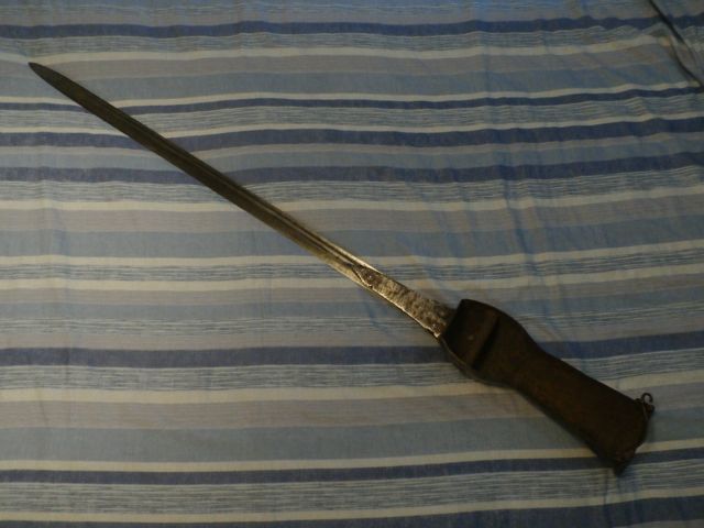

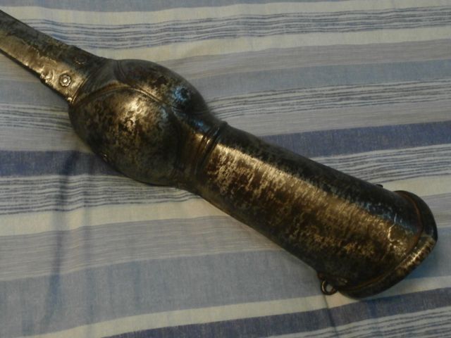

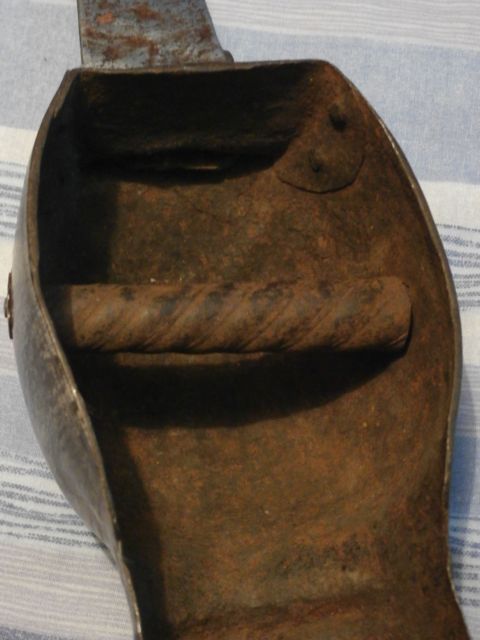

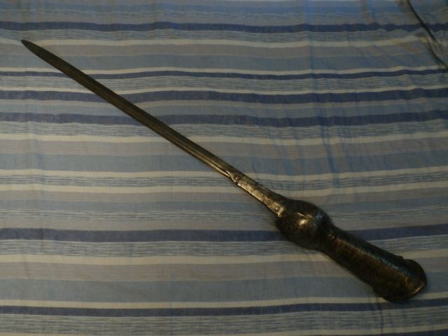

Inspired by Kubur's pata - here is a recent acquisition. A simple steel pata - some small losses to the gauntlet. Still in the condition in which it was received. My suspicion would be that it is of northern indian origin.

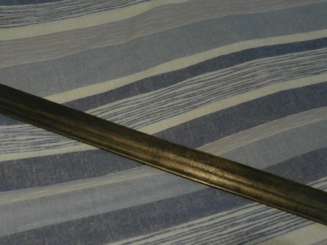

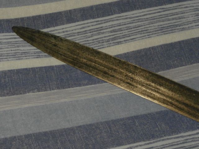

What interests me however is that the blade is single-edged. I've probably only held twenty or so of these weapons, so I acknowledge the test sample and my knowledge-base are both small, but I've only ever personally seen double-edged blades on these. Does anyone have any pictures of anything similar to this one shown?

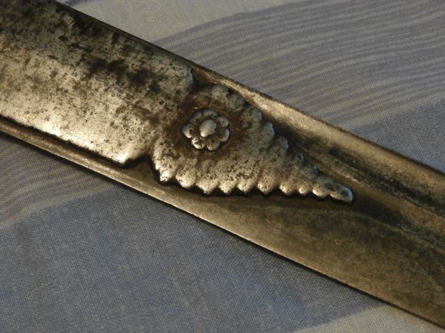

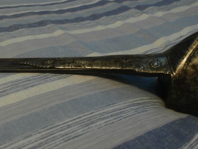

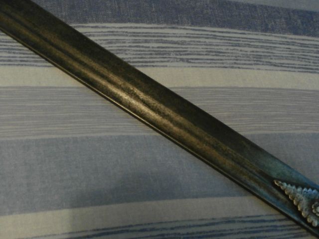

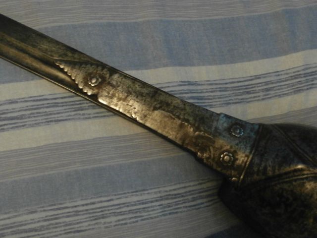

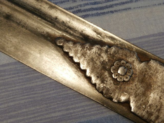

My first thought was that it was a double-fullered, european blade mounted on a local hilt. But closer examination altered my mind - specifically the fullers - if you look closely you'll see that the lower fuller seems to widen out to accommodate the shape of the langet. It almost seems to countersink it on both sides. Which must surely mean that the blade was forged specifically to/for this hilt? In the knowledge that it would have to fit a pata's extended langets. If it is a local blade it is very well made. If it's european-made perhaps it was specifically made as part of an order for patas? Has anyone heard of anything like this? I seem to recollect that Wilkinson made tulwar blades at one point?
There are no identifying marks visible on the blade - perhaps hidden under the langets.
The blade is slightly flexible, a little bounce in its extension. Nicely tempered, bends to at least 30º then springs back.
The sharp edge of course is on the outside for a right-handed grip.
All thoughts welcome.
Dimensions
Full length 49.5” 1255mm
Blade length 36.25” 920mm
Blade width 1.4” 35mm
Spine length 26.25” 665mm
False edge length 10” 255mm
Spine thickness near hilt 6mm
Spine thickness at false edge 2mm
Gauntlet length 13.25” 335mm
Grip bar 4” 102mm
Wrist width 2.75” 70mm
Forearm width 3.75” 95mm
Langet length 7.1” 180mm

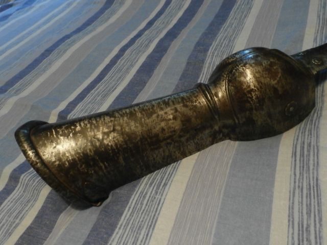

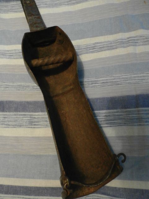

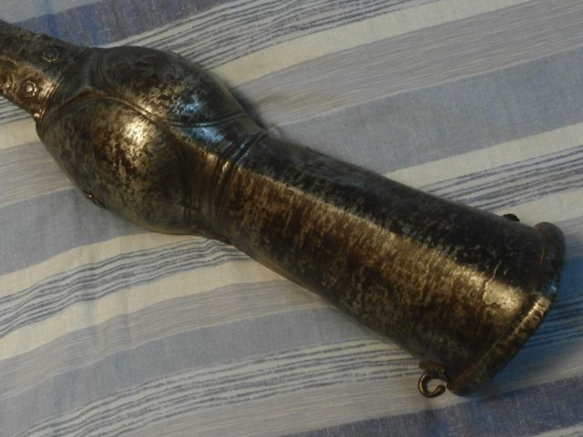

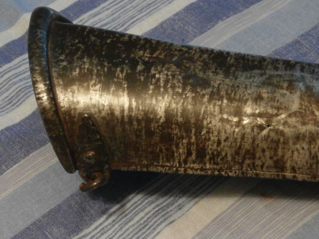

Some more pics;
Jerseyman is offline   Reply With Quote

Hello and thank you for this rather exotic example!
I have never seen a single edged Pata myself, so this is a first for me also.
As with regards to the blade, my bet would be on a European blade that was adapted to the mounts at the time of mounting. It wouldn't have been a difficult task to widen the already existing fuller to better fit the mounts to the blade.

Very nice. I really like the flower rivets securing the blade, and the helical pattern on the grip.
And up until now I was unaware that single-edged pata existed. Always nice to see something unusual.

In the hand it does seem to be a european blade - very consistent in construction. But of course difficult to attribute as there are no markings.

Hi Jens, yes we are still on '66' plotting our escape from blazing Arizona heat, in the new Bookmobile!!!
As far as I can say, this blade looks Solingen, but agree, hard to say more without handling or marks etc. Many Solingen blades were 'blanks' and shipped en masse to foreign markets. Such blades it does not seem were widely copied by Indian makers as they were so available it did not seem necessary.
I would point out that usually the single edged blades are referred to as backswords and double edged broadswords. However in earlier times into the 19th, the term broadsword was often used indiscriminately .
Solingen did not produce double edged blades for Scotland after 1745, but they did produce these kinds of single edged blades for British cavalry swords in the latter 18th c.
With the pata, just as with the khanda, the firangi blades would well have been used as available of course. In my opinion, the style of use of the pata would have typically favored the DE blade, and mounting one with this kind of blade simply a matter of availability.
