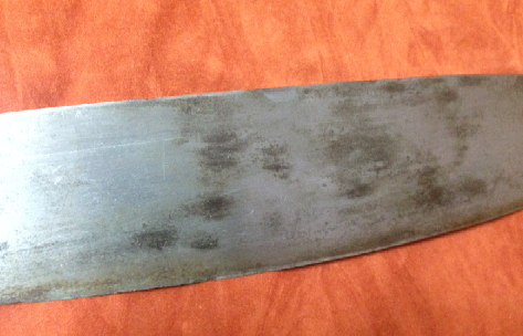

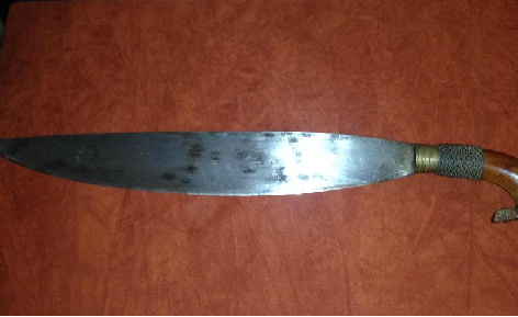

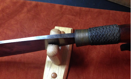

oldschldude
Join Date: May 2014
Posts: 17
Default barong pics
Hello.
I'm back with pics. Finally figured out how to compress photos using MS Paint.
Most info that I read about rust removal or blade restoration was on laminated Philippine blades. Didn't know if etching also applies to mono steal.
I'm attaching my barong pics that I would like to clean the blade. It started to get dark spots and small pits. I would hate to ruin it by improperly cleaning the blade. I would like to get rid of the dark spots and don't know if etching it would ruin the blade or change to different color. I will use warm vinegar if I will etch it.
I never etched a blade before, I only apply oil to preserve it. Most of my info in blade restoration I got here and I think this barong is mono steel. One question is, When did the filipinos start using leafsprings? WW2 era or before that like in Span-Am War. Thanks again everyone. Oldschldude
oldschldude is offline   Reply With Quote

Old 15th June 2016, 07:29 PM   #12
Hello Oldschldude,
the blade from the Luzon sword in up I've cleaned with sandpaper only, by such a rusted blade you can start with 80 and can end with 1000 to get a nice smooth finish but know people which go higher.
Your barong blade don't seems to have bad rust so I would start with 120 or 160 paper. I bet that your blade will show lamination, look close to the spine if you can see lamination lines.
I wouldn't clean such a blade with any sort of acid like pineapple juice, the blade will get a grey/dull surface and it will need a lot of polishing to get it away again. The sandpaper you can use dry or with oil. Before you start to etch a blade clean it with aceton to remove all oil and grease.
Thank you for the compliment.

Thank You for this information. I think I got a grip now on how to restore or preserve Filipino blades mono steel or laminated. The same process for both.
Either to etch or not to etch after polishing and the kinds of acid/techniques to use and their effects for etching. Also to restore or just to stop the rust or just leave it alone(oil) if blade has provenance of importance as someone on this forum mentioned. I will post pics before and after of this barong.
