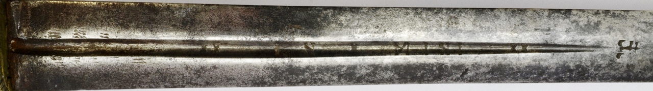

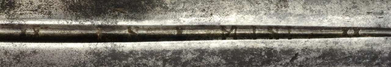

Hi Guys
I recently picked up this brass hilted small sword circa 1680-1720 I think. The blade does have letters in the fuller and the typical anchor mark but I need assistance to identify them and hopefully the maker. From what I can make out under a magnifying glass it appears to be XX L S X MINI XX followed by the anchor mark. Any assistance will be most gratefully received.
Cheers Cathey and Rex

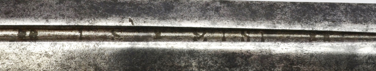

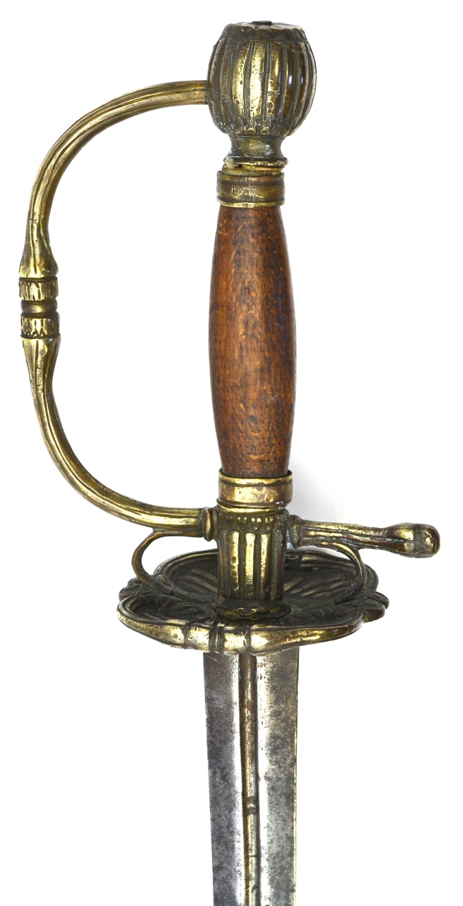

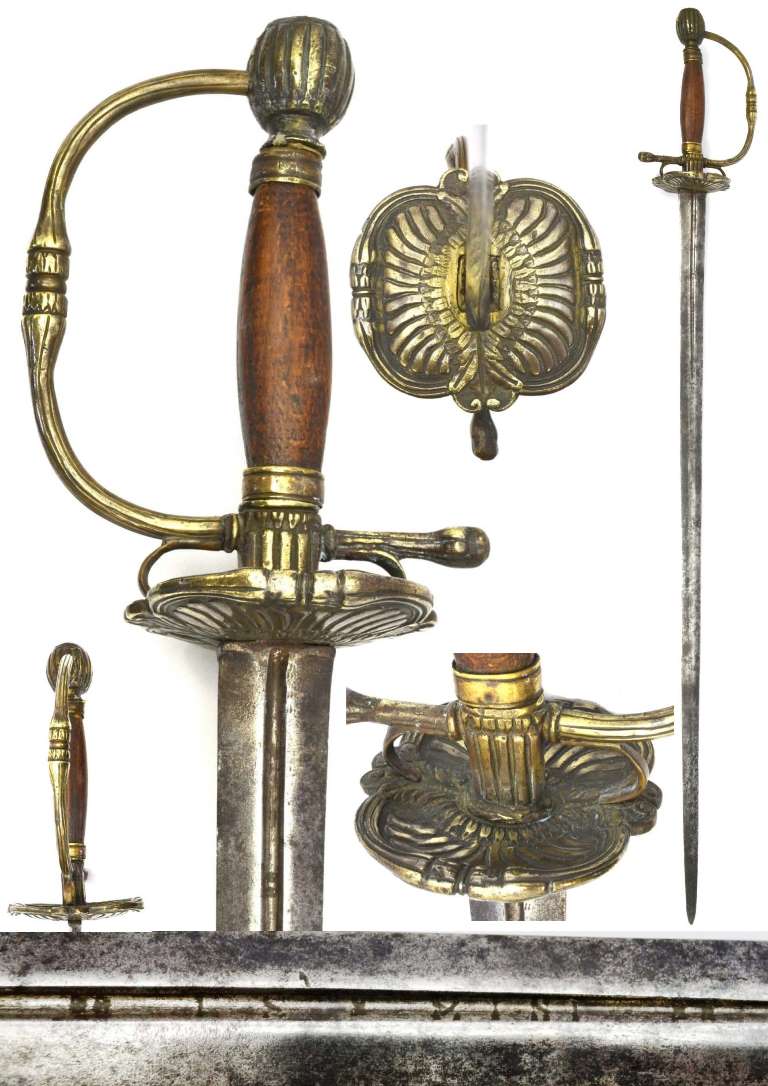

Hi Guys, just revised the details on this sword, still seeking assistance with blade markings.
Transitional Rapier with marked blade
I recently picked up this brass hilted transitional Rapier/Small Sword circa 1680-1720 I think.
Overall Length: 38” 96.3 cm
Blade length: 31” 78.6 cm
Blade widest point: 1 Ό” 3.2 cm
Hilt widest point: 5” 12.7 cm
Inside grip length: 4 Ό” 10.5 cm
Marks, etc.: engraved XX L S X M I N I XX
The blade does have letters in the fuller and the typical anchor mark but I need assistance to identify them and hopefully the maker. From what I can make out under a magnifying glass it appears to be XX L S X MINI XX followed by the anchor mark. According to AYLWARD, J.D. THE SMALL SWORD IN ENGLAND its History, it’s Forms, its Makers, and is Masters pp 64, 74-75 brass hilted small swords often had earlier rapier blades cut down. Looking at the width of the broad sword blade I think this is such an example. Any assistance identifying the signature in the fuller would be gratefully received.
Cathey is offline   Reply With Quote

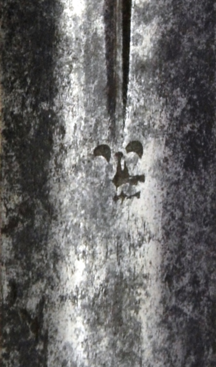

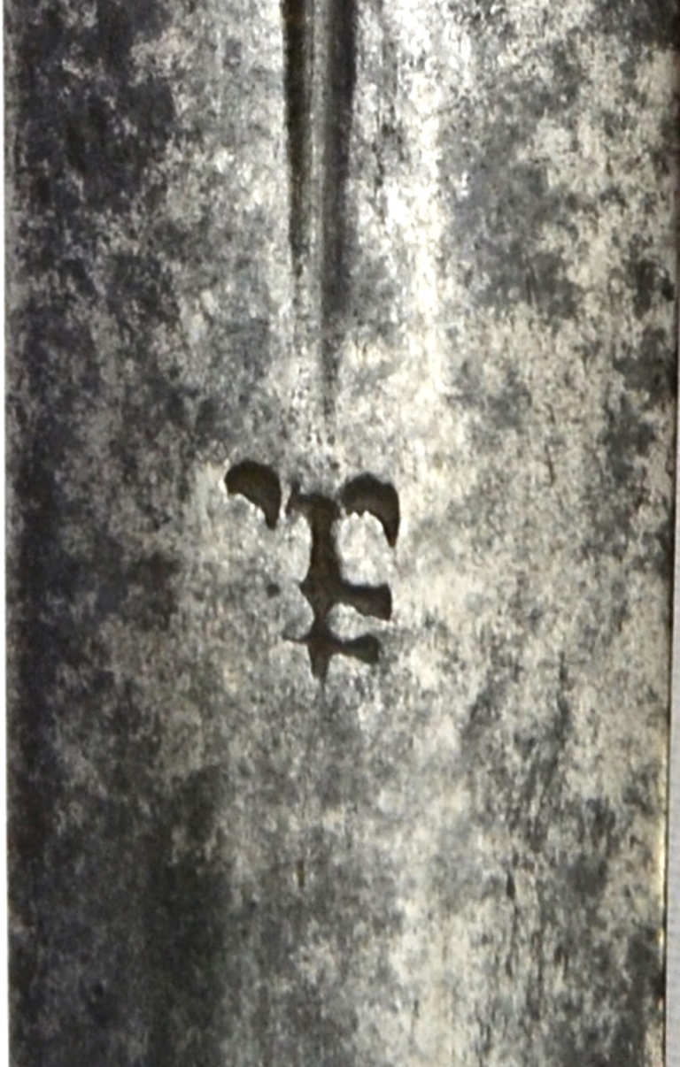

I am curious on the 'anchor' mark, any chance of an image?
While they seem to be often thought of as standard, there are sometimes variations.

Cathey, I just wanted to update the research I have been working on concerning the marks on your blade. Actually these marks or more accurately, inscription, are not likely to represent a particular maker of your blade. As I indicated in my earlier post, I think your assessment of latter 17th century and a transitional rapier blade is well placed.
There would seem to be little doubt this is a Solingen product, but interpreting the actual meaning of these letters is more of a conundrum.
The authors Wagner, Worley, Blennow and Beckenholmen in their 2009 article, "Medieval Christian Invocation Inscriptions on Sword Blades" (Waffen und Kostumkunde, 51(1), pp11-52) claim,
"...maybe these inscriptions are early examples of a mixture between vernacular and Latin elements as an imitation or reinterpretation of older blades whose strongly abbreviated inscriptions were incomprehensible to the contemporaries". (p.38)
While obviously this perspective refers to much earlier blades however I think the same axiom applies.
As I also mentioned in my earlier post, a curved blade mounted in a cast brass 18th c. hilt has the inscription:
X EN X MENE XX
(posted by Fernando 12Dec 2007)
This exemplar clearly iilustrates similar type inscriptions were used by apparent Solingen makers in the 18th c. thus most certainly some time earlier. While the term 'mene' is Latin, the 'en' seems to represent Spanish for 'in' while German would be 'ihn',
The term 'mena' could also refer to 'numbered' as with ancient Jewish coins as described in "Belshazzars Feast " (Daniel 5: 30-31) which includes the passages of 'the writing on the wall', " MENE MENE TEKEL PARSIN".
The 'mena' also was termed 'mina' in it seems various instances.
The term 'MINE' could refer to the Papal Bull of 1059, IN NOMINE DOMINI, which dealt with Canonical law .
Wagner and Worley note that the formulae (In Nomine Domine) and cross potent appear consistently in invocation lines of almost all diplomata (legal acts).
While more tenuous, Wagner and Worley (op cit. p.46, #61) note that the letters I S represent abbreviated Latin word 'ius' (= right, law).
Is it possible this LS might be IS or related ?
Further.......L.S. = locum sigillis, or place of the seal. Appended to
signature of legal documents.
It is doubtful that LS would be the initials of a maker as they would not be part of the configuration of such an invocation .
The 'anchor' just as the cross in these kinds of invocations was used to enhance or emphasize the talismanic power or imbuement in such inscriptions and invocations.
While certainly these details are entirely circumstantial and cannot offer, or enlighten the dilemma of any accurate translation of meaning in this case,
it is the best I can come up with. As seen in the resources I have noted, as well as others such as Wallace Collection (Mann, 1962); Oakeshott (1961) et al. ..most of the interpretation of these kinds of inscriptions is largely supposed, with a lesser number accurately recorded.

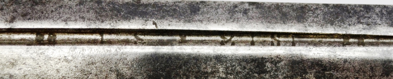

I don't mean to disparage Cathey's eyesight, but from the photo's I would have read this as xx LS x XISI xx. I realise the second S is different from the first, but could the first be an N? Anyway, If this was so, would it make any interpretation easier?
Richard

IX XINI
is the name (of a bay and) watch tower build in 1661 on the Maltese island of Gozo, ruled by the Order of Saint John, this is one of the last build towers which served as a safe harbour for visiting ships and to protect and safeguard the bay and the Gozo Island.
Malta was ruled by the Order of Saint John under Sicily from 1530 to 1798.
best,
Jasper

Excelent shot Jasper but ... do you mean to say those are (all) the letters inscribed in Cathey's blade ?
Old 5th May 2016, 01:23 PM   #11
cornelistromp
cornelistromp's Avatar
Join Date: Mar 2009
Posts: 1,071
Hi Fernando,
yes I read IX XINI
best,

Jim, I have attached close ups of Anchor mark for you, and the more I look at this sword the more I agree it has a cut down rapier blade.
Richard, how did you know my eyesight is not as good as it was? I must confess my translation of the letter was my best guess. I am more than happy to explore the possibility that the inscription is xx LS x XISI xx.
Jasper, if the letters are IX XINI, would that make the blade Italian (Sicily) do you think?

Hi Cathey,
Thank you for the added look at the anchor, which is heavier and more blockish than Spanish examples used in 16th to early 17th c. While some authorities on Spanish swords consider the 'anchor' a Solingen convention, the rapier with blade from the prominent Alonso Perez with his distinctive anchor at the fuller terminals was found on the 'Atocha' wreck.
The Atocha went down in the Florida Keys in 1622.
Perez worked 1570s to c. 1625.
The association with the inscribed Latin words to Malta and the mention of Sicilian rule really do not, in my opinion, suggest this to be an Italian blade. Actually I am not aware of blades made in Sicily, but it is sometimes confusing as Sicily was typically ruled along with predominant states on the Italian mainland.
As Jasper has noted, The Knights of St. John (I believe also known as the Knights of Malta), ruled Malta. The Knights of St John interestingly were also well situated in Solingen.
That puts this blade nicely in place with this term, and the building of this tower in 1661 seems in period with these blades.
The neoclassic hilt of mid to later 18th century reminds me of French forms I have seen, and it is to wonder if perhaps this was a heirloom blade with connections to someone well connected in these orders.
