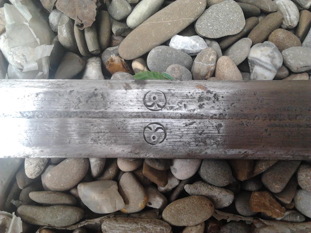

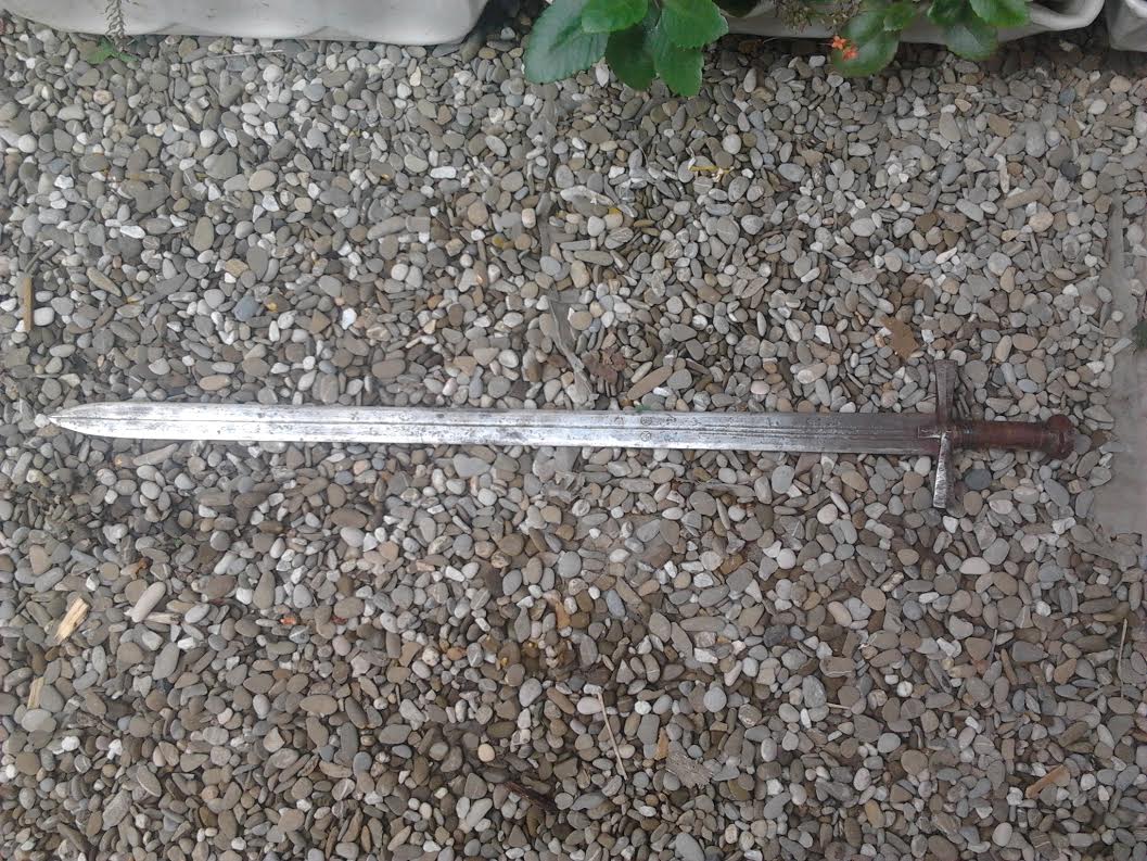

This sword is brought from England.I am impressed with its patina.They are on the blade by two pictures of the month.Heard is made in Africa.How old is the sword? Thank you.

It may be mahdist, but I am more inclined to say 20th century.
They are still made there, AFAIR ( remember:-): haven't we had an article on modern kaskara production in Sudan? ( I am awfully bad in search).

You are right in that this is a kaskara, the standard sword of the Mahdists in those campaigns, but used traditionally into modern times.
However, this is actually more modern interpretation (I believe termed 'Kasallawi' for the region in Sudan these became produced after WWII)
The highly stylized discs on the blade represent the crescent moons used by Hausa smiths in the 19th century, and are now degraded into stylized examples as seen here.
Indeed there is a brilliant article written by Ed here on sword and knife making in the Sudan (in articles archived) and Iain is our resident authority on these swords in the broader sense.

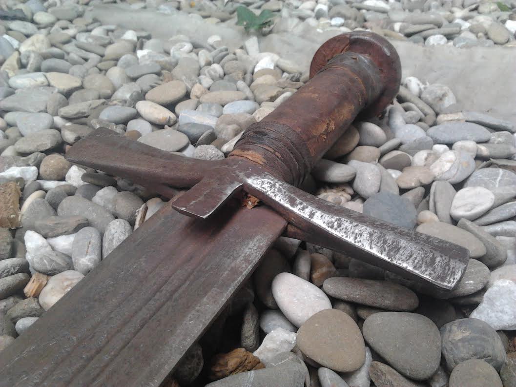

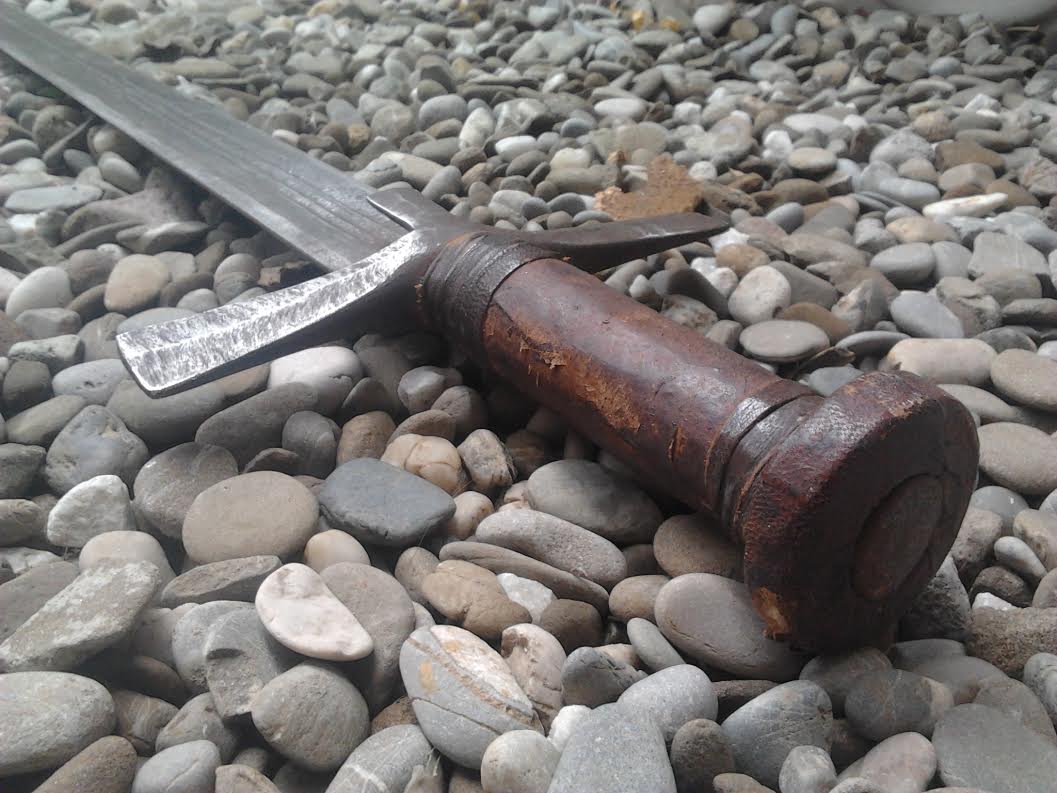

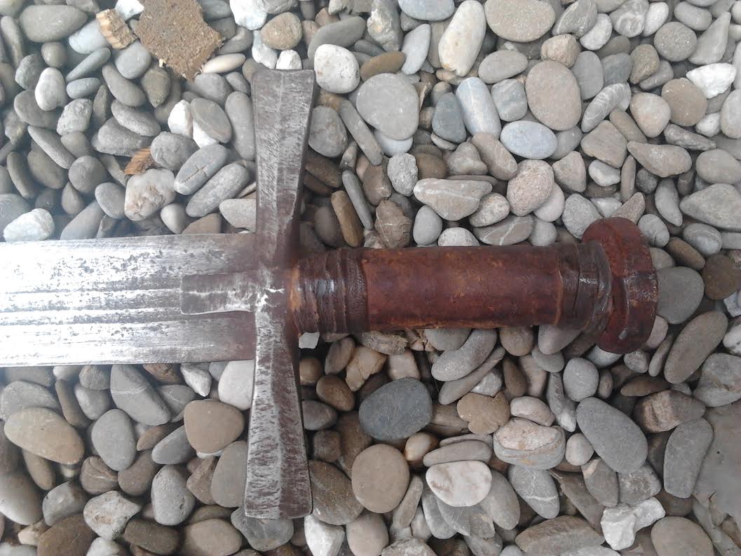

My guess in mid-20th Century, but could be in a wide range. The blade is fairly "standard" looking, but since the metal and technology has been the same since the British occupation, it could be any time during that period. The grip isn't Hadendawa style so that leaves out Kassala. The maker's mark uses a different sent of punches from those shared by the Kassala smiths at least in the 1980s. The cross guard in more in the Sennar style and forged with the center ridge. Patina might put in in the earlier part of the 20th. Any idea when it was brought back to England?

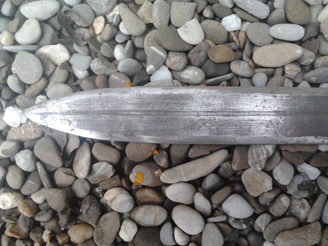

Good points Ed, the simpler hilt and leather bound could suggest earlier in the century, but the 'dukari' type paired devices on the blade as you note could be 'Kasallawi'. Also of earlier style (I believe) would be the central fuller running full length of the blade.
Possibly these 'dukari' added later to earlier sword?

Good eye, Jim. Indeed the "dukari" doesn't appear to be scratched as the rest of the blade in the area and could have been added later. I have a attributed Mahdist sword with a similar central fuller, but with Koranic, moon and lion "engravings". Maybe we could push the date to earlier 20th Cent.

The construction is rather crude and shows little of the finish of earlier pieces. I'd be with Ed 100% in dating it no earlier than the 1950s and most likely later.
Particularly the guard is crude with obvious tool marks, the half moon marks are of a particularly degenerated style and the fullers on the blade are ground not forged.
