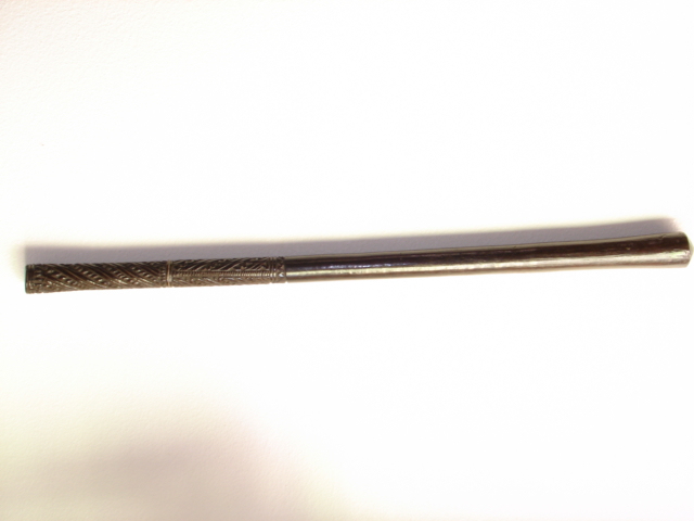

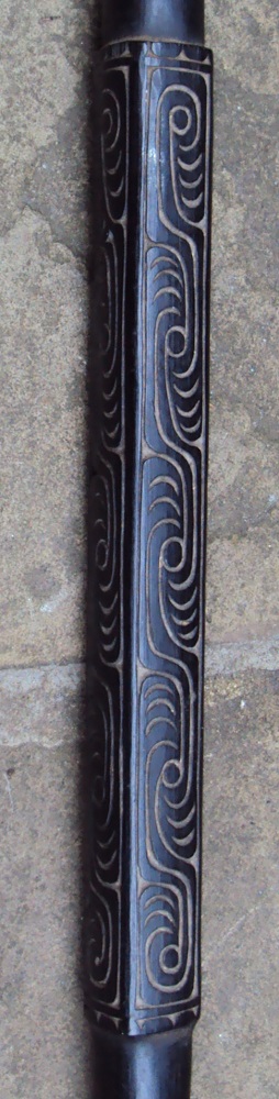

Hi Folks,
I have enjoyed your site for several years,and now a new member.Thank you for letting me on board.Great Stuff!!! I am starting my first post with a very short pole club that I have always assumed to be of Fijian origins.The club is 25 inches,and made of a very dense black Pacific hardwood,which also appears to be stone/shell carved.The handle is carved in a much different form than the usual.I have a modest collection of tribal art,and this differs in the style than the 60+ oceanic clubs in my group.I have seen some Fijian clubs with Tongan,as well as Maori motifs/designs,and wanted to get any opinions that one may have? Thank you in advance.Michael

WELCOME TO THE FORUM WE ARE ALWAYS PLEASED TO SEE ITEMS FROM OTHER COLLECTORS AND TO GAIN AND SHARE KNOWLEGE. THE CLUB YOU SHOW IS A VERY NICE ONE WITH A INTERESTING CARVED DESIGN SIMULAR TO WHAT I HAVE SEEN FROM FIJI BUT PERHAPS WITH TONGAN INFLUENCE DUE TO THE VARIATIONS IN PATTERN.
TWO FORMS OF FIJI POLE CLUB FIT THIS FORM THE BOWAI WHICH IS GENERALLY LONGER AND THE GADI. I PERSONALLY WOULD CLASSIFY THIS AS THE GADI FORM DUE TO THE SIZE AND FLARED STRIKING END.
SEE FIJIAN WEAPONS & WARFARE BY FERGUS CLUNIE PLATES 11 AND 10, TEXT ON PAGE 56. THE OTHER POSSIBILITY IS ON PLATE 18 WITH TEXT ON PAGE 58.
THE BOOK LISTED ABOVE IS THE BEST I KNOW OF FOR REFRENCE ON FIJI WEAPONS SO IF YOU DON'T HAVE A COPY IT WOULD BE A GOOD REFRENCE TO GET. A VERY NICE CLUB THANKS FOR SHAREING.

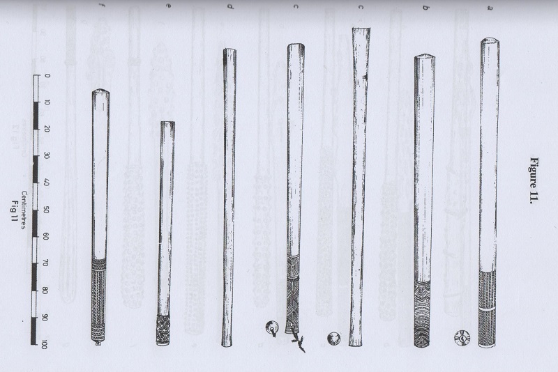

Very nice indeed. I would say 60+ like this is far from a modest collection!!!! I am adding illustrations from "Fijian Weapons & Warfare, Fergus Clunie"
You can see a great variety of handle decoration and I am sure this is not the definitive list. A pole club is a basic design and world wide. There is the possibility that it could come from other Polynesian Islands perhaps ruling out Samoa. As I say very nice and I look forward to seeing and discussing more. I have a staff/club coming in the next week and will and here even though it is Melanesian.

Thank you all very much for the kind welcomes,and thank you for your valued opinions.Thank you also for posting images from the Clunie reference.I do have the Clunie book,as well as many others that I have been able to find,regarding Fiji,and Pacific/Oceanic tribal art.I was of the opinion that this could be,what was referred to as a "wife beater" being so short in length? I do remember reading of such clubs in Clunie's book,or perhaps Fiji and the Fijians.I also thought the top half of the handle had a bit of what looks like Maori influence? 60+ clubs is really rather modest when one considers the vast variety/selection,and variations of clubs throughout the Pacific region.In Fiji alone,one might assume.....just by looking at Fergus Clunie's publishing,that with the many styles,and variations of clubs found in Fiji.......60+ is modest.Nevertheless...thank you all once again and I will hopefully return with some more queries in the near future.I am trying to post a few more images for those who asked.Thank you,Michael

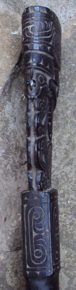

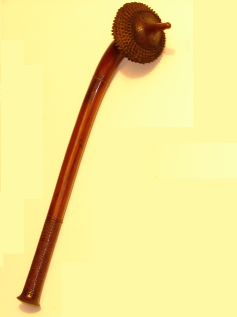

A NICE SELECTION OF CLUBS WITH A GOOD RANGE IN AGE. THE TWO TOTOKIA (BEAKED BATTLE HAMMERS) SHOW THE TWO FORMS OF SPIKE SOME SAY THE BROADER CONE SHAPE PREDATES THE LONGER THIN SPIKED TYPE BUT I WOULD NOT KNOW . IT IS GOOD TO HAVE AN EXAMPLE OF EACH. THE OTHER ONE IN THE SET WOULD BE THE TUKI (BATTLE HAMMER) THAT IS THE EARLIER FORM WITHOUT A BEAK.
YOUR LONG BEAKED EXAMPLE IS UNUSUAL IN THAT IT HAS DESIGNS CARVED ON THE STRIKING FACE WHICH IS SOMETHING I HAVE NOT SEEN. IS THE CARVING ON THE GRIP THE STANDARD FIJI STYLE PATTERN OR A MORE COMPLICATED PATTERN? THANKS FOR SHAREING I LOOK FORWARD TO MORE
THE STAFFS SHOWN WOULD SERVE AS A WEAPON, SYMBOL OF ATHORITY AND TO STEADY ONE ON THE SLIPPERY JUNGLE TRAILS WHICH I CAN TESTIFY CAN BE QUITE STEEP AND TRECHEROUS ON HIGH ISLANDS.
WOMEN WERE OFTEN FORBIDDEN TO HANDLE WEAPONS IN SOME SOCIETIES BUT COULD HAVE SUCH A STAFF TO USE THE SAME WAYS AND ALSO AS A DIGGING STICK. THE EXAMPLES SHOWN ARE NICE ONES BUT I SUSPECT MOST WERE NOT AS NICELY MADE.

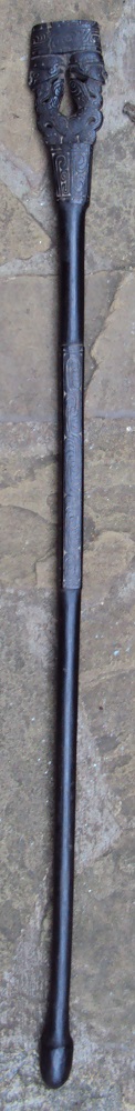

To follow on what may or may not be a weapon. Stout, Admiralty Island staff ? 164cm See it in fencing terms, a sword club. The handles are in the right place and the balance is excellent.

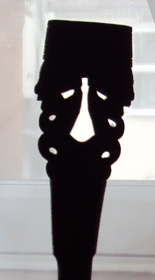

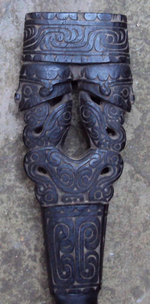

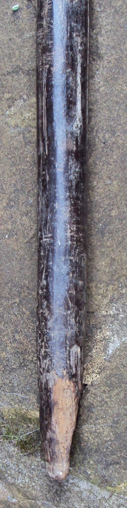

My new item has arrived and as I said, I add it here.
Before I do this a few more thoughts about the most elegant and beautiful lustrous club Dolly started the thread with. It could be that fine light weapons like this, could be more of a status, prestige rank item. Made for display. Very often the higher up the food chain a person is weapons often morph into non functioning versions. Rommel had a baton as did many of military big wigs.
All this brings me to my new item. I thought it might be a club as the sellers pictures were rather poor and they gave the impression that it was longer and heavier. However I am very pleased with what turned up. It is exquisite and probably the best thing I have in my collection. It is a prestige staff being far to light to use as a club. Also not at all comfortable in the hand as a walking stick. Held in the middle section is most comfortable with the very slight convex curve to the staff towards the body. When seen next to what are clearly club weapons, you can see that at 93cm long it is too light for fighting. The end shows no contact with the ground as with the clubs. One of the aspect I like most of all is the very artful gaps in the carving of the figures making the finial. One could see some symbolism here but I hesitate to take that any further. Also I find pleasure in the way the stylised frigate birds are so easily recognised. I will also add {as a reply} three pages from " Michael Hamson, Oceanic Art" In the text reference is made to a Harry Beran who after a net search I found is very big in the "Tribal Art" world. He refers to these as staff which I feel they must be showing no signs of ever being used as walking sticks. With a little bit of luck this thread might continue and bring more unusual Oceanic material to the surface.

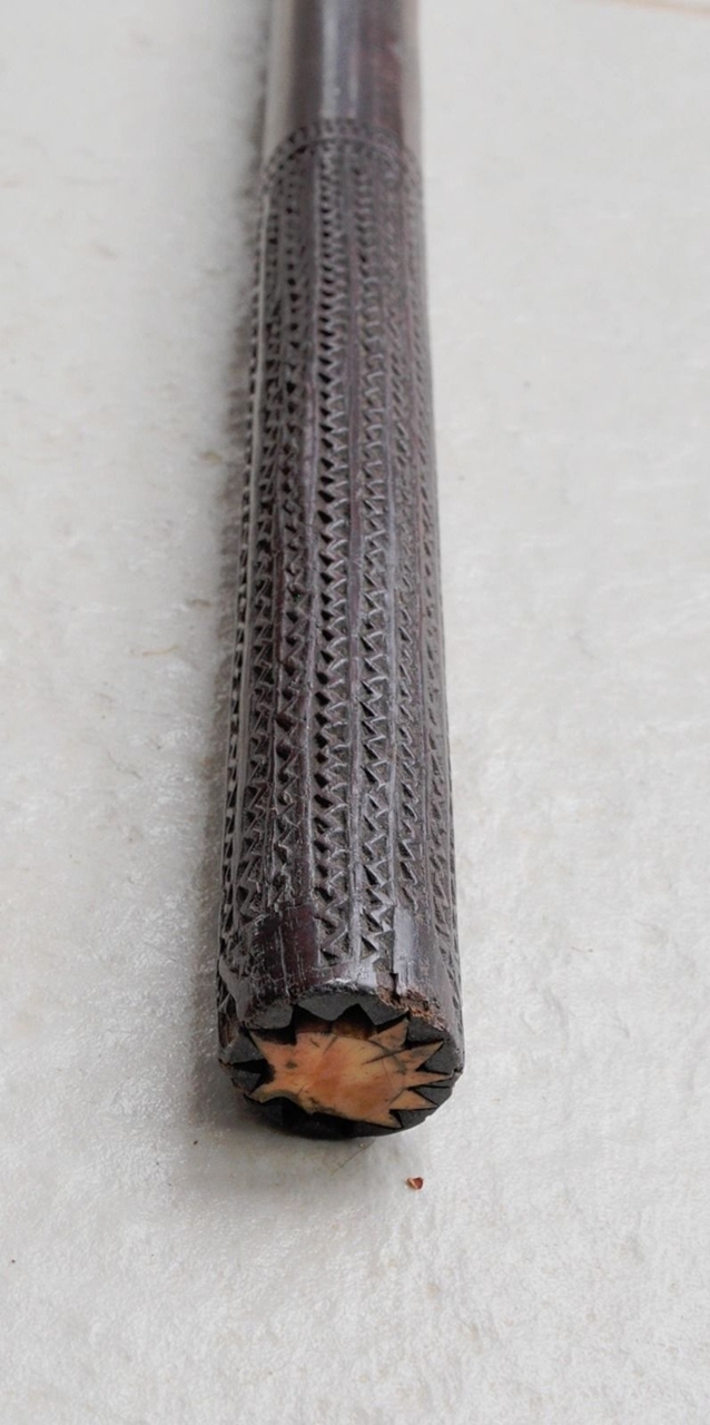

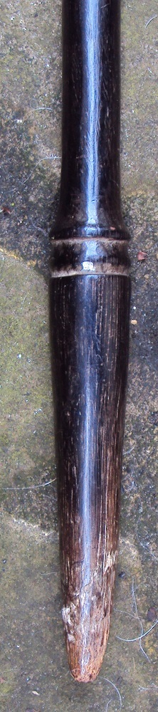

Took a long time but got there in the end. Went to bed left what I thought was a rather low bid, woke up in the morning and bingo it is mine . 112cm long and a piece of marine? ivory? or shell inlay to boot. Just got to get here and pay quite a bit of TAX coming from outside the EU.
Looks a good old club, nice with the ivory inlay. Well done !
Old 1st March 2016, 06:23 PM   #20
A VERY NICE FIJI POLE CLUB WITH GOOD PATINA AND WEAR THE IVORY SUN DISK BEING THE CHERRY ON TOP OR BOTTOM IN THIS CASE.
