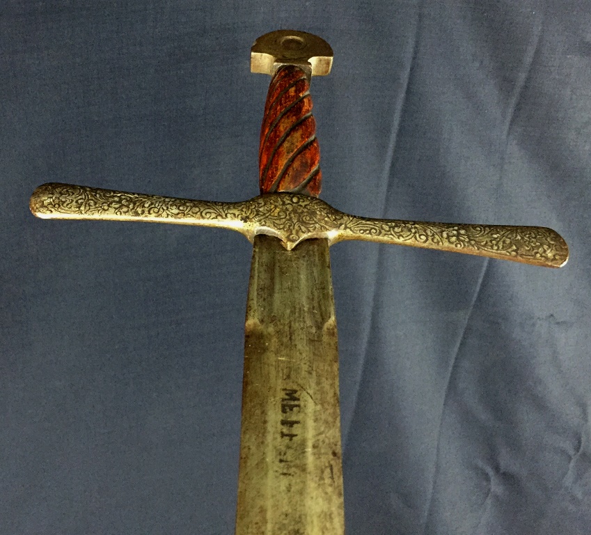

This sword is without doubt with a later pommel and grip .
I Believe that the spatulate quillons are from periode .

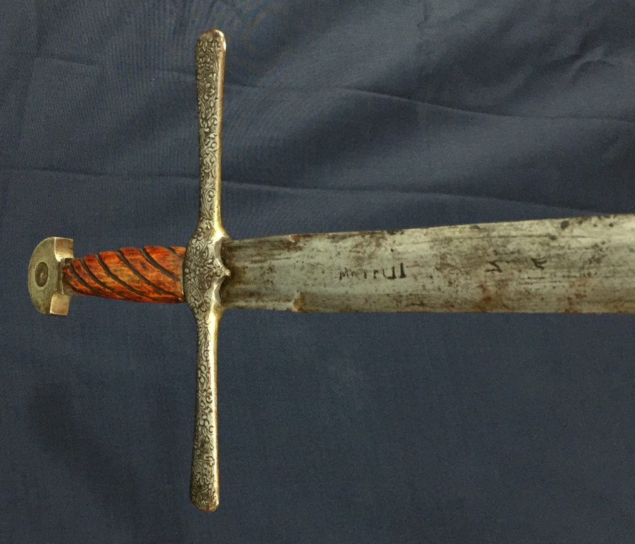

I ‘m wondering how could be classified this sword ,also I have never seen similar pommel.
Is it an existing type or pure fantasy ?
Also on the blade the inscription ME FECIT SALINGEN with what appear to be a trace of Passau wolf and not SOLINGEN.
I found a link for a similar inscription but unfortunately this link is not working anymore.
https://www.rijksmuseum.nl/nl/collectie/NG-1647
Zwaard met opschrift 1414 ME FECIT SALINGEN zwaard (wapen), l 106,1cm. Meer objectgegevens.
May be somebody has a explanation about Salingen in place of Solingen / Mistake or different place?
Any comment will be welcome.

This sword seems more of a theatrical or perhaps 'parade' type item, but nicely interpreted as such.
It seems that this particular inscription may derive from blades which likely were either from a Solingen maker working in Netherlands or in a shop producing them similarly in those regions
The link that Ibrahiim has posted showing a 'sword' which has been assembled far less deftly in such theatrical style has a genuine old blade in excavated condition as its key feature.
The use of '1414' and the running wolf are simply spurious representations of popular markings used on many Solingen blades.
The so called 'Passau' wolf was one of the most widely duplicated forms and was actually more aligned with Solingen blades where it was heavily used.
Its application as an indicator of quality became well known as it became diffused into other centers across Europe and into other cultural spheres

it is a composite sword but certainly no theater or parade sword.
Guillons, flat in the plan of the blade and spatulate in shape occur in the first half of the 17th century. see attachment of a Solingen 1 1/2 sword.
the engraving of the cross is very characteristic for the first half of the 17th century, several hilts with this style of engraving are known to me.
The blade in geometry seems to me early 17th century and seems to fit the guard like a hand in a glove, which may imply that the guard for is made
for the blade.
The pommel is earlier and belongs to a type of 1 1/2 half sword which appeared briefly in the 16th century. it certainly does not belong to the guard. see attachment for this type of sword, and for a similar pommel .
I will post an example of such a 16thC sword with this specific pommel later.
So basically you have an early 17thC sword, with an older pommel ( grip is a later replacement) ......not bad.
best,
Jasper

mmm..................all 17th century pommels are possible but a (flattened in the plan of the blade) globular or reversed egg-shaped pommel engraved as the guard would look nice.
pommel types such as in http://www.vikingsword.com/vb/showthread.php?t=17320
mefecit salingen= Solingen made me.
I cannot enter my books but in wapenhandelinghe by jacop de gheyn is a sword of your type if I remember well.

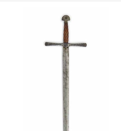

this is an example of the 16th century sword that belongs to your pommel, the same type of drawing of Hans Doering in post # 5
the blade with two short and one long Fullers characterizes several one+ a half handers in the 16th century.
