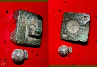

Old 13th June 2009, 04:07 PM   #6
ward
Join Date: Feb 2006
Posts: 637
I would have some difficulty with some of the dating of these objects unless you had some provenance or the items were found with associated dated pieces. Other cultures in the world used realitively identical items much later is history. I have included some items I have in my collection,I would be hard pressed to date any of mine to the 16th century. The stone one came out of small town in tefrout, morocco, the gang mould came out of afghanistan and the single bullet mould came out of albania. They all could have been traded to these areas but in these cases I feel it is unlikely.
