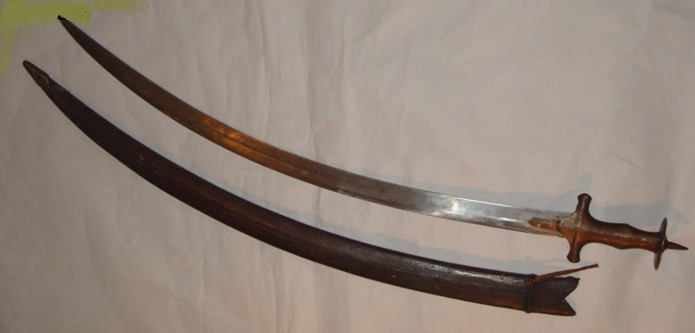

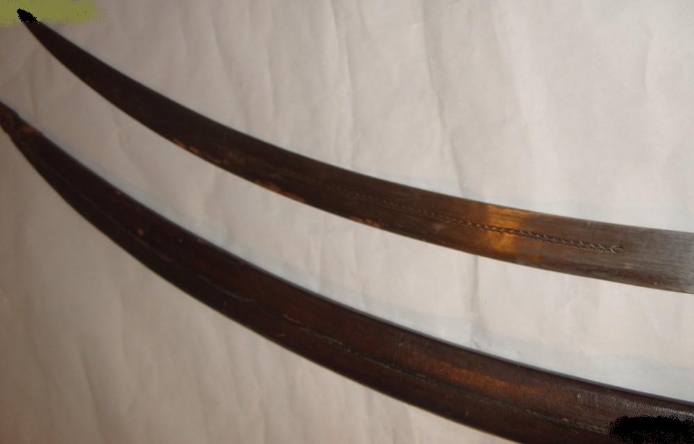

Hello.Dear friends, please help me and me about this sword.I'd like to know which countries belong and how old it is.Thank you very much.

Your sword is an Indian tulwar, it would be considered as an "Indo-Persian" sword instead of an "Oriental" sword. Maybe another forum member can add some additional information such as age or region.

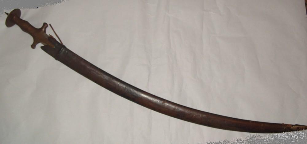

This tulwar is purely Indian, and looks to be an arsenal sword of the early 20th century. Good point regarding attribution there, Estcrh. The term "Oriental" has long since been superseded. We can even take it a step further:

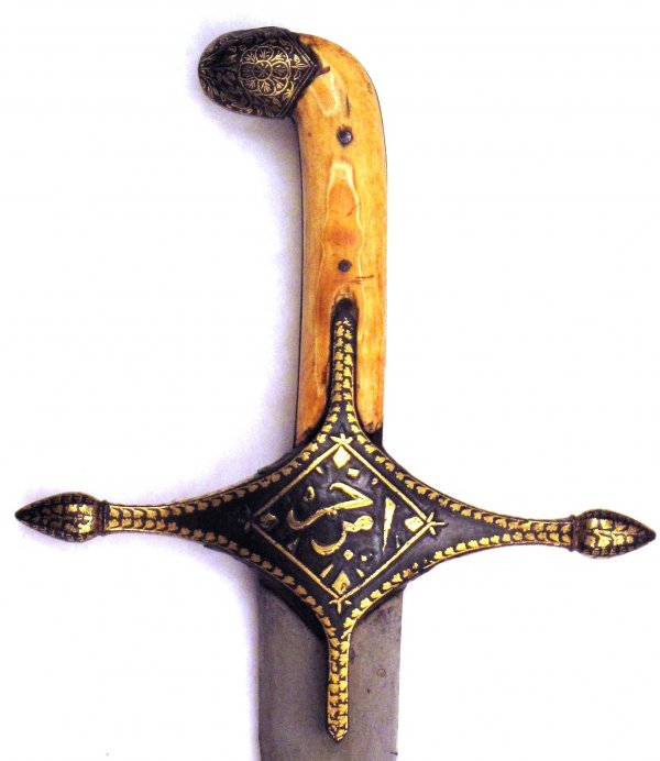

In the 19th century, Wilbrahim Egerton, among others, used the term Indo-Persian to refer to weapons made in India, primarily though not exclusively by the Mughals, which to a greater or lesser extent were based on Persian prototypes. These may be precise copies of Persian work but for a particular Mughal characteristic, or distinctly Indian but showing a degree of Persian influence. A good example of an Indo-Persian sword would be the Mughal shamshir pictured below; it's close in form to the Persian, but displays Mughal characteristics (in the form and scale of the guard and pommel and the type of embellishment found on them.)
Regretably, the term Indo-Persian began to be applied much more generally back in the 1950s, to any weapon which might be Persian or Indian, Afghan, Ottoman or even Caucasian, and so it remains to the present. I mention this because I think most forum members will agree that specificity and clarity in terminology are central to the scientific discourse.

I was told that the sword is a sword africaine.Ma question is: In Africa were also produced and swords (tulwar)? I asked this question because they are very comfuz, after the owner told me said this is an African sword. Thank You.

definitely NOT african.
the brits of course had colonial ties with india, pakistan, afghanistan and africa, and it's possible an official or military person collected it in india, carried it to africa and it remained there after he died or left for elsewhere, and was aquired by an african family who treasured it and passed it down until it's story was forgotten.

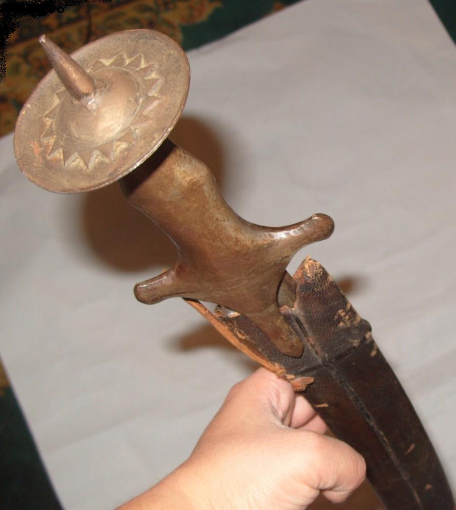

The hilt is new, but the blade could be an old one.
I have lightened and sharpened the picture a bit.

I do not believe that the handle is new, what evidence you have in saying this it ????

Try to have a searc of 'Tulwars'.
You will see a lot and you will also see the different hilts.

I would agree with Jens ( pretty safe way out:-)
The "newness" of the handle is its amorphous form, rather slapdash minimalistic adherence to the classical form(s), omission of any details giving it artistic character. Regulation arsenal pattern, mass-produced to arm a multitude of men at the lowest expence possible.

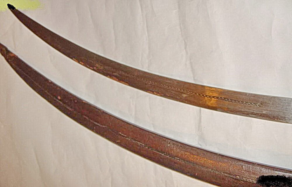

The blade is a different kettle of fish. It can be also new, or it can be old and even valuable. But here you need to use a lot of oil, steel wool, effort, panting and risk multiple abrasions. That is what we all do, so join the club:-)

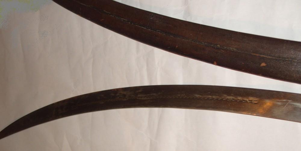

Can you take a better picture of the blade decoration - close up, and sharp?
Do it in daylight, outside when it is clouded.
